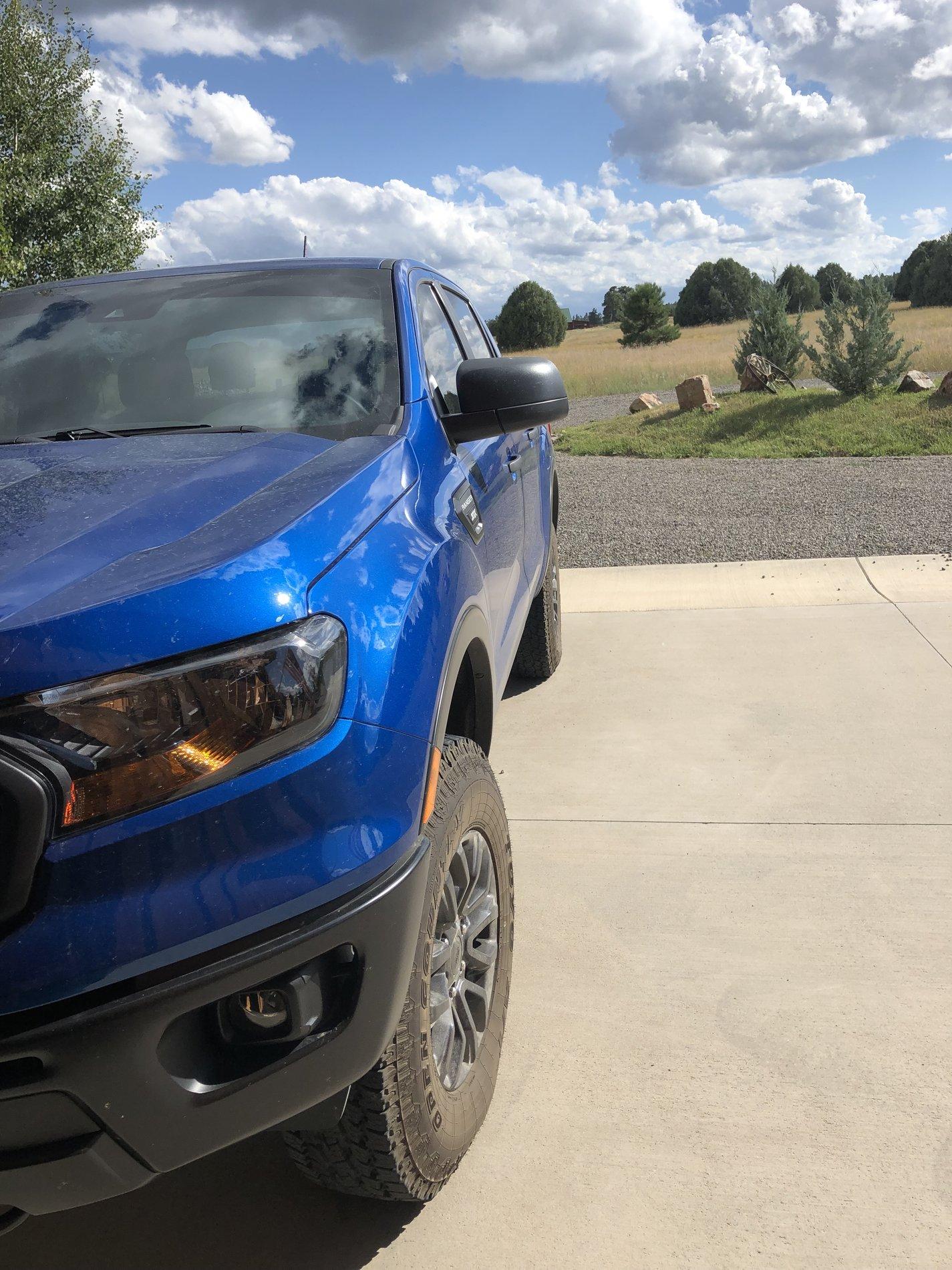

Do you have a head in shot of the tires on the truck. Wondering how they look width wise.
Perfect for the snow out here. Plus I don't like a wide tire. Old fart syndrome maybe... These were taken early September- there's a foot and a half of snow on the ground now.

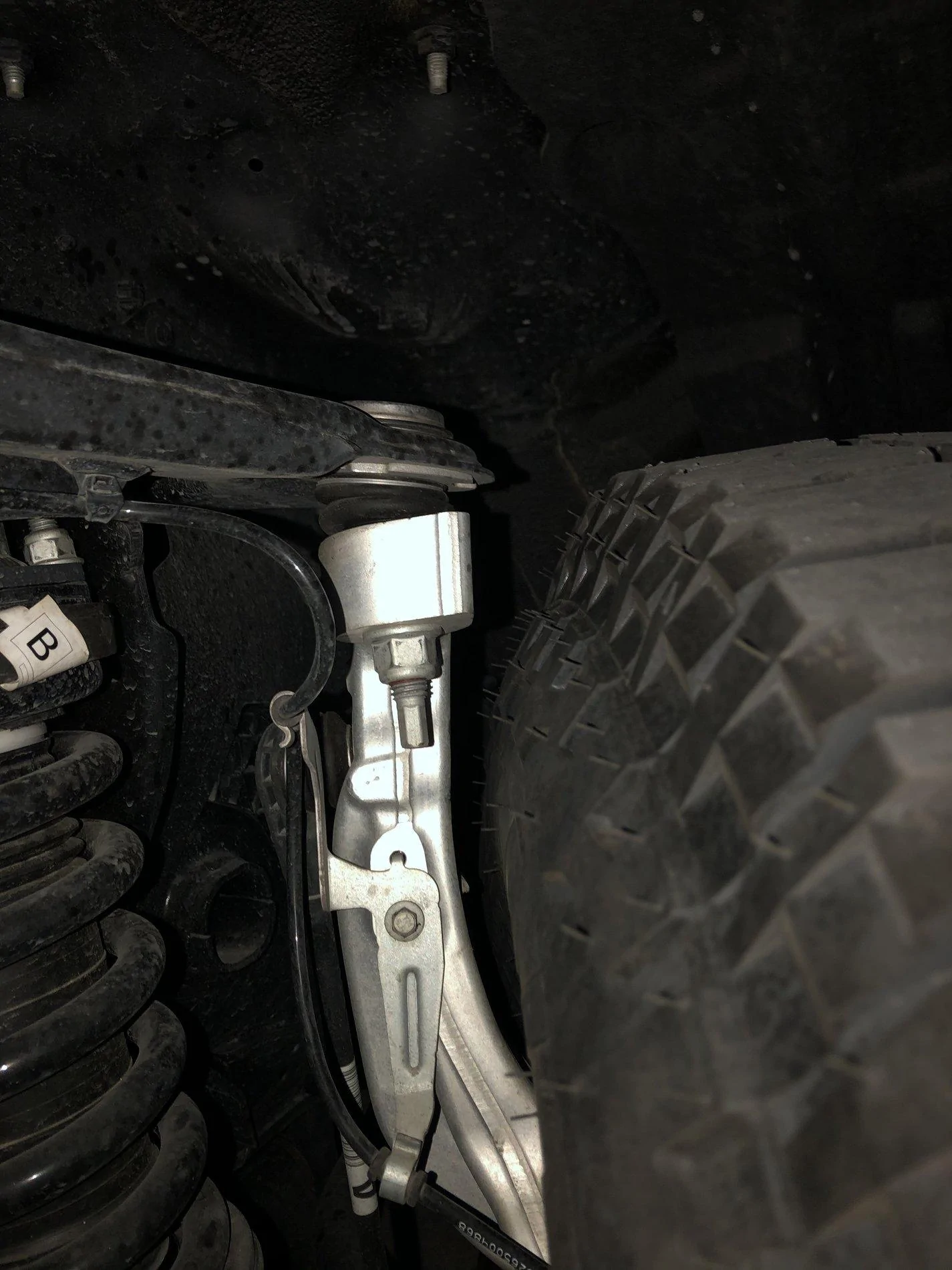

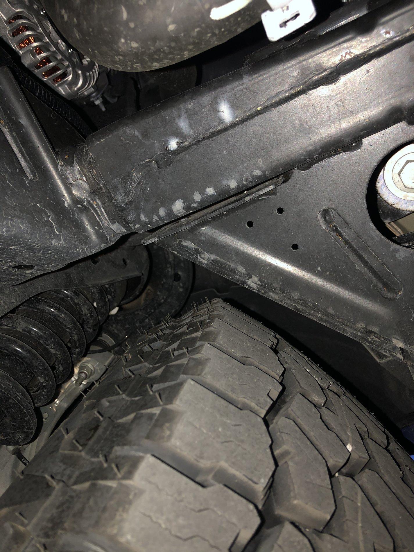

JoJo, Everything is intact (crash bars, plastic, etc.) and looks like your pics only filthy. Below is a shot of what I think you were looking for. Truck has seen some pretty rough country over the summer- no issues whatsoever.

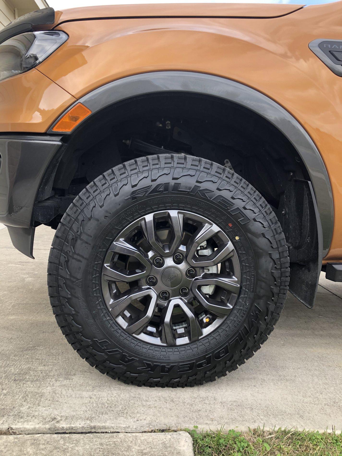

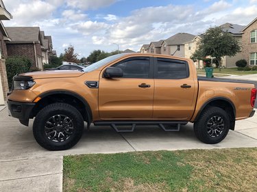

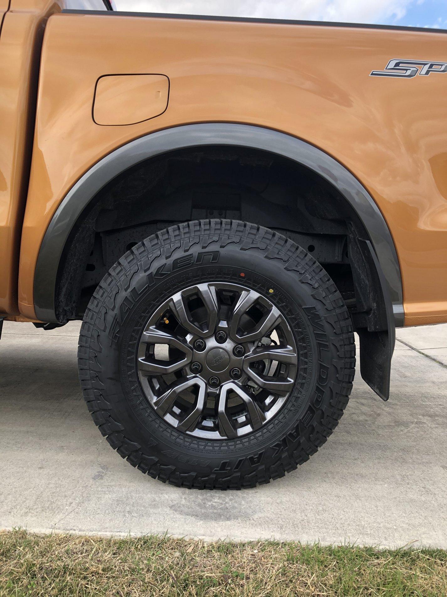

Just wanted to say in a nutshell; thanks to Gsaff I ended up going with falken wildpeaks at3w 255/80r17 and couldn't be happier. At least half an inch space at any revolution. Outside of maxtrac 2.5inch level. No other tire/wheel mods, trimming or rubbing. One day in and I don't notice any negative ride difference, but still early.
