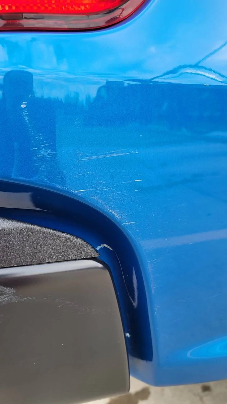

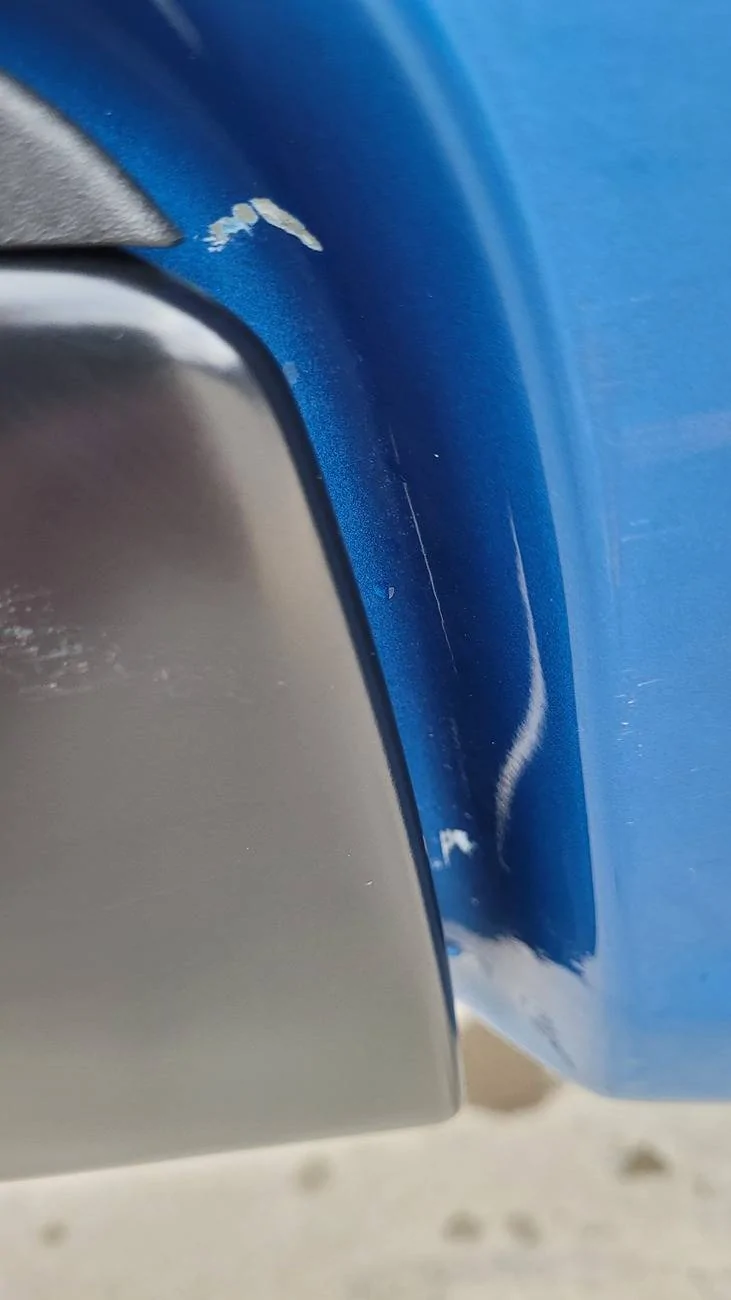

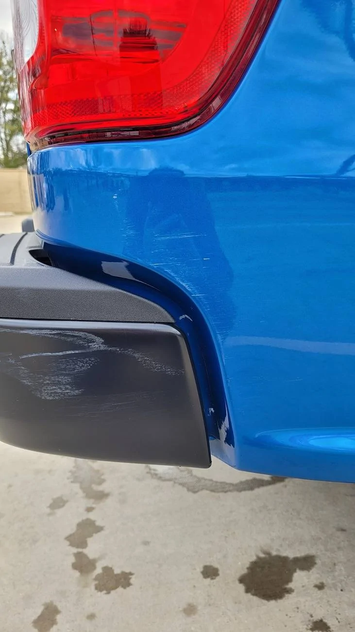

They have to bondp those large chips where the bumper made contact with the body. Spot prime, blend the color which can be hard with blues, and clear the whole panel. Not to mention some bumper supports could need replacement too. Bumper clearly defected enough to make contact with the body. Seems like a reasonable estimate of notba touch high.

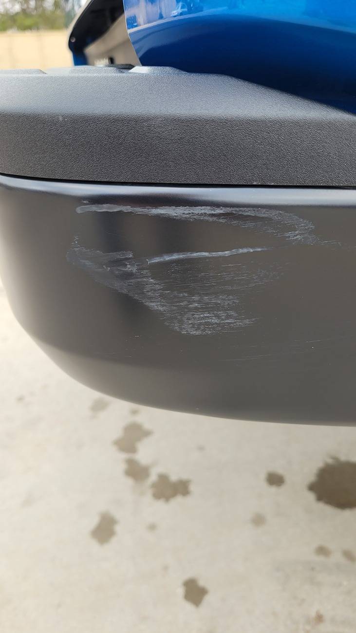

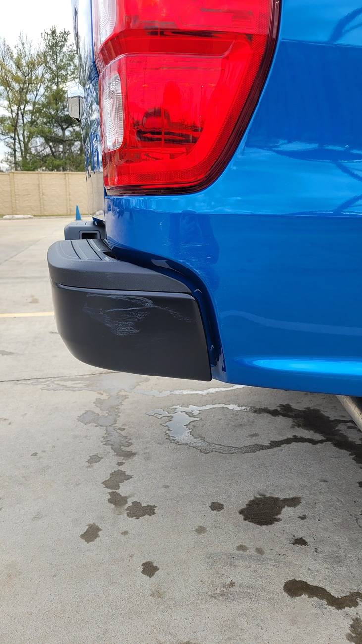

So it seems as though Blue Dream had a little unwanted touching. The secretary at my work backed out of her parking spot, her spot I was unfortunately parked next too, and skimmed my beautiful machine with her shitbox Nissan Frontier. She must have just barely barely kissed it. No actual disrespect to Frontier owners but hers isn't well kept. Mine is 29 months old at this point and because of my meticulous OCD I'm able to detail it so it looks factory fresh still to this day and thus far I haven't had even a minor door ding or anything like that. At all. So this kind of bums me out. Not to mention fanatical maintenance with only premium fluids, replacement parts, etc. I LOVE my truck.
Anyway, see the pictures and guess what the estimate came out to be. It's extremely minor. Nothing is dented or bent (thank God) but the amount for the repair estimate is mind boggling.
Let me know what you all think and I'll reveal the price later. As an aside, if anyone has any ideas to avoid such a ridiculously high repair bill, I'm all ears. But she's paying, so there is that. And I cannot stand the idea that a claim for something so insignificant would ding me on Carfax (no pun intended). Thanks for playing.

It’s leave it or buy a new bumper imo…
Also how much flex does the outside corner of the bumper take since it scratches the inside part…sheesh…
It would be most likely between 700-1000 depending on the shop you use.. which reiterates… if you’ve had your eye on a new rear high clearance or off road rear bumper you might aswell just go that route.. unless you want to keep the original look well then yeah you’d be lucky to get it repaired under 700.
