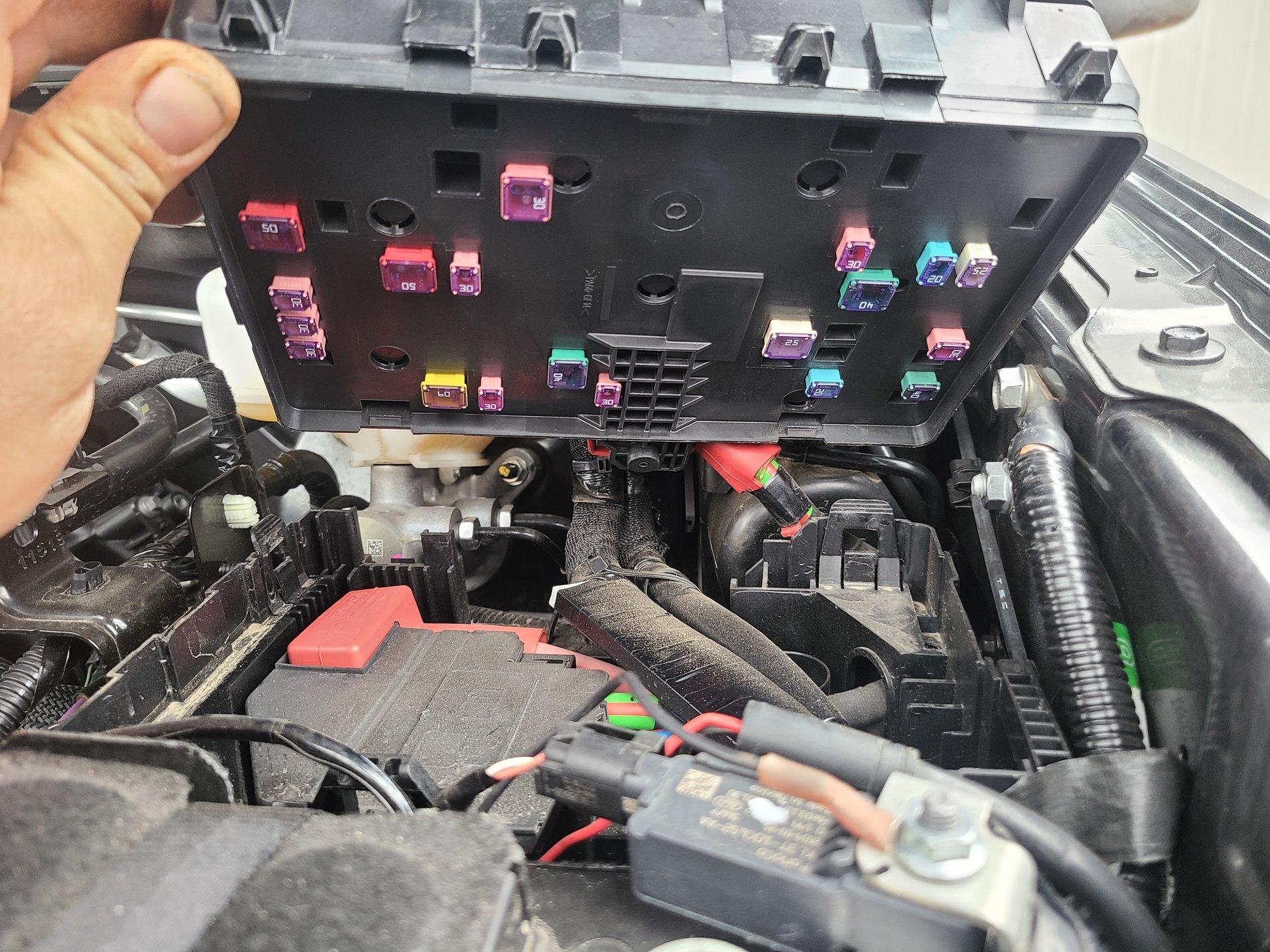

Looked in the upper and lower fuse box and i found the RH turn / stop #63 and LH turn / stop #56 dont have connections in the lower juction box (but they work fine). But the Trail Park Lamps fuse #71 is there and good, but still no park lights.
