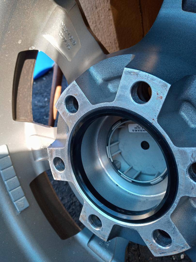

I received the rings and installed them a perfect fit, i could tell the difference how they mounted on the hubs they where centered and not relying on the studs to hang on.
I haven't been able to do a highway run, I will on Monday and report back hopefully all will be ok.

UPDATE;
I did a highway trip this week after I installed the rings pictured above and am happy with the results that the vibration is gone,
so this issue is resolved and thanks to all who responded with tips & experiences on this subject.
