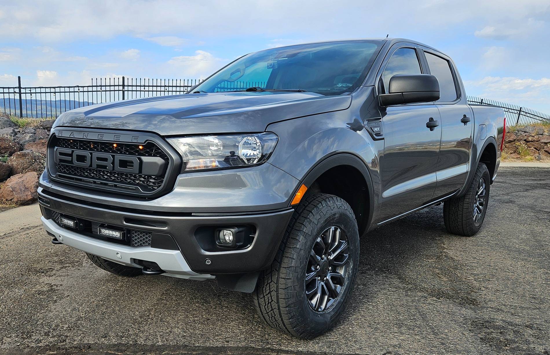

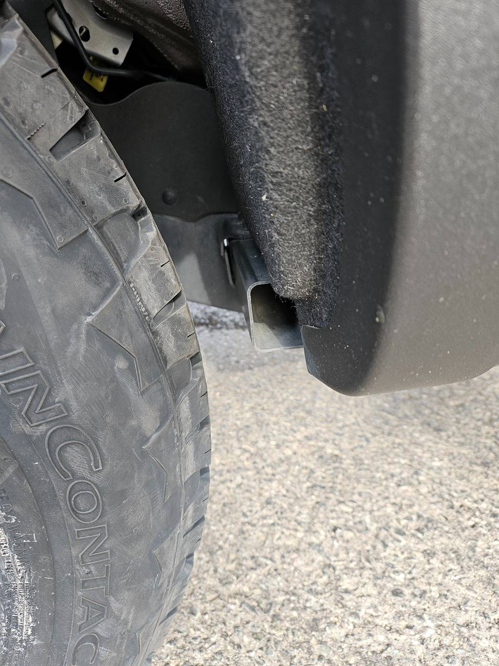

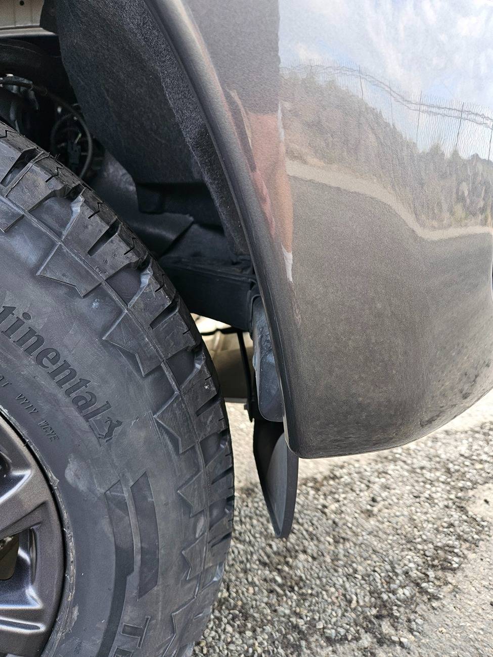

I went up .8" with Eibachs and I had 4 new Continental Terrain Contact AT's in 265/70x17 put on. About 1/2" wider than the stock Hankook 265/65R17 and a good inch taller. Nothing hits.

Thanks for the advice, looks good.
