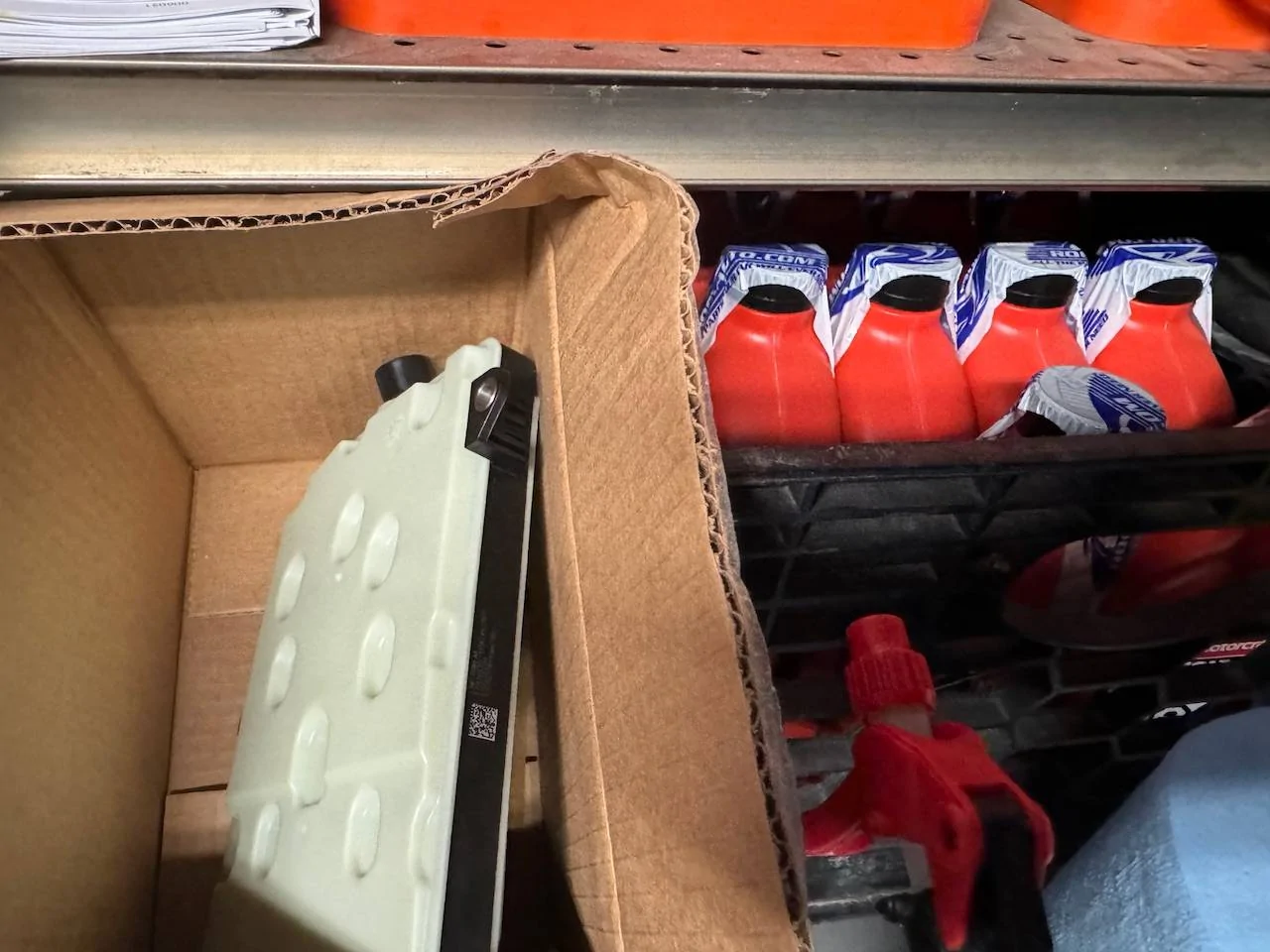

Well its not really an emergency buuut it does change things up. I had today planned to do an oil change. Seen the Napa deal on trans fluid last week and ordered 12 quarts. Came in yesterday PERFECT!! "I will add that to my Saturday maintenance day.
I'm up at 5am and get on the O'Reilly website to order the filter for pickup. They sell motorcraft and a block away.... Not in stock. Closest one that has it is a 30min trip. Okay np..ill look up Auto Zone... Not in stock..hmmm..how about Advance Auto?... Not in stock. Well guess I'll wait till 7am and call the dealer.
It's in stock and it's $95 for just the filter..... Nooo thanks.
So I call O'Reilly as a last ditch effort in hopes maybe the website is wrong. Gentleman on the phone says "can have it here by 12". So not on the time line I had planned but it's better then a 1hr round trip in traffic. I'll have a motorcraft filter and a new seal for $60 and that's a win for me.
Sooo.. Nothing really informative. Just sharing my early morning transmission filter search.

Just curious, how many miles were on your truck when you did the filter and fluid? How dirty was the fluid, and did it drive any different after the change?
I have 67k. The fluid was pretty dark but that's not always an indication it's bad. The filter material was a dark gray. The magnets had shavings on it but nothing out the ordinary.
The trans is shifting better. I am running the firm shift 87 livernois tune and at low speeds it would lurch forward after each shift. I never had issues with gear searching. It did have a tendency to hold a gear for longer then what I thought it should. I just assumed those two situations were the nature of the tune. Driving it for a couple hours yesterday, the shift is still firm but not abrupt. It doesn't lurch forward after a shift. It's also not holding a gear as long.
There is an improvement but I'd like to give it some time to see if any of the old tendencies come back. I have not dumped my old fluid yet. I'll be going to NAPA this week to pick up an oil analysis kit to get it tested. That should tell me if the fluid had any left.
