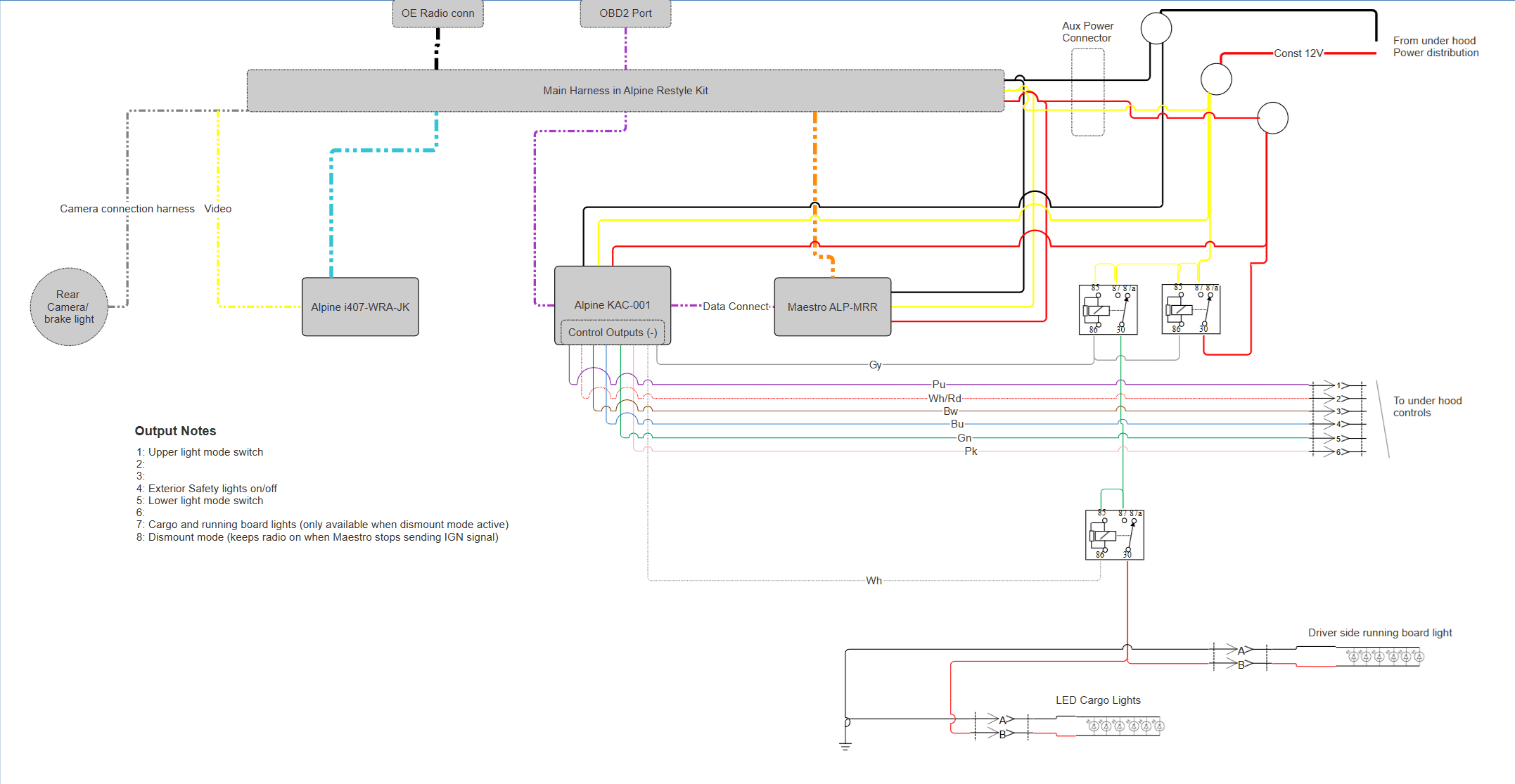

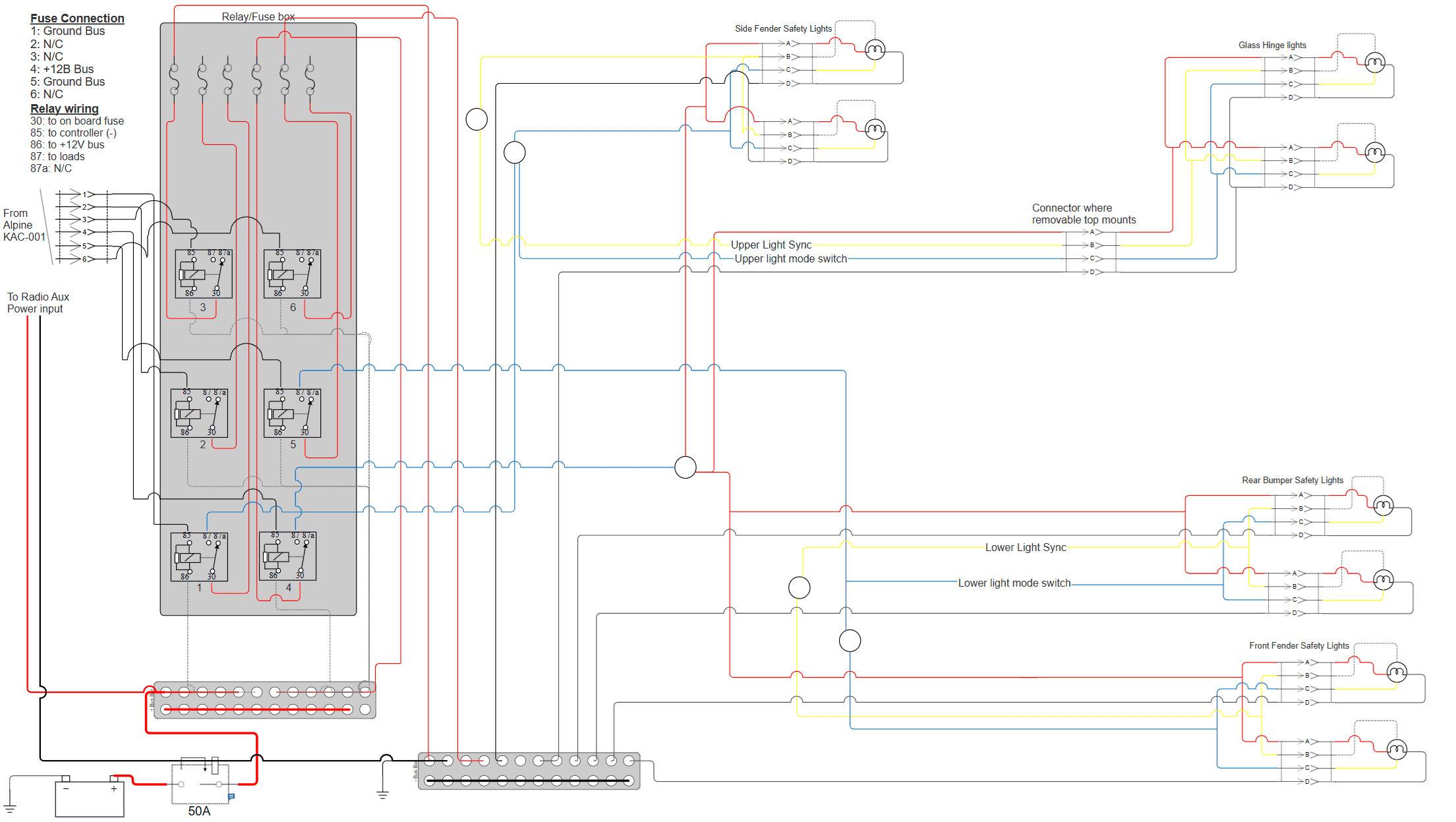

Sadly, not for the Ranger, but for my wife's RHD Postal Jeep that is finally getting a radio update, and since I'm getting her the Alpine KAC-001 accessory controller with it, getting all the safety lights wired for control with that controller. And she'll be able to set different strobe patterns for the upper (side fenders/old 3rd mount light) and lower (front fenders and back bumper) separately from the radio interface. I still have 2 more grounded output controls not going to the relay/fuse box. Alpine support states that the ground latched controls disable when the radio turns off though, which is a problem since she'll need the lights going while dismounting to for to the door delivers, so I've got one of the outputs going to a relay on the Batt +12V to supply +12V to the Ign lead while the Jeep is off and the Maestro kills that signal. She'll just need to enable "Dismount Mode" before turning off the Ign and opening the door. And adding the cargo light using the extra LED strip from my bed lighting project. Plan to tackle that this long weekend coming up.
Update: Not going replace 3rd brake light, instead I will use the glass hinge caps. And connected white driver's side and cargo light to same circuit that is only available when dismount mode is enabled. I may still make some other updates so tie that dismount mode into to only work when the parking brake is set, or transmission is in park.
