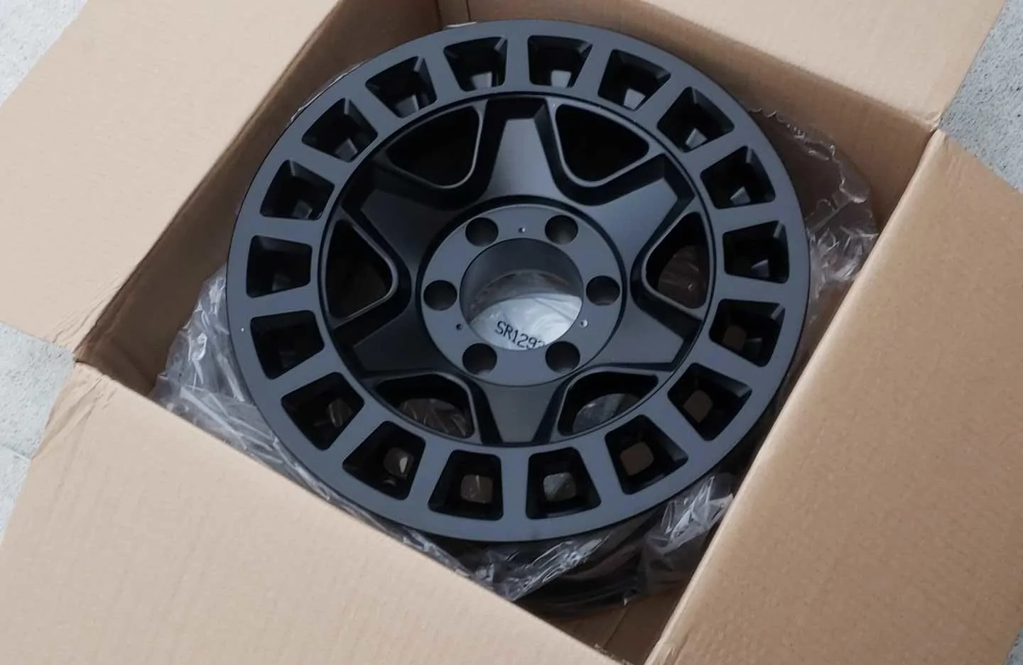

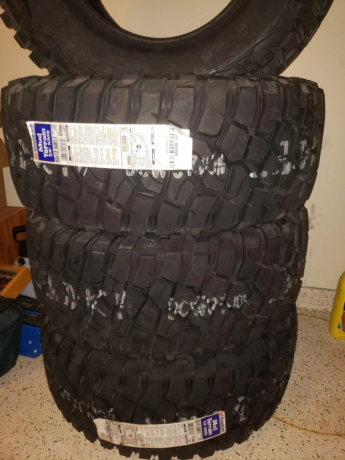

Just received shipment of my new wheels this afternoon.
Black Rhino York
17x9
-12 offset
Still waiting for the extra set of factory TPMS sensors, they should be here Monday. I'm wrapping them in the 33x12.5 KM3's I anxiously bought in December while waiting for the truck. I will keep you guys updated along the way.

Are the TMPS sensors just valve stem ones or do the mount around the wheel?
Another option I did before, is put all the sensors in a closed PVC tube, add a valve stem and pressurize the tube. Throw it behind the back seat.:fistbump:

It works.. Ran a set of 2011 Mustang V6 take off rims and tires on a '06 Explorer for a few years like this, until it neeed tires again, and I could remount the sensors. Just put the pressurized tube with the spare.
Black Rhino York
17x9
-12 offset
Those will be awfully close to fitting, what is your plan to get them to fit if you have clearance issues? The reduced offset is going to help....

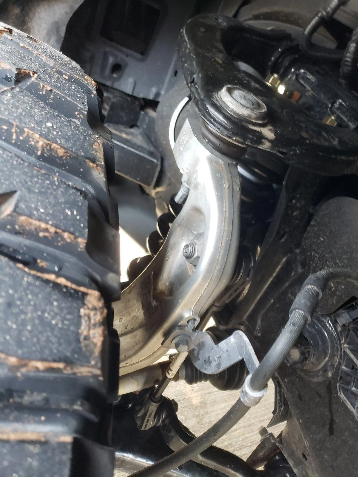

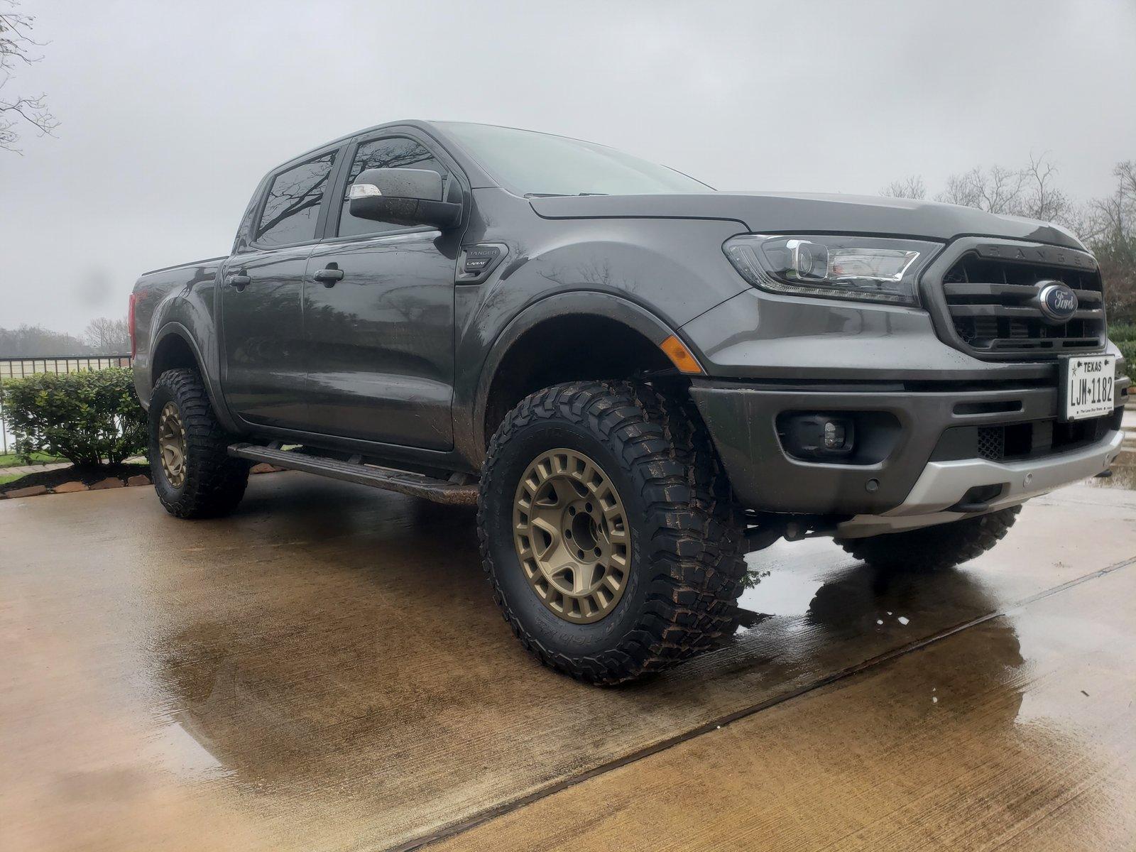

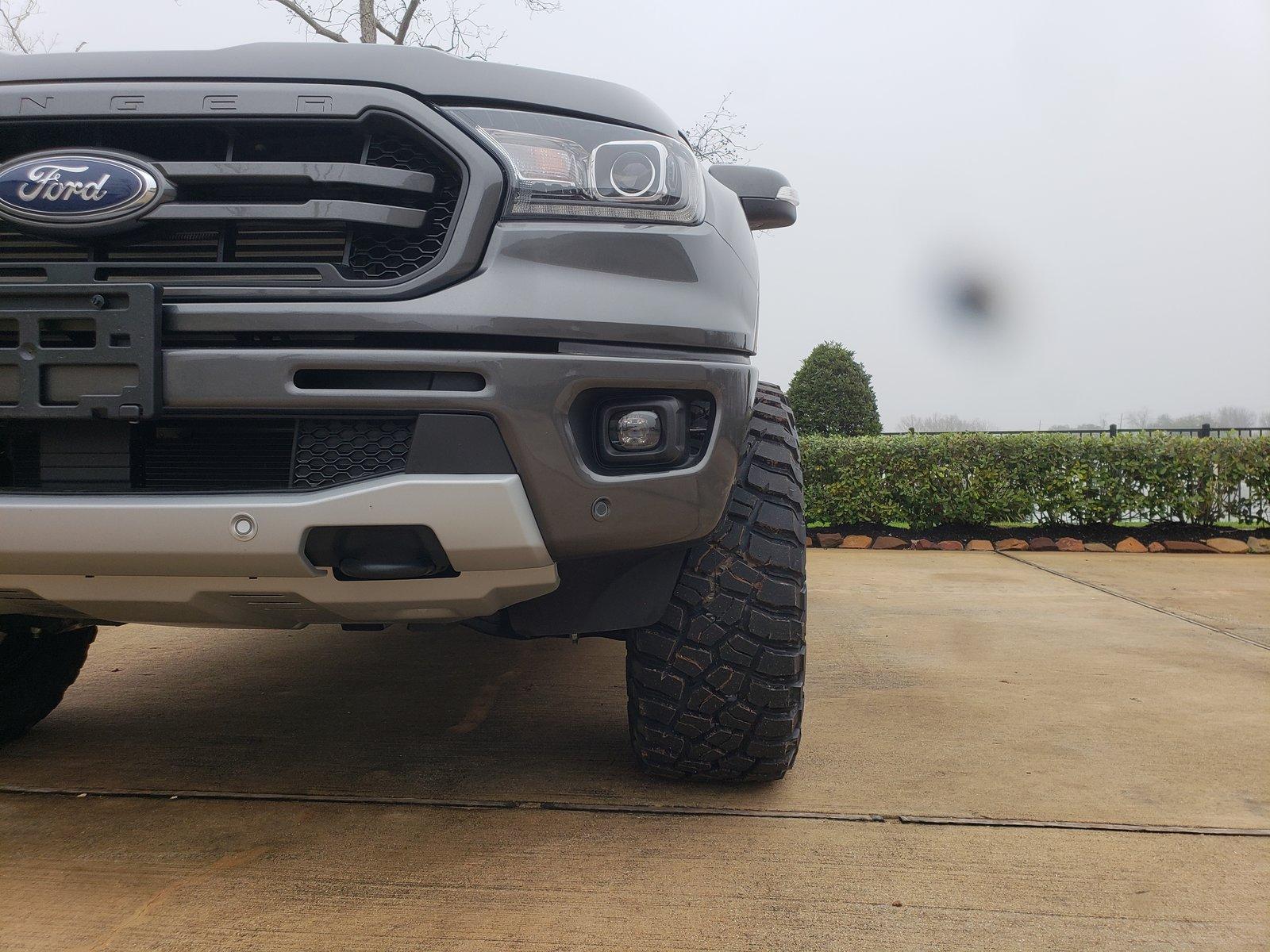

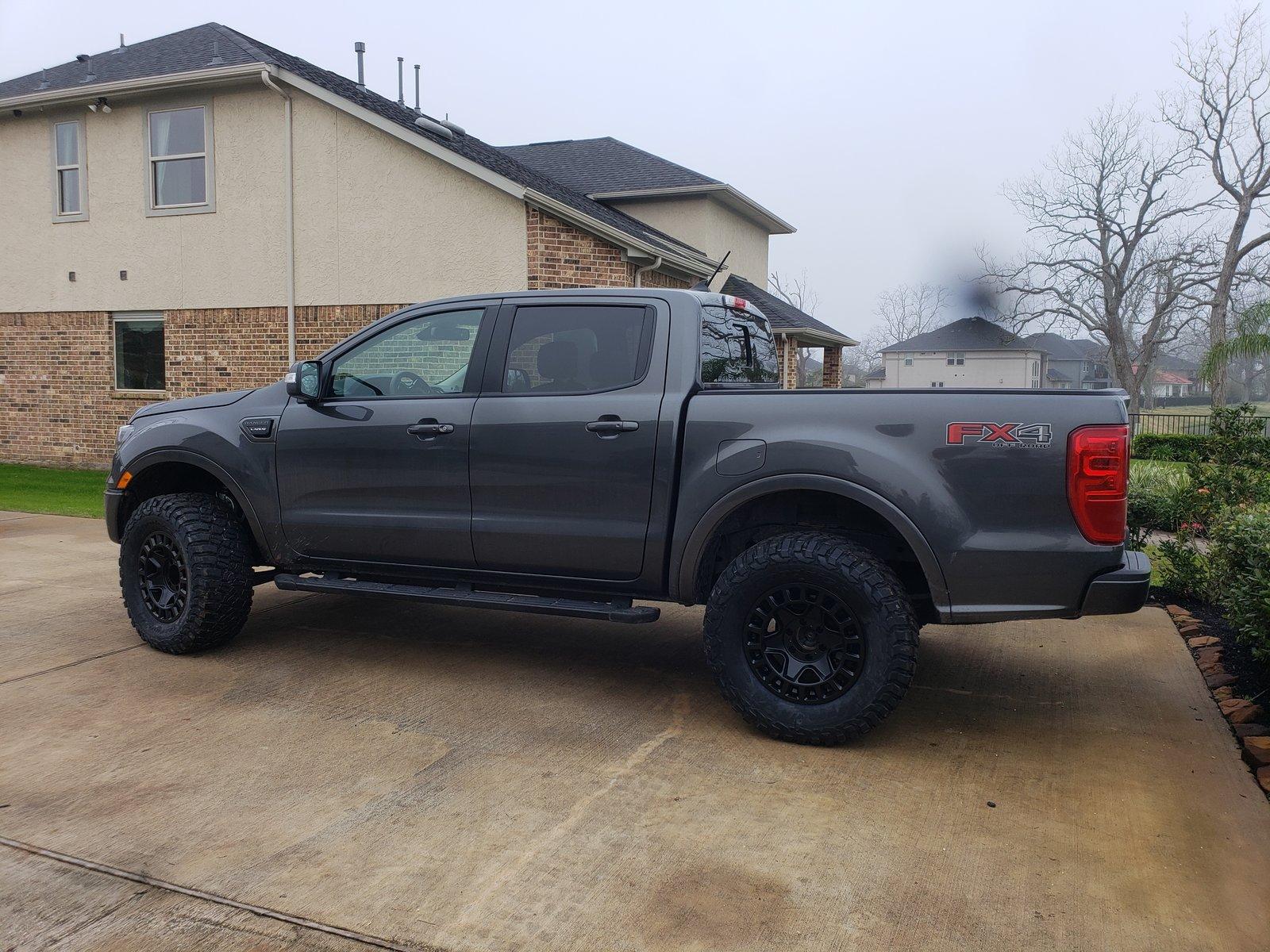

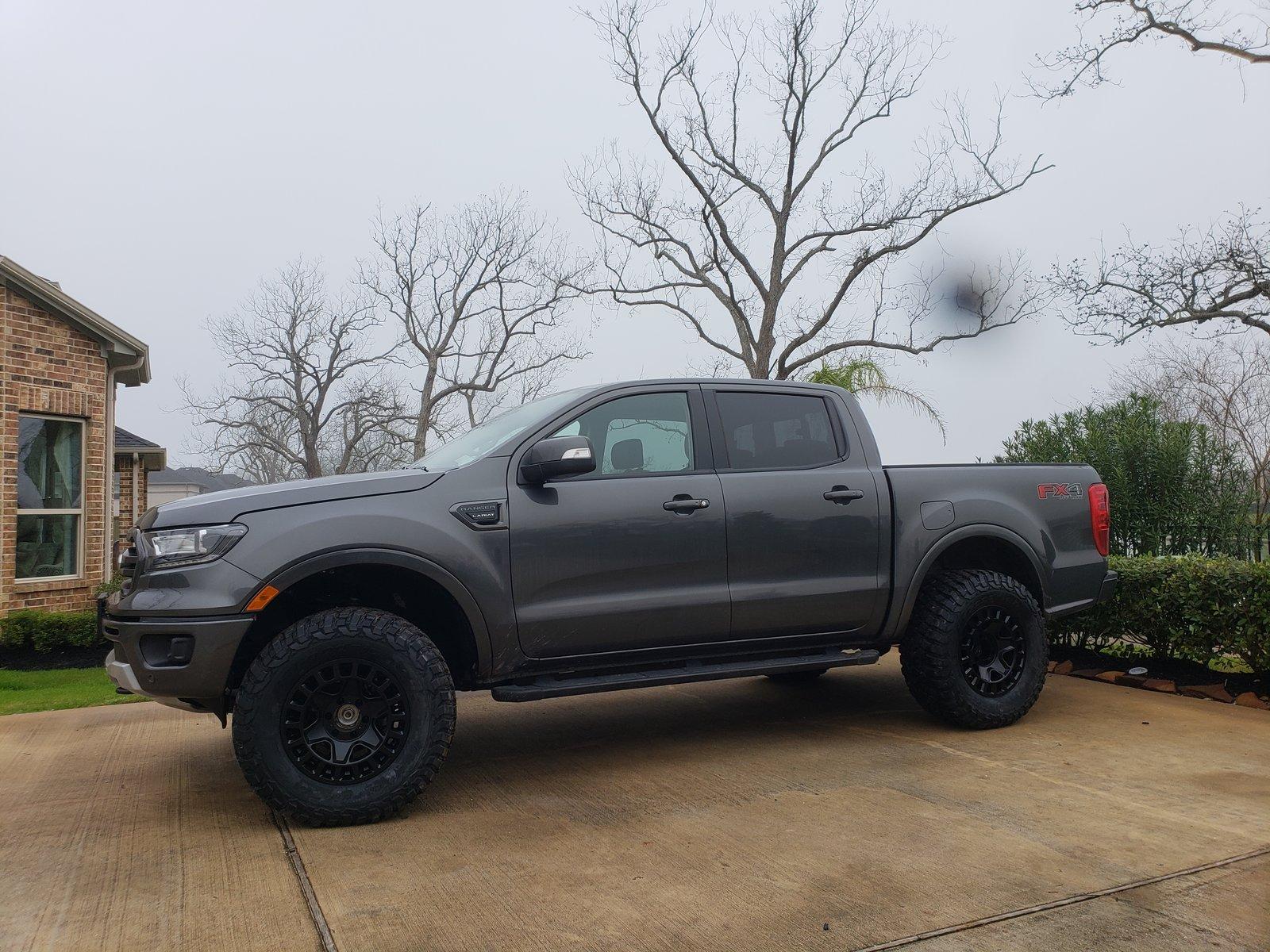

So last night I got the tires mounted and spacers installed (Took the bait on the ones posted from Suspension Specialist.)
Currently, without any body mods I'm rubbing in 3 places.
In drive, I can get 1 1/4 turns in my wheel, and about 1 full turn in reverse
I will update on locations, and modifications after I get into everything this evening.
That looks sick though. What offset on those wheels? Gotta be close to 0.

Curious what the setup would look like with +18mm offset wheels.
You may have better luck taking off your spacers depending on where it rubs. You'll probably still have enough room between the tire and the spindle assembly. I'm guessing it rubs the worst on the outer edge of the front tire on the front wing. That wing is going to need to be removed, the one that bolts to the frame with (2) big bolts.
