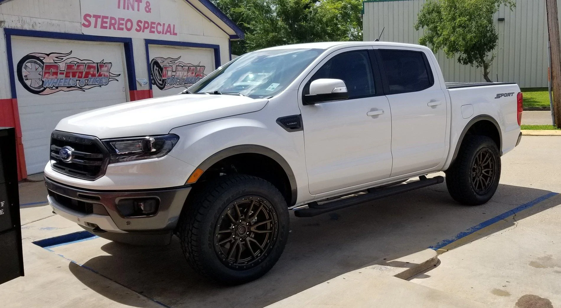

    Hey guys I'm Casey and im in need of a little help. I started making changes with forscan today and I guess I fat fingered the wrong line. And of course I didnt save my as builts like a dummy. Anyways I was wondering if anyone could drop me a copy or.photos of the BCM. Max is a 2x4 Lariat.Any help is greatly appreciated!
