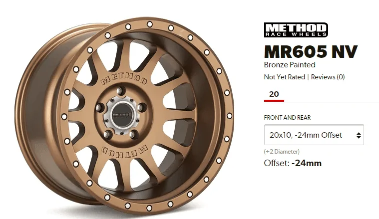

For those considering the Method NV - the MR605 NV Version noted above is part of Method's DISCO Series which are 10 to 12 inches wide with aggressive negative offset.
For more traditional fitments, the MR305 NV is available in 8.5-inch to 9-inch widths and offset ranging from -12mm to +18mm
