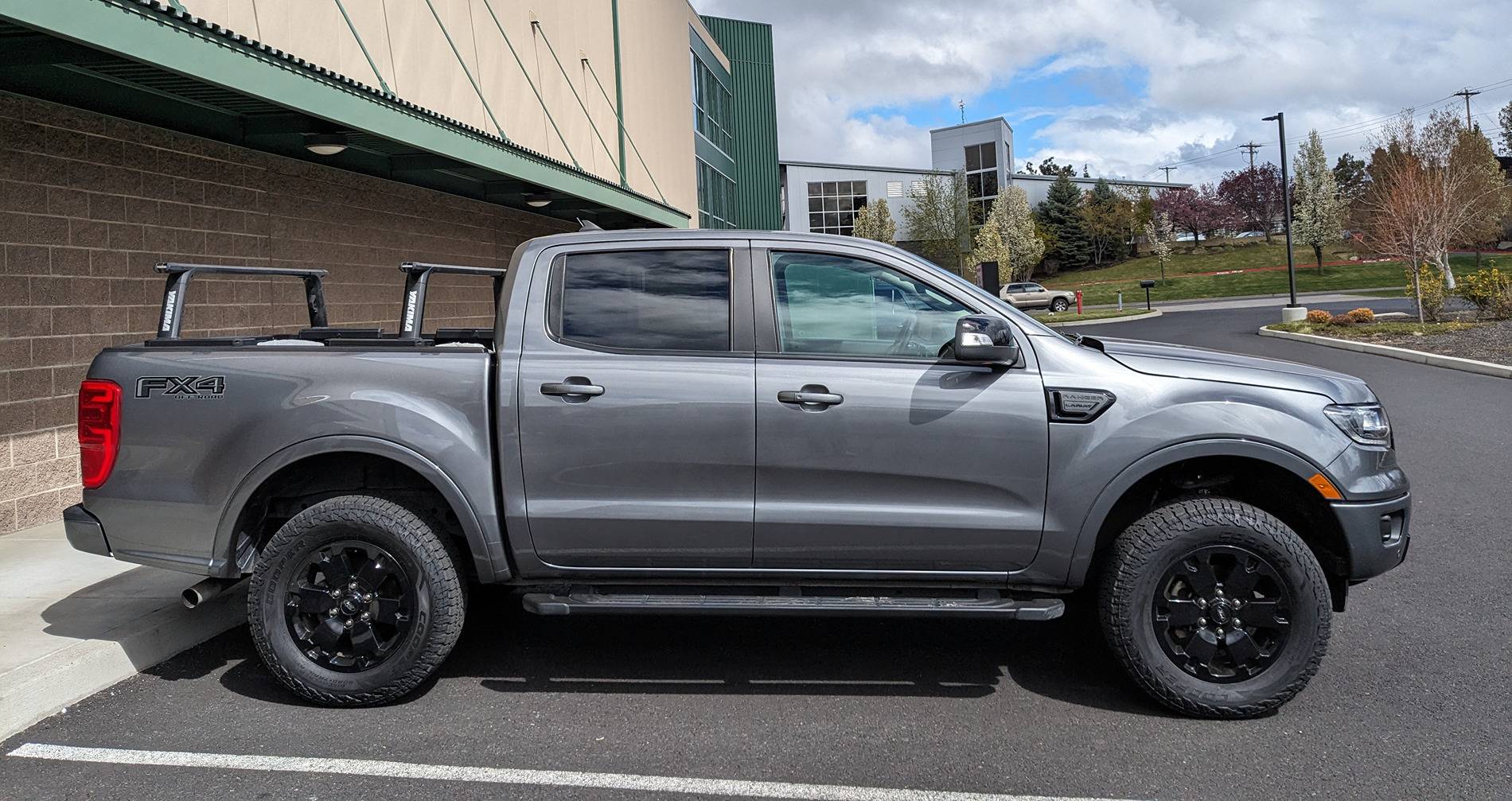

255/70/18 will also fit without any suspension mods. I have that size on mine.

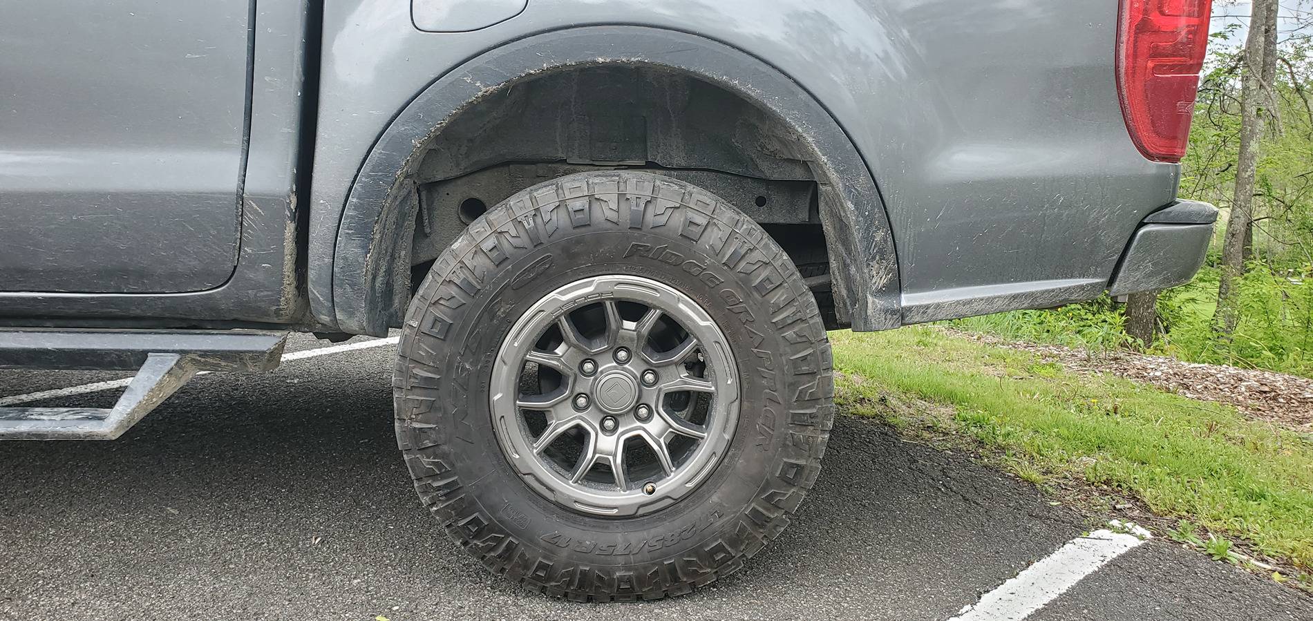

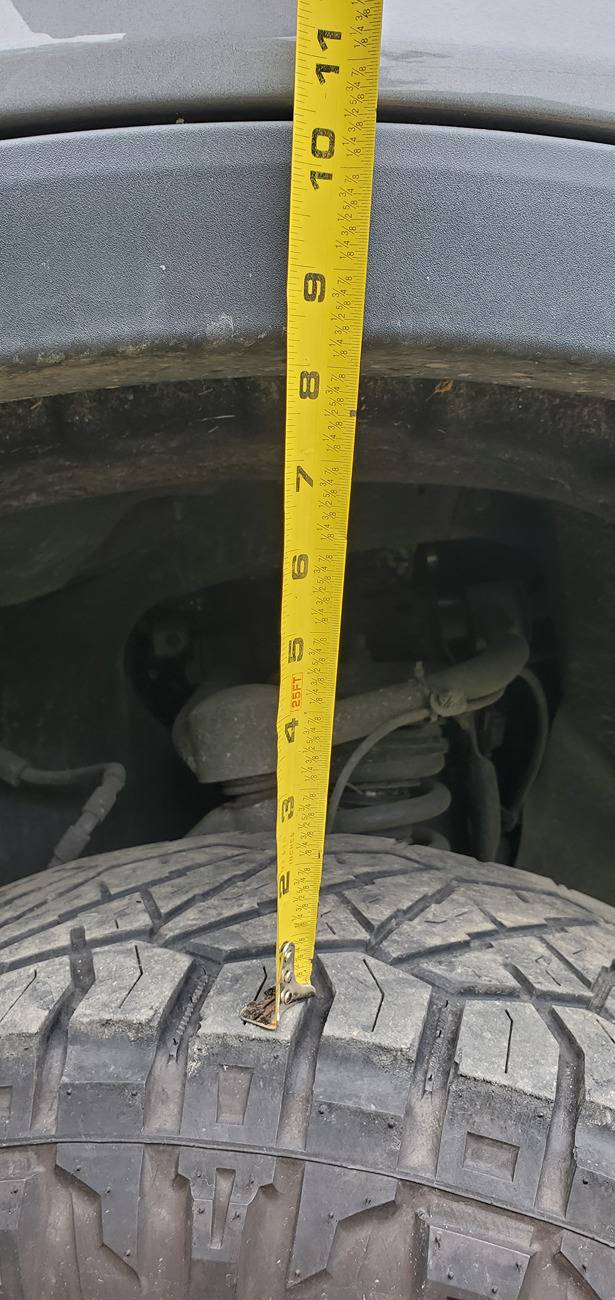

I have 265/65R18 with the Fox 2.0 kit on stock wheels. It looks like a little larger tire could still fit, but beyond the 265/65R18 you are taking a risk of possibly needing to modify crash bars.
