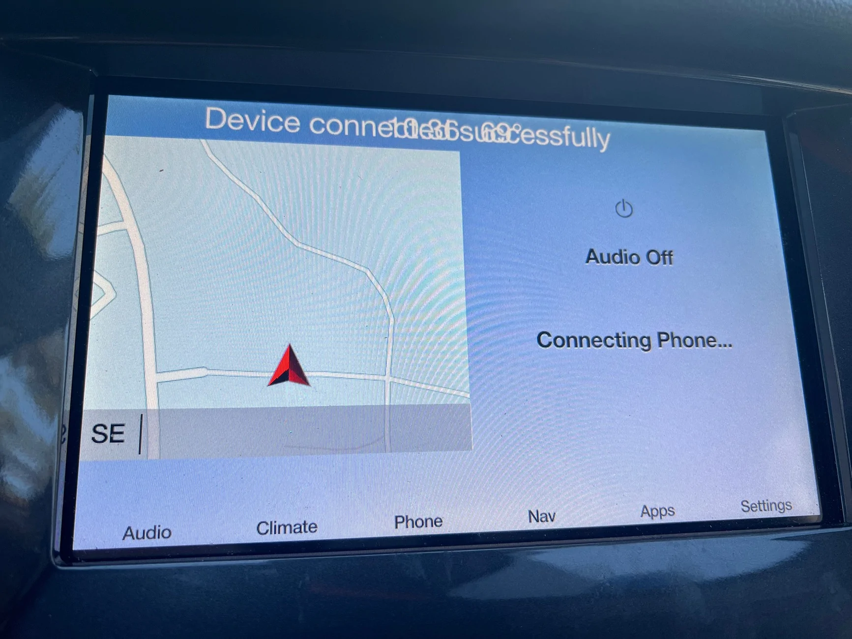

2019 Ranger Lariat. Started today and display is messed up. Can’t access anything but the map. Also, seat heaters were on (not by us). No devices connected but screen says “device connected successfully.” See attached imagery

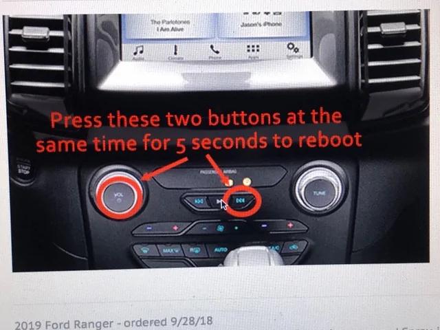

Could be a glitch and you can try pressing the volume and FF buttons together which will reboot the screen. If that doesn't work you can also try disconnecting the battery for a minute and seeing if that helps.
