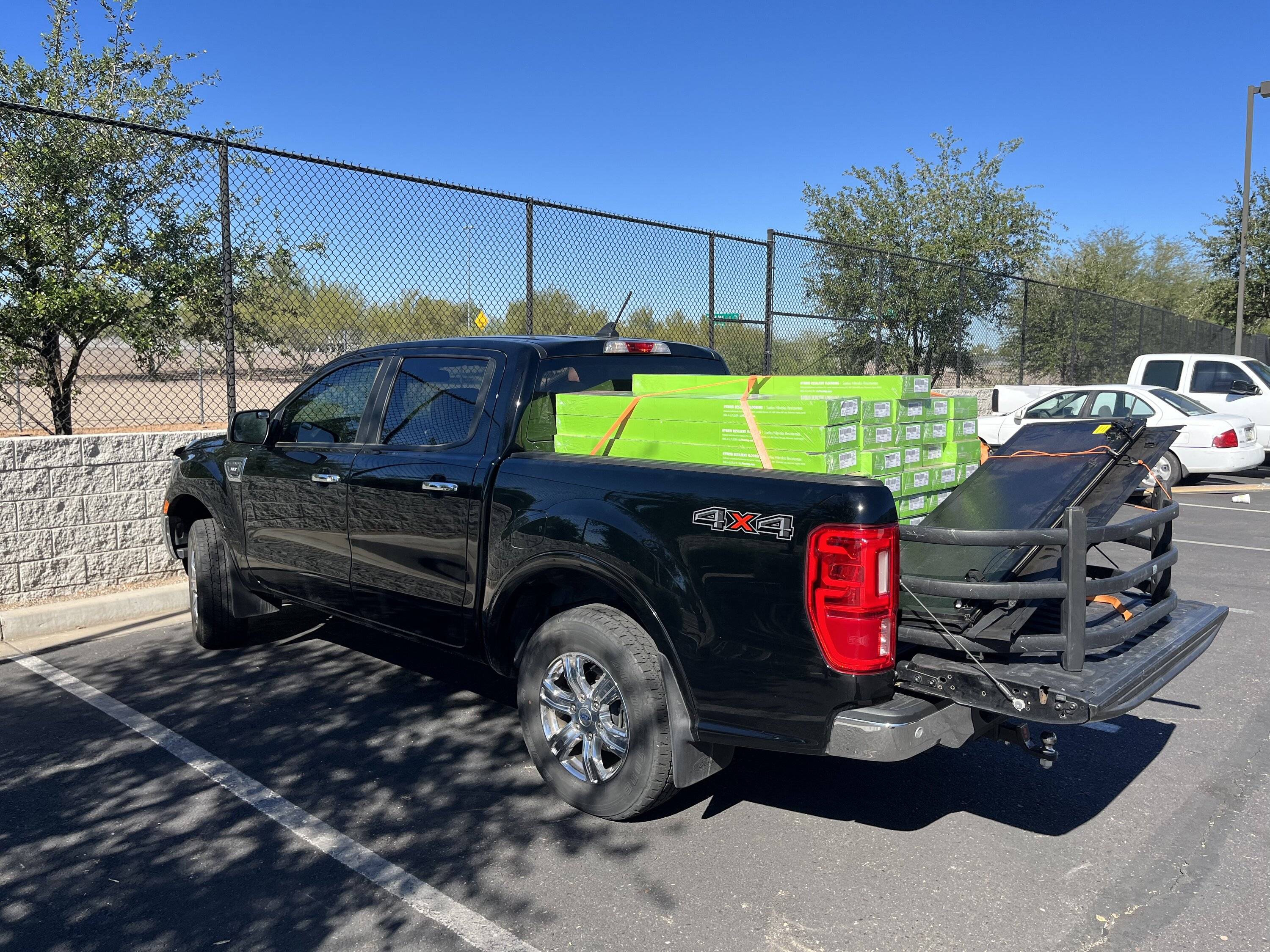

I may gave gotten a bit too much rock last time. Weighted out at 2050lbs.... I would second paying the delivery fee. It handled it good though. Plus me, puts it at 2250. Not to mention whatever else I had in the truck. Woops.
The picture was 1900 lbs of flooring plus 2 adults lol

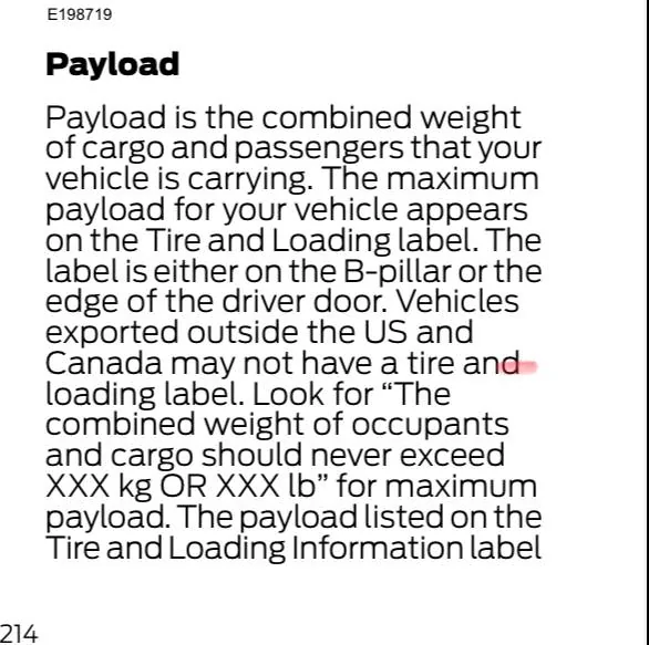

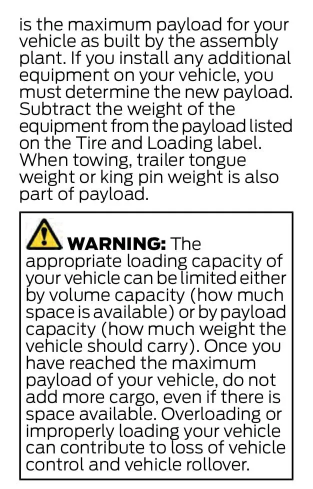

About all that GVWR means in practice is that you will have a harder time with warranty repairs or being able to sue Ford in the event of an accident. Otherwise nobody will ever check unless maybe the back bumper is near the pavement.
LEOs feel free to correct me. ?
