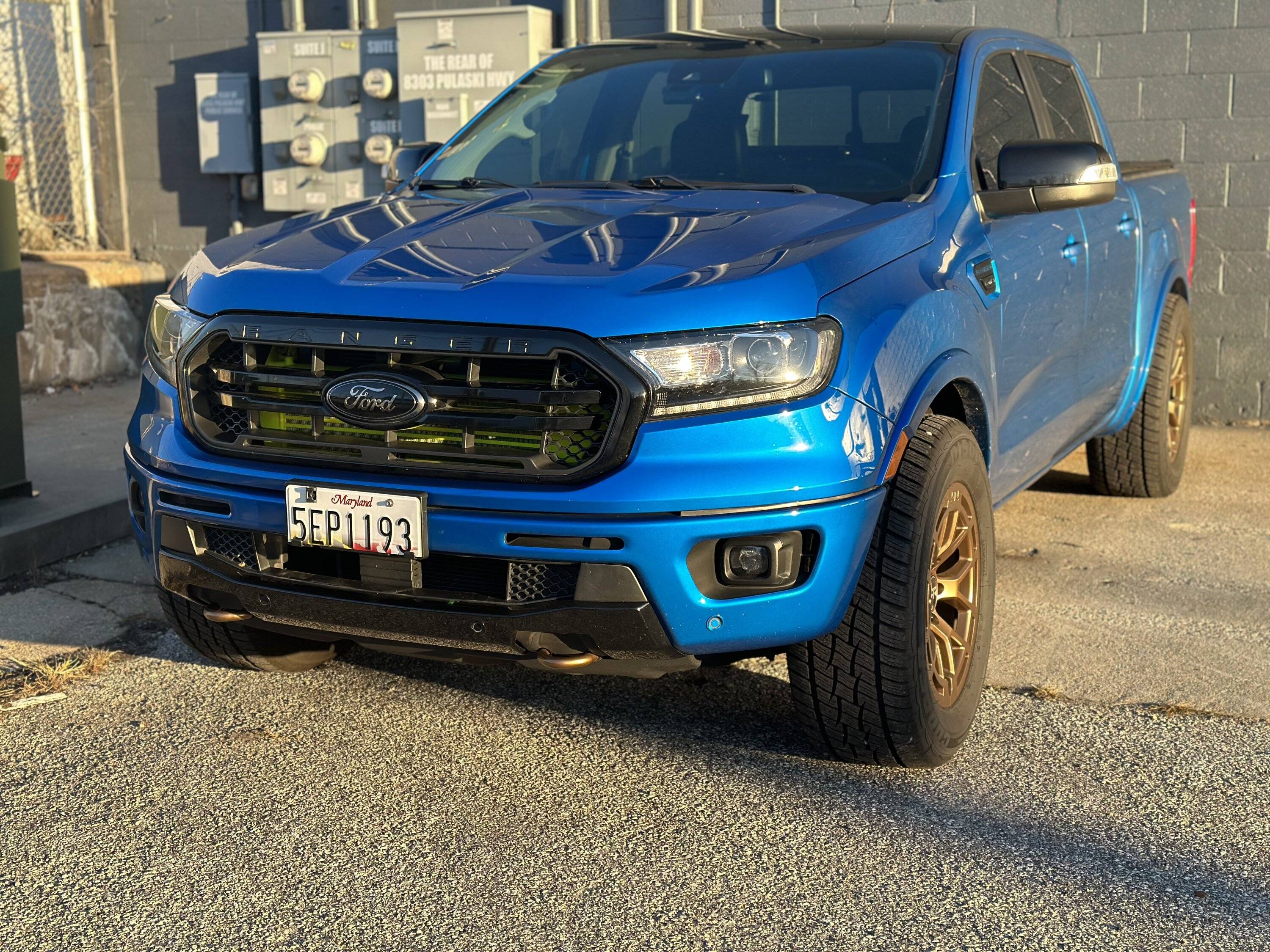

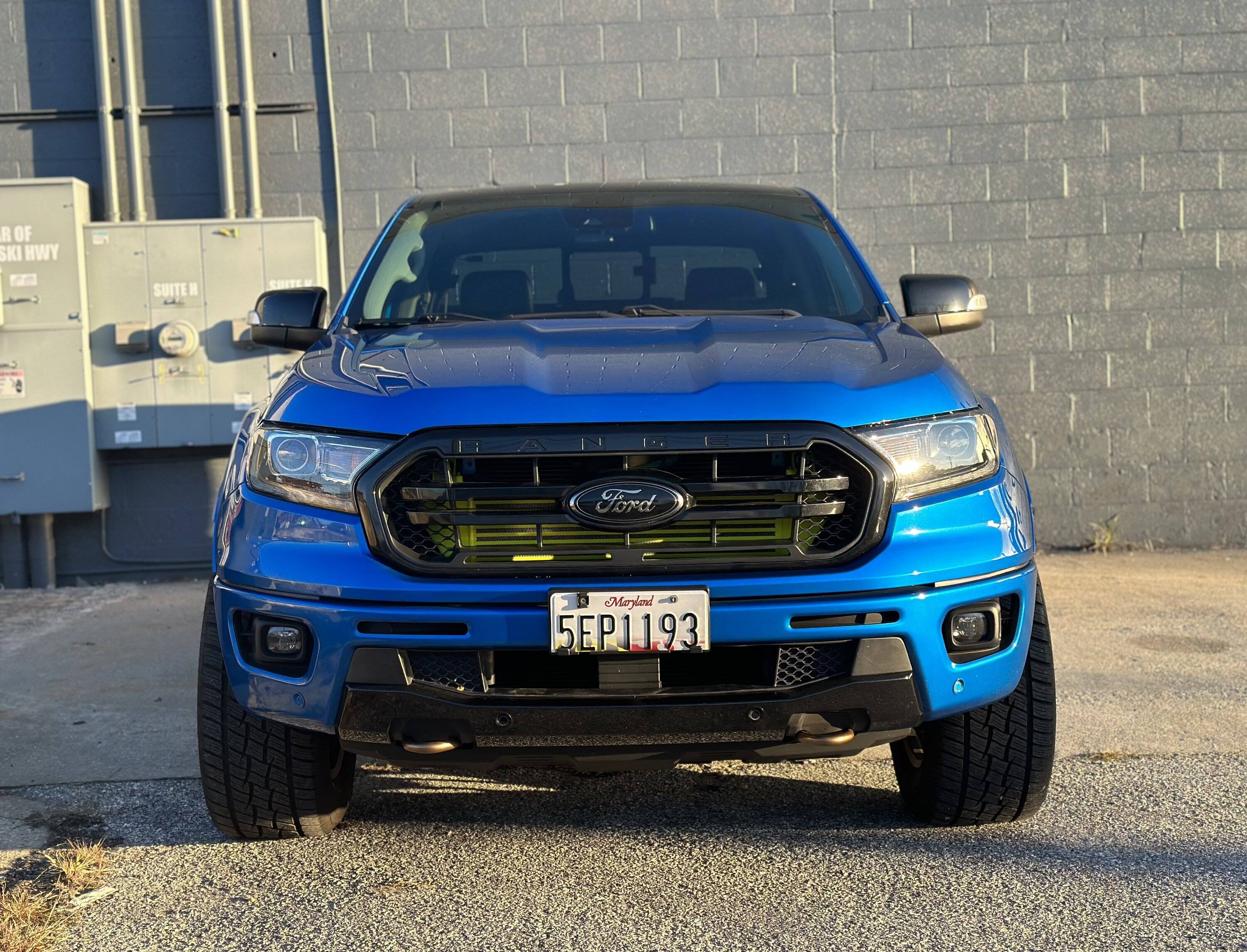

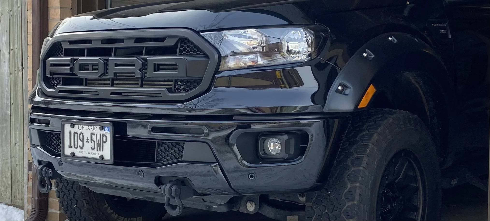

If you’re in a jurisdiction where you‘re required to have a front licence plate and you think it looks a bit odd sitting up so high, it’s easy enough to lower it by simply flipping the bracket upside down. There are also some good aftermarket options out there that achieve the same thing.
The good thing about this change is that it helps partially cover the big gap in the lower bumper and protect the a/c condenser/bottom of the intercooler/whatever the heck it is in there.
The bad thing about this change is that it will likely mess with the radar/sensor down that hole if you have Adaptive Cruise Control (ACC).
Flip the Bracket
Before…factory location
After…flipped

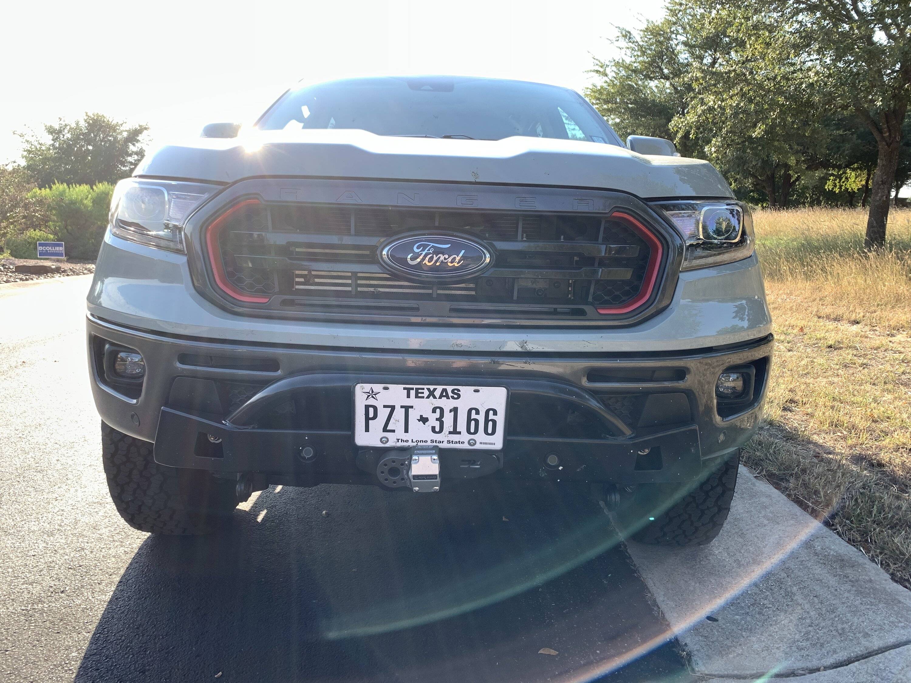

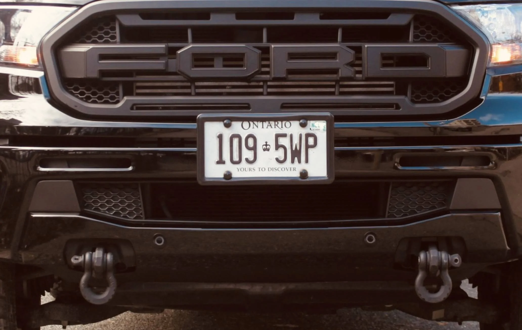

Relocate the Bracket

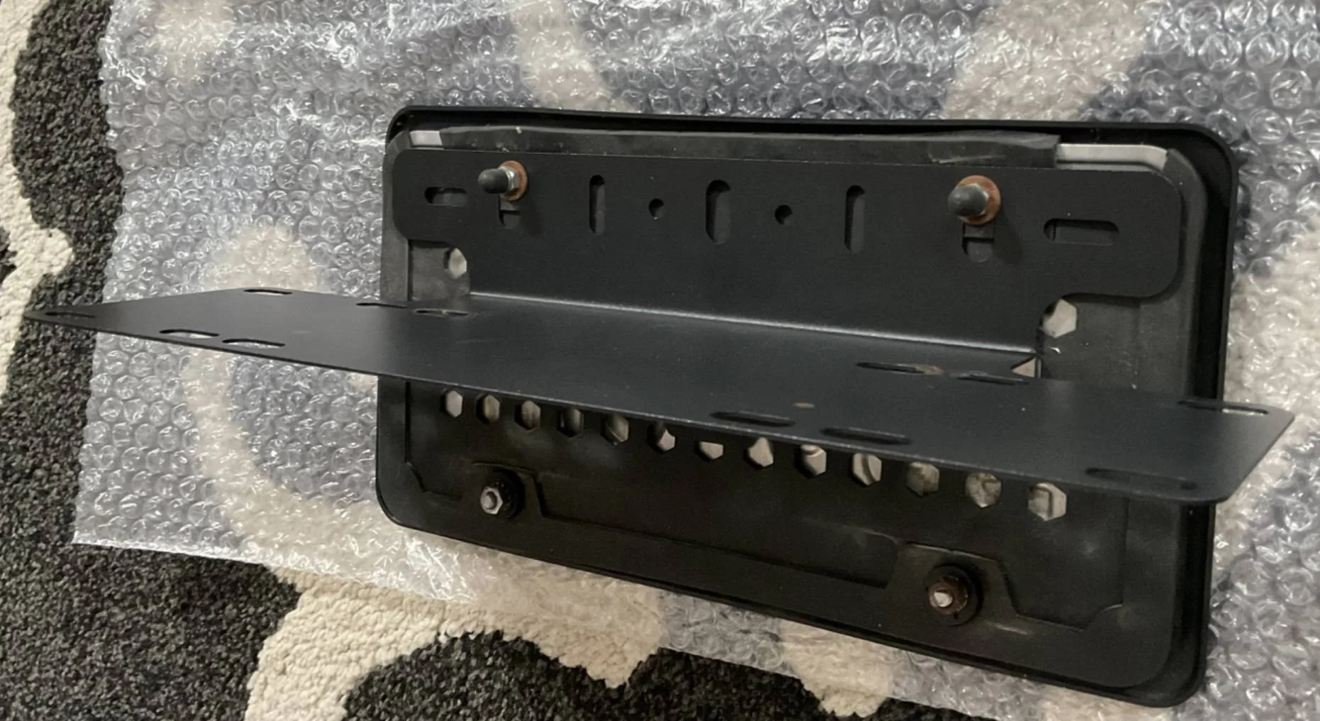

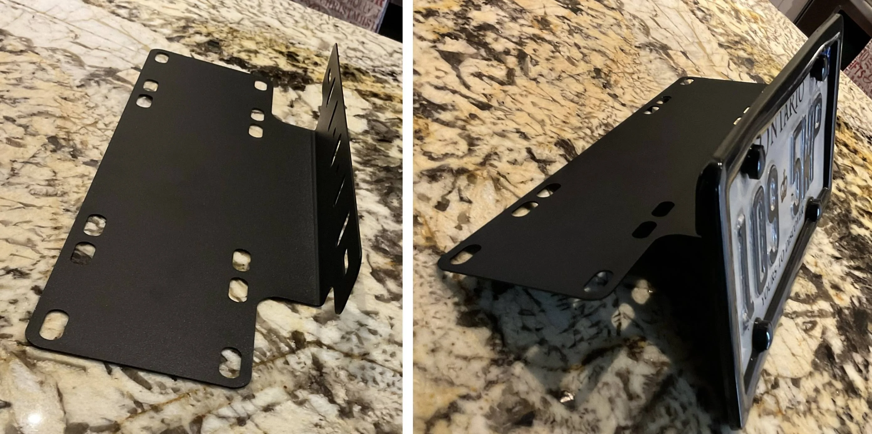

The factory licence plate bracket is a bit flimsy and breaks easily - I snapped mine clean off with a car wash hose and others have broken them parking. I bought a steel, powder coated aftermarket bracket to replace my broken factory unit.
Willpower - Amazon
There are a few different mounting options and depending on which one you choose, it affects the height of the plate. I chose to mount it like this because it provided the height I liked best…
It mounts similar to the factory bracket with the fasteners threading up into the bumper.
First, I tried mounting it using the existing bracket holes because they line up with the holes in the bumper but it stuck out way too far forward and looked goofy. It has to stick out enough to clear the bumper and to get it just right, I ended up drilling two new holes in the bracket about 3-1/4” from the tab that the plate is mounted to. I mounted my plate (with its silicone cover from Amazon) to the bracket and covered the exposed ends of the top bolts with rubber domes for protection (see pic below). If you nudge something and bend the plate, they will help protect the paint on your bumper. Four of these rubber domes can be found on the back of the plastic factory plate holder - handy!

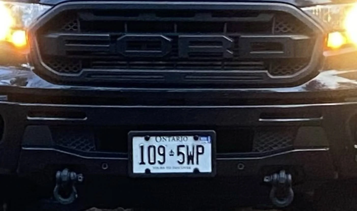

Here’s how it turned out…
It is just about the same height as the top of the bumper, with the bottom of the plate at the height of the lower valance - offers protection and leaves some room for airflow - no issues - it‘s been on over a year.
