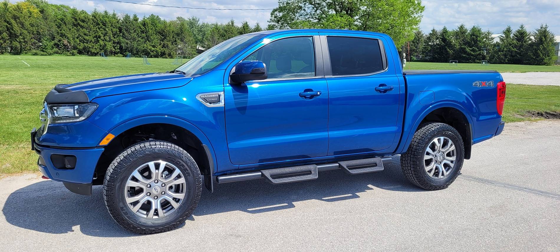

Bilstein 5100's x4, front @ 1.8
Cooper Discoverer Road+Trail AT 265/65/18
Very happy. No issues.
Thank you for posting this, I believe that I have just found the shock upgrade that I'm going to have done to my truck. Not to distant in the future. Lol! Your truck looks good!
