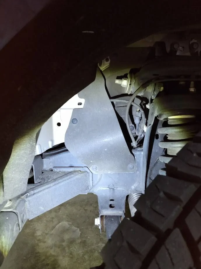

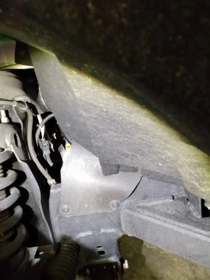

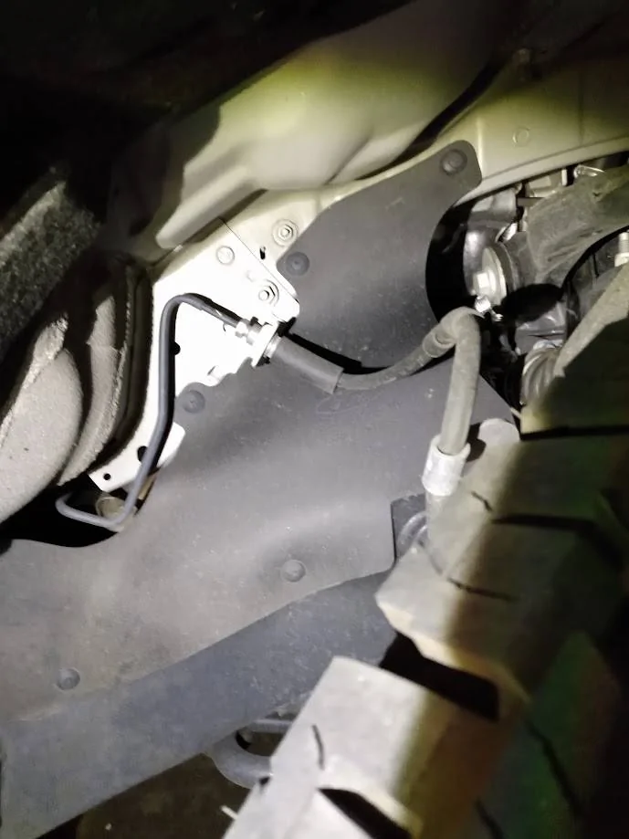

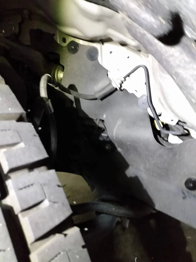

Post a pic of them so we can help pinpoint exactly what you are referring and where they are mounted
5,860
29,197
Here are the splash shields on my 2021 2 wheel drive...
first 2 are left side, other 2 are right side. 2 shields on either side, one front and one back.
On the left side rear I replaced the push pins with magnets to make it easier to remove shield when changing oil filter...

2nd picture tells the story. Thanks.
