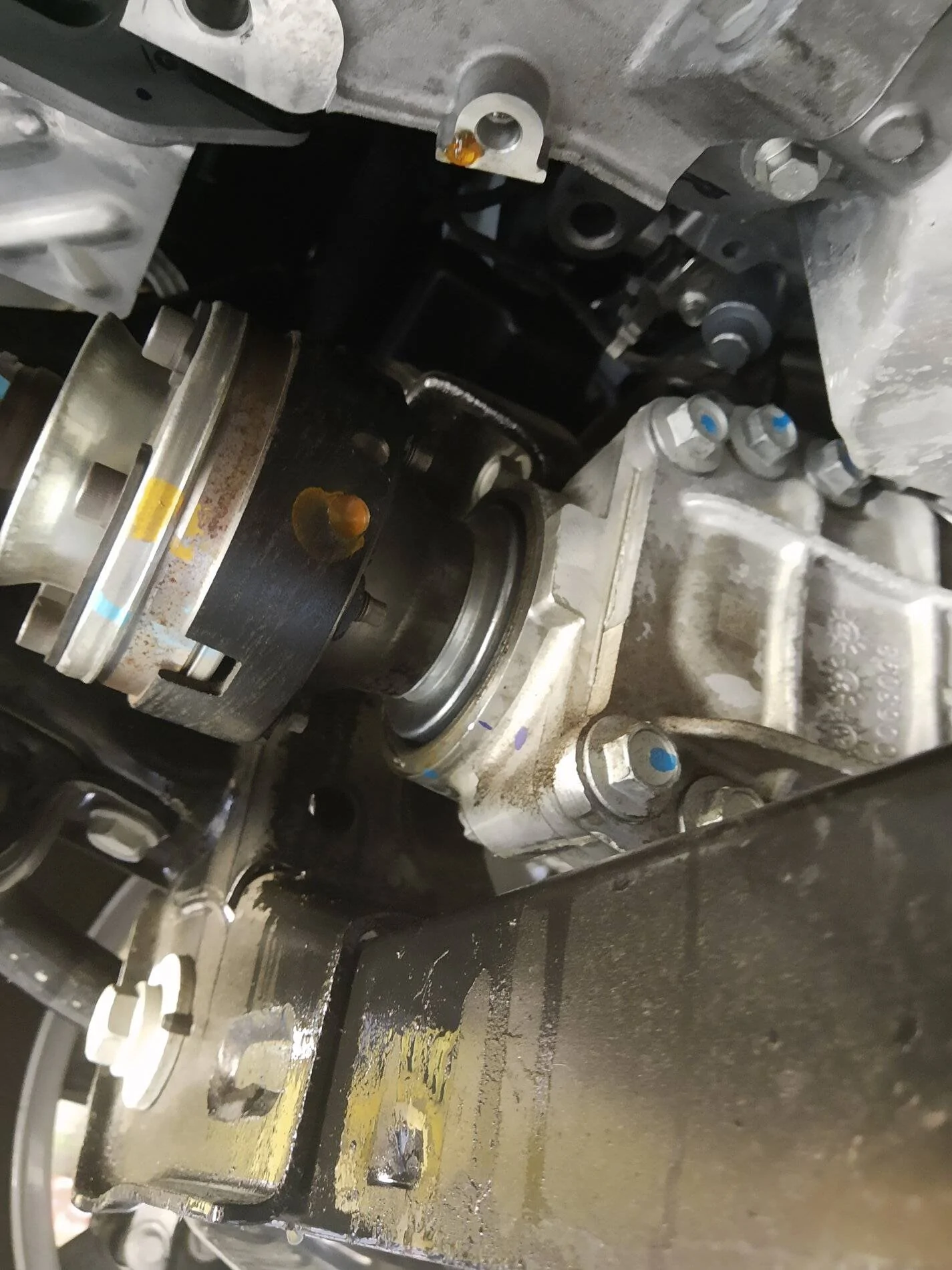

Called my dealer several times now. I have not gotten through to a human yet. Several voicemails have been left. I'm giving them until this afternoon before I check with the dealer the next town over. Supposedly the seals are in stock now with Ford. Hell, I might just order it and do it myself. The seal is less than $10 and I can wrench. This crap has gone on long enough...

So after ~five calls unanswered I decided to take off work a little early and pay a visit to the dealer in person. Long story short they have had the part since the 12th and supposedly had tried to call me to schedule. Sure... I have no inbound calls from them and they could not confirm with the scheduler that they tried to call me. So I have an appointment on the 7th to drop it off. Hopefully they can knock out the two recalls as well. I might have them do an oil change since it will be right about 4k miles on it then. Get that first one out of the way. Maybe I can twist their arm to do it on the house as I had to wait two months for parts.

Dropped off the truck 12/7 in the AM. Told me it would be a day to do the work.
Got a message today (12/8) at 11AM that it was done. Invoice says they had to take the rotors, calipers and sway bar to get the drive shaft out.
They also performed two recalls. One for the belts and one for the rear seat child seat anchors. Looks like I am getting new headrests eventually.

Did the dealer ever say what caused the leak? It looks like my truck just developed a leak from the same spot.
Thanks,
Ted
Never saw any specifics as to why it leaked. Could have been an improperly installed seal by the original builder or just a bad seal. It definitely had been leaking the entire time up until that point.
Just make sure they put oil back into it when they reseal it. My dealer didn't and I ended up having to get a whole new front diff... long story on that.
