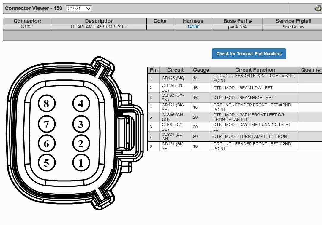

Goes to BCM, Pin 40 on connector C2280c, keep in mind that the BCM provides internal circuit protection (FET) for the individual exterior lights. You might need to do a BCM reset
C2280c - is the top middle connector on the BCM above the IPC Fuse box by your left knee
With Meter:
Note: To check DRL, place truck in (Neutral) and SET parking brake, DRL will not power in park
Pin 6 to Body Ground (voltage) this will check if you have power to connector
Pin 6 to Pin 4 (voltage) (This will ck ground circuit) wiring (Pin 4 is the ground pin for DRL)

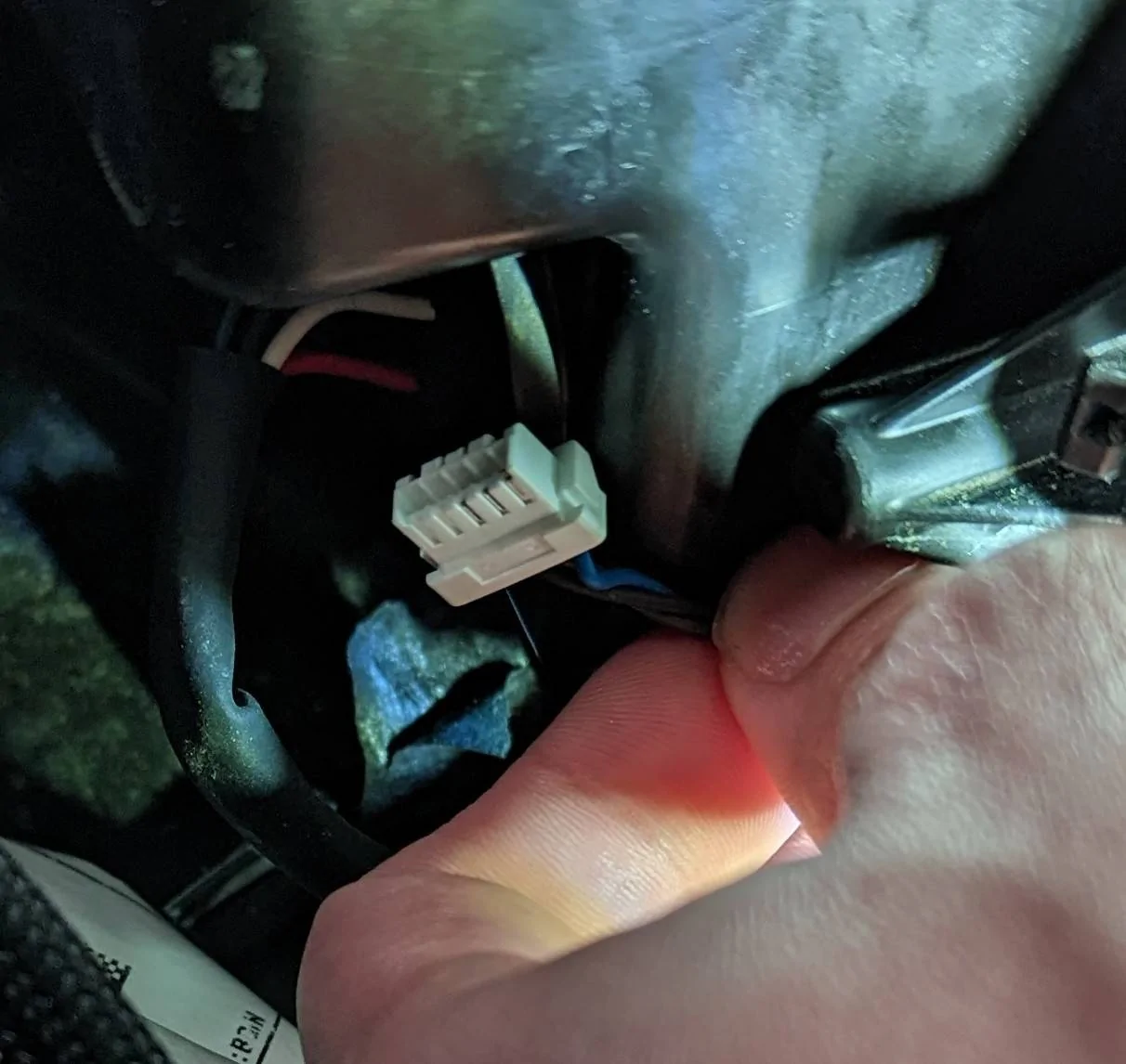

Left side drl now works. Only thing is it will only come on when driving. When truck is turned off it should remain on for 20 or so seconds but turns off when ignition is turned off. The right Drl stays on for the 30 or so seconds. I'm glad it's working when driving but confused why it turns off with ignition

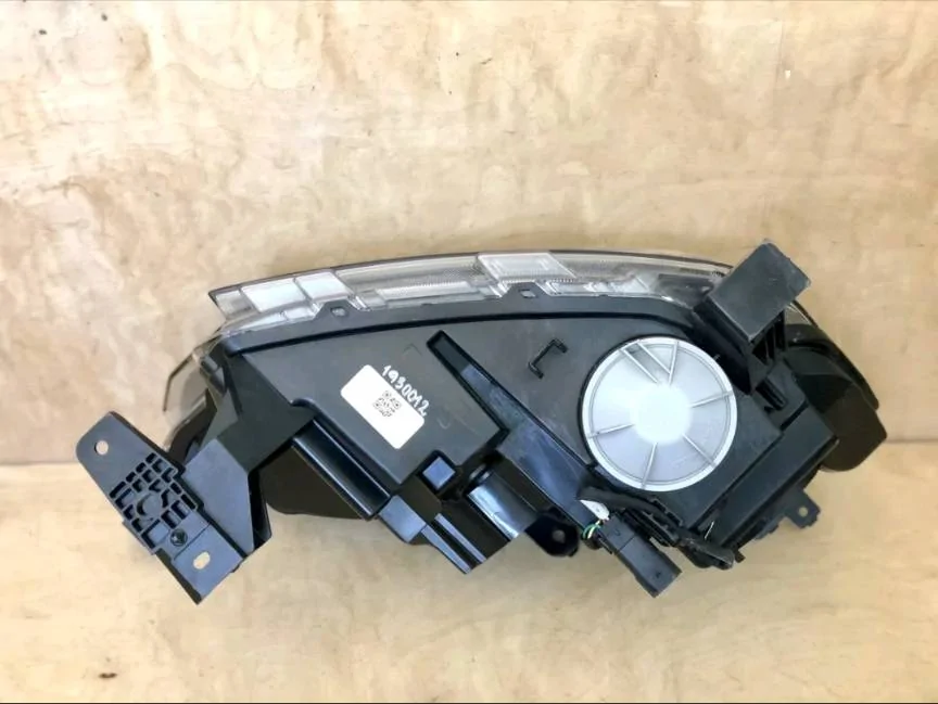

It sounds like the Park Light side is still not getting power (On & Dim)
If you use the FOB and press the unlock button, the Park Lights (DRL Strip) along with the Puddle Lights, Taillights and Cargo Lights should power on for a short period of time, same as opening the door. (The Turn Signals should FLASH briefly then go off)
If you place the Headlight switch in (Park Lamps) with the Engine Off, Does the L & R Led Strip light up in (DIM)?
If no, then check for power at the Left Headlamp Connector
Pin #5 = Park Light
Pin #6 = DRL
This will help eliminate the Headlamp Assy and then we can look further upstream
So, possibilities are:
Park Light wire also damaged; the FET Internal Protection of the Park Light circuit cut power to the circuit and due to the length of time it was damaged it is possible to be a permeant power cut.
Internal Circuit of the Headlamp Assembly - Itself - Shorted.
