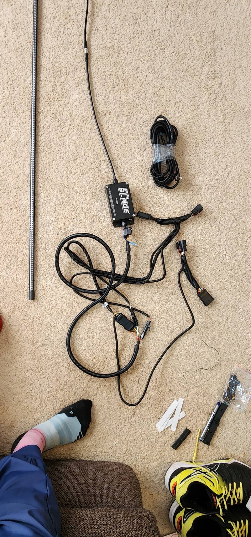

Sorry for being late in reply to this. I have been under the weather for a few weeks.
We connected up the full haness and per the instructions did NOT connect the red wire. I had even called support before we did the install to ask some questions and confirmed the red wire should be left unconnected. They told me on the phone that wire should have never been added to the freedom controller and that it was on the OEM harness for another product.
When we tested all the functions the brake light did not work as expected. I had programmed to do the triple flash. First brake after power up appeared to have worked, but never again. We even tried just connecting the 4 wire to the trailer connector on the bumper (eliminating the OEM harness), and still no go.
Putco only open weekdays, so waited till after the weekend and called them. They told me the controller was likely bad and to put in a warranty claim.
They shipped me a new one. When I felt better and had a few minutes I tested using the 4 pin only with the new unit. Same issue.
So called support again after the weekend. Several emails later going back and forth about how to hook up the unit they told me I needed to connect the red wire as it was the brake. I confirmed with them that the instructions and even support stated to leave it disconnected. They did state again to connect the red wire.
As soon as I can crawl under to connect the OEM harness again I will test it all out again.
Has anyone who installed this had the same issues? And did it all work correctly in the end?

Hey there. I am having the exact same issue. Putco told me the same thing they told you and I did a warranty claim. Received the new one and still same issue. Right turn signal doesn't want to work still. It initially did for a few seconds.
Any luck ?
