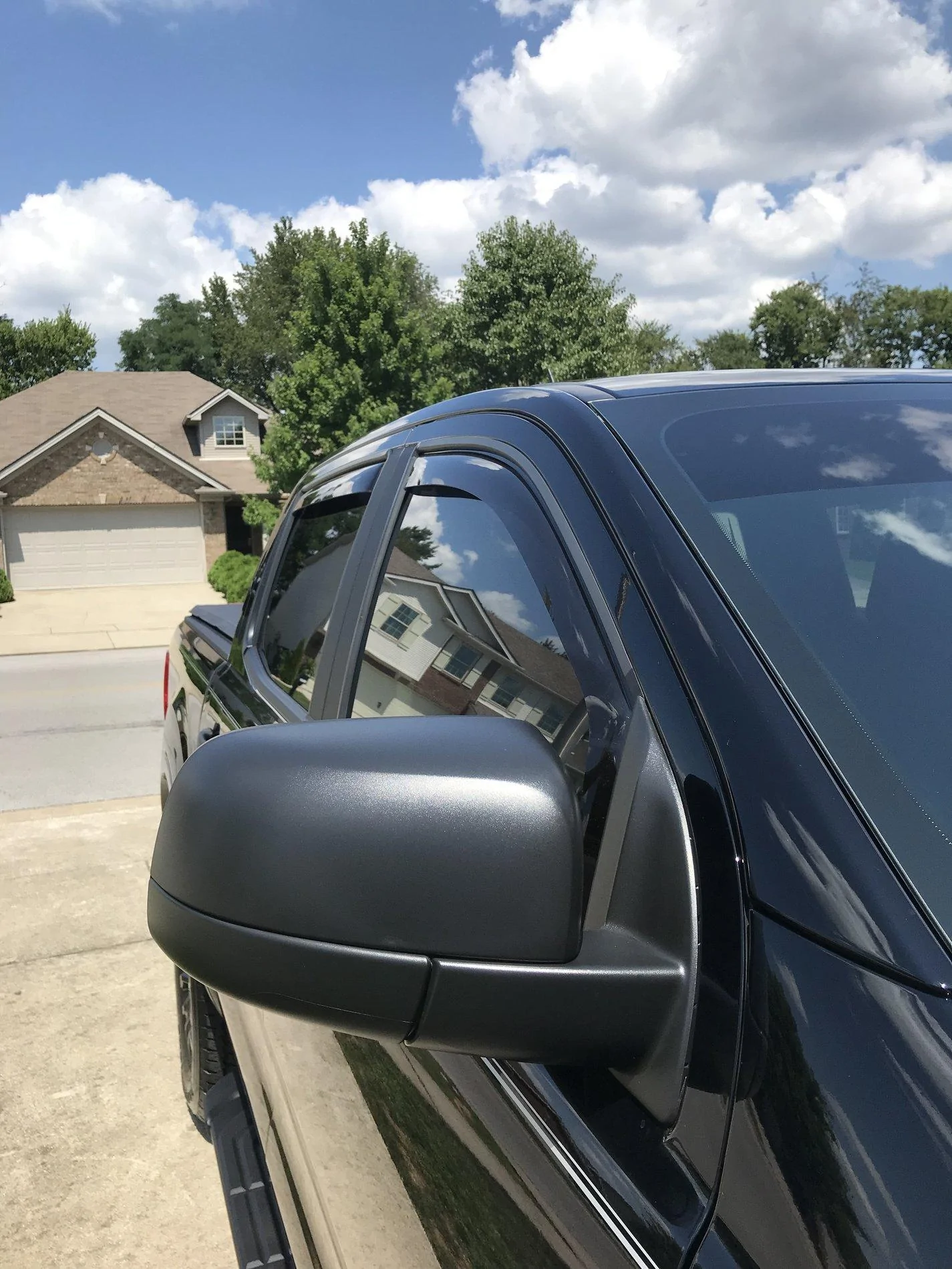

I installed the Weathertech option, but they prevent my front windows from closing. Dealer insists they are installed correctly, but nevertheless, I had to pull them out.
Sorry to hear you had trouble with yours. My automatic windows work fine, complete closure with no lag on window motor. As do the ones on my Subaru Outback and previous vehicle. Hope you find ones that meet your needs.

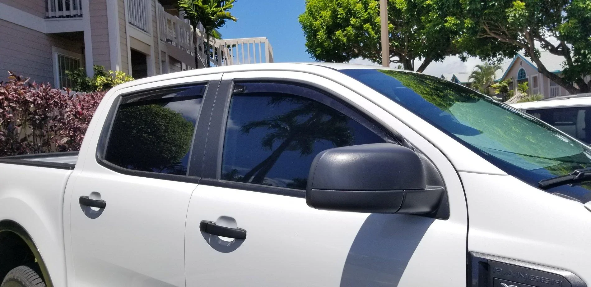

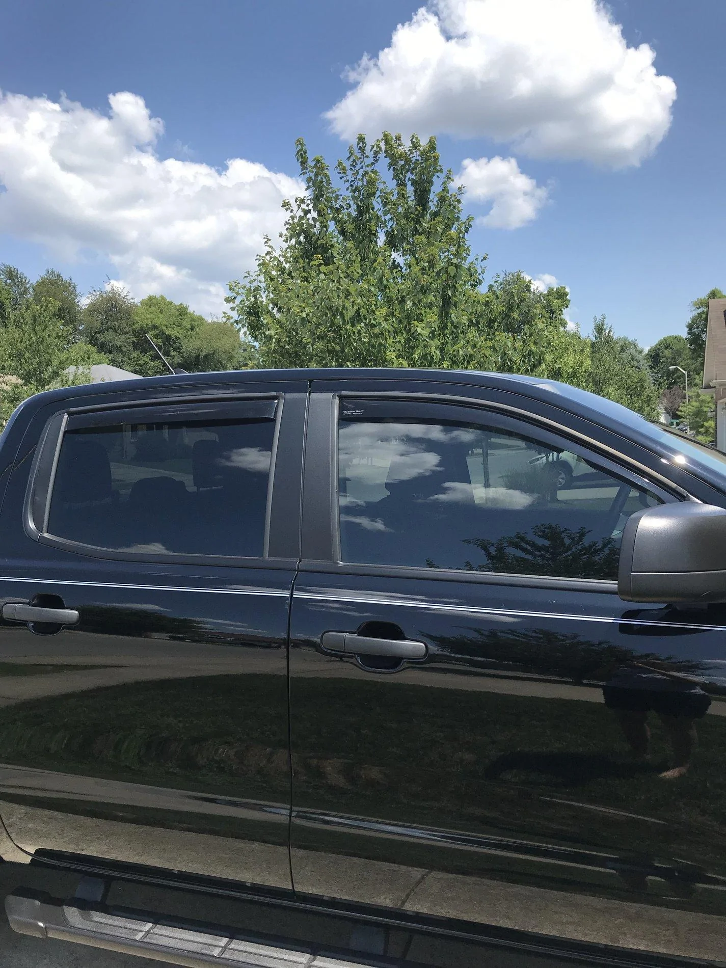

Received and installed the WeatherTech In Channels today. Easy to install. Love the sleek look!

I installed mine a week ago, couldn't wait to get the rear ones but there have been no issues. I used them on my 2015 Explorer too with no issues. Just have to make sure they are all the way in the channel and then the first time slowly roll the window all the way up.
