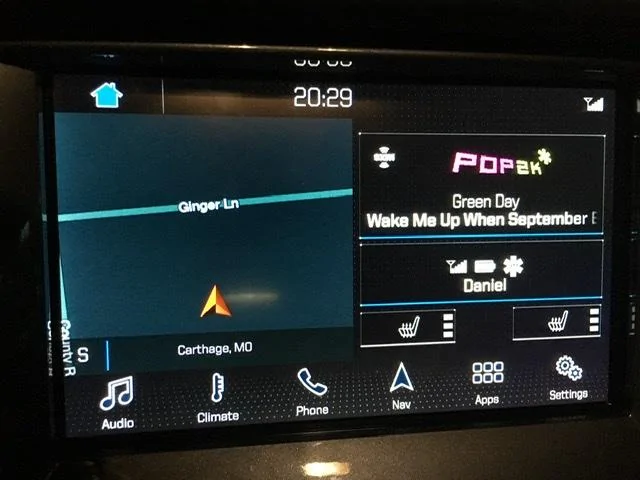

I'm having trouble finding how to get these light and dark modes. Can you tell me where to find them in forscan? Thanks!
I'm not in my truck at the moment, but I'm 95% sure this is an on-screen setting rather than a Forscan thing.

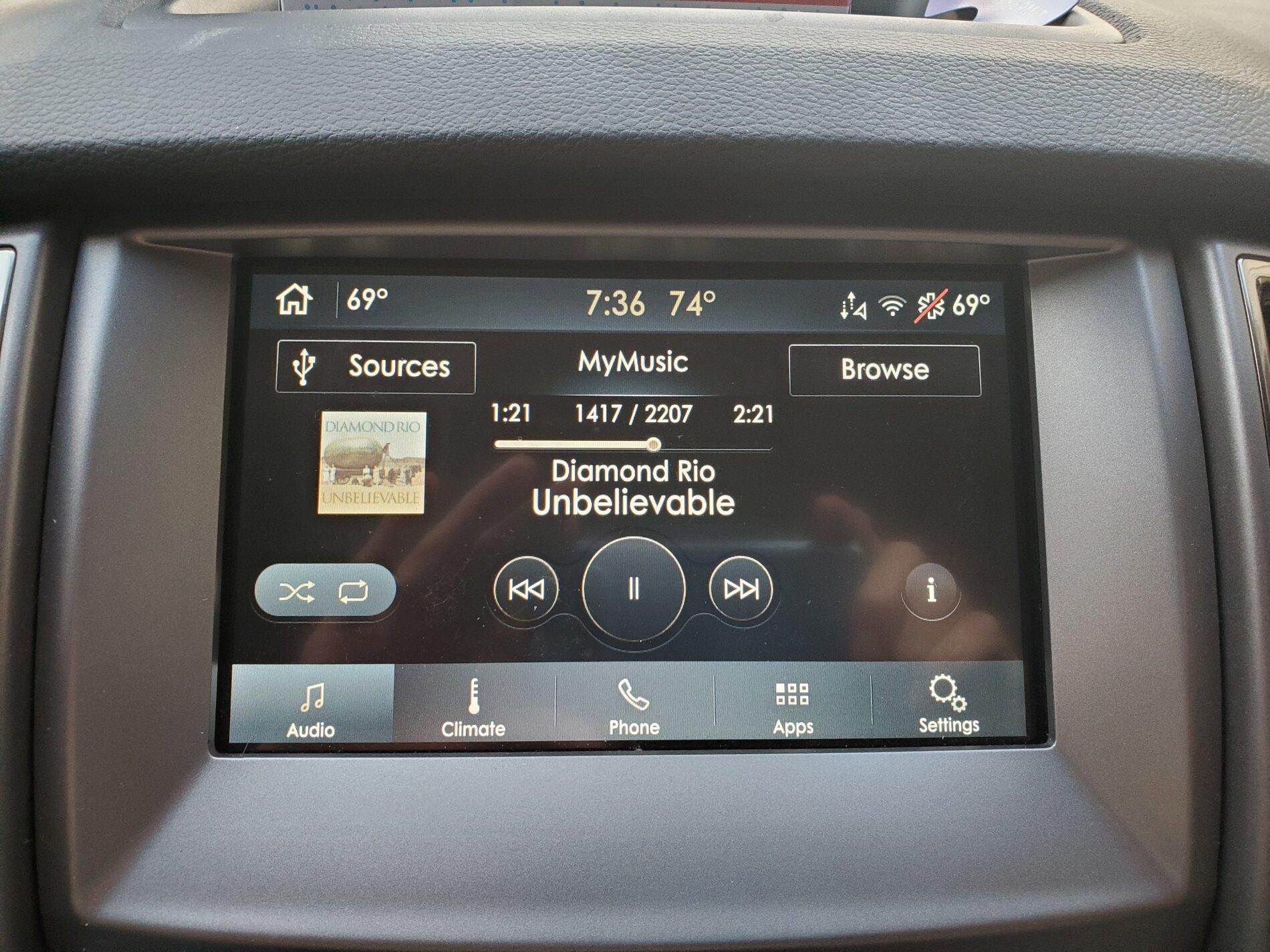

Bud you will find day and night mode in the settings section of your centre info screen..

Few weeks ago I changed mine with the lincoln theme and "Black Label" splash screen. Much better.

I more mean the specific theme you have with the light and dark mode. When I change to the Lincoln one it's just brown, not blue or black like the theme you have pictured. Can't get any of the other Lincoln themes working with the Raptor splash screen.
My pics are of the Ford GT theme. It’s not clear to me if you can mix and match splash screens with nonmatching skins. I’m also using the GT splash screen.

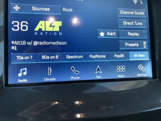

What version of SYNC are you running, 3.3 or 3.4? 3.4 has some additional options from 3.3. This is the screen I'm running with 3.4.
I'm running the "Lincoln timeless" "Visual Design Variants" (theme). Also Had to set the "Brand" to "Lincoln" and I am running the "Raptor" "Splash Screen". These are all settings in Forscan, in the APIM Configuration. I then went into Screen Settings in SYNC and set it to Night mode all the time and picked the darkest background color of the four available.
With 3.4 There are a number of new Splash Screens available. Haven't tried the GT splash and theme lately. I think they may need to be used together, or may not work in 3.4
