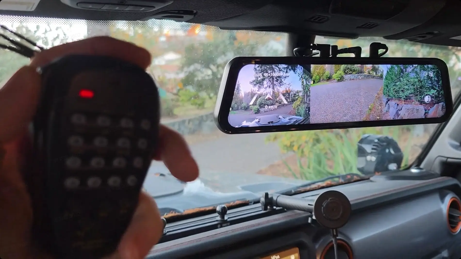

Do you have any practical ways of protecting electronic devices from being intervened by high frequency radio? It would be much appreciated. Thanks.

By "high frequency radio" do you mean ham radio transmitters that work in the 3.5-50 Mhz range? If so, operating at low power (5-10 watts) should cause no problem. Operating at higher power (100 watts) may cause interference which may be difficult to prevent if it's the RF causing the problem.
I operate a 50-watt VHF-UHF radio in my 2019 Ranger and it causes no interference.
