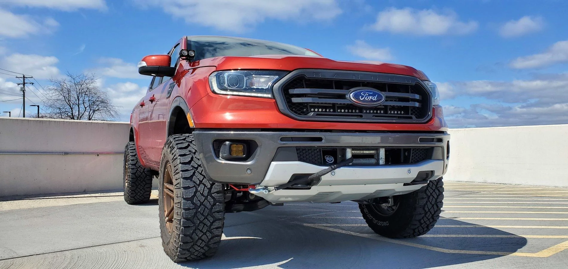

This is awesome! I have been looking at doing this as well. I am not worried about relocating the ACC, but I cannot find anything on how it does, or does not, effect any cooling. The winch sits right in front of one of the coolers (all though I am not too clear on which one it is).
A_Jake_Life
A_Jake_Life
Jake
Jul 14, 2019
33
108
Pennsylvania
2019 Ford Ranger Lariat Fx4 in hot pepper red.
I haven't seen a rise in temperature at all. The intercooler sits up behind the grill so you're not blocking it at all.

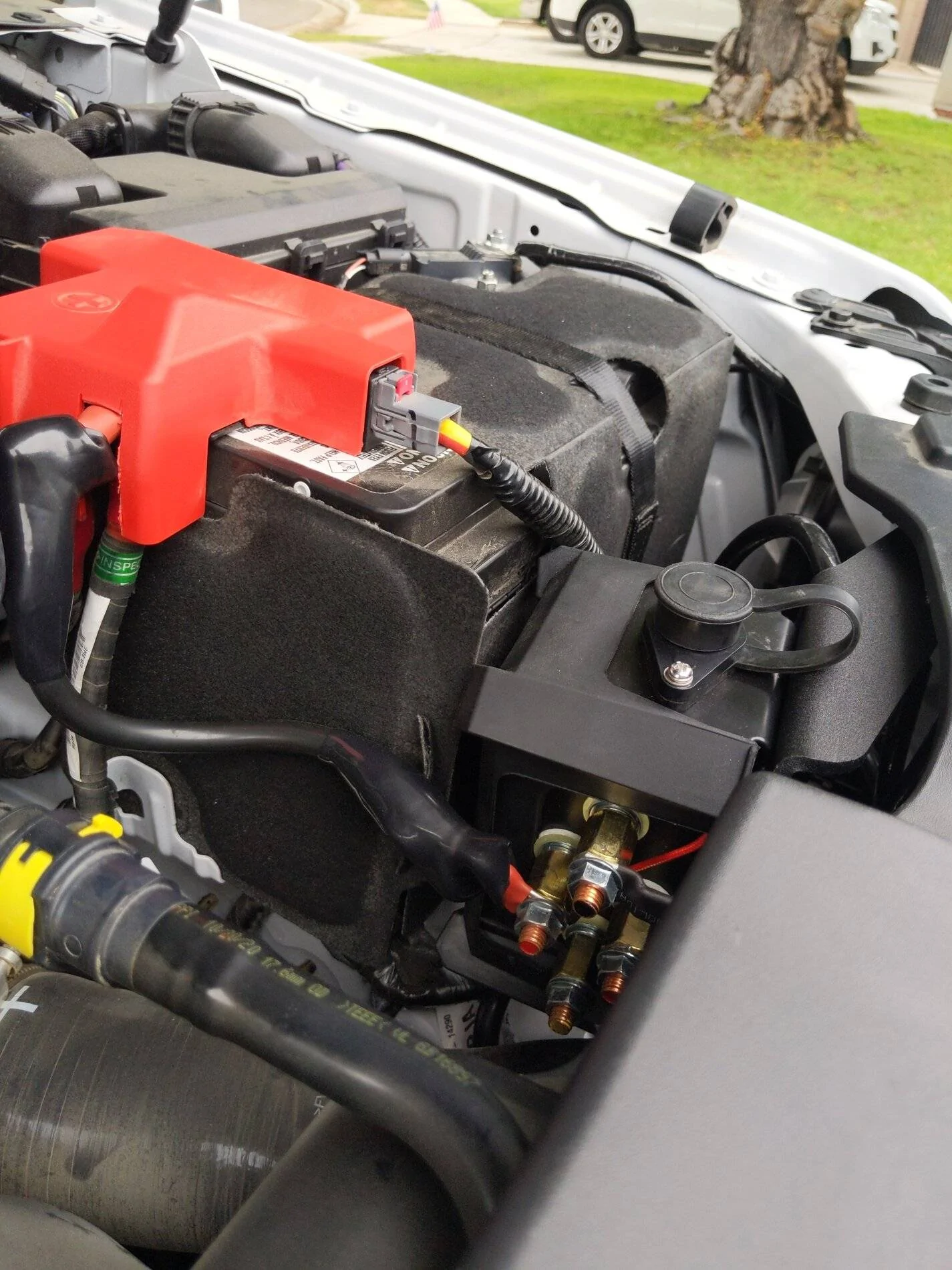

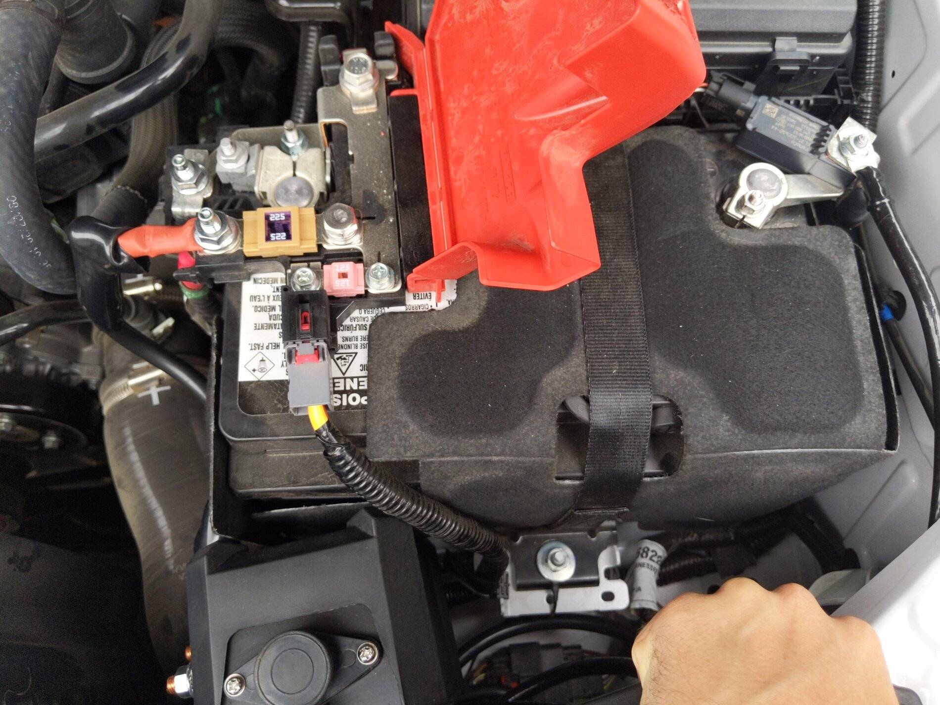

Here's how I got mine wired up. Ground is on the dedicated post at base of battery box, negative on the negative accessories terminal post. Lastly I connected the positive connection to an accessory post in conjunction with a 225 built-in fuse, since winches can draw a lot of power it's best to use them with the engine on.
As for the additional cable wiring, Home Depot sells 2gauge cable by the foot. But any marine/boating store will sell prepackaged 2 gauge terminal cables in 3-8 feet lengths. I would suggest the marine grade cables because they use many thin strands of copper cable vs fewer thicker strands like the cable sold at HomeDepot (much softer/ flexible like automotive cables). Made it a PITA to manipulate the cables for wiring..
I've had mine on for over a year now, and haven't had any issues with cooling, including towing a 4000lb trailer over some steep mountain passes in CO.

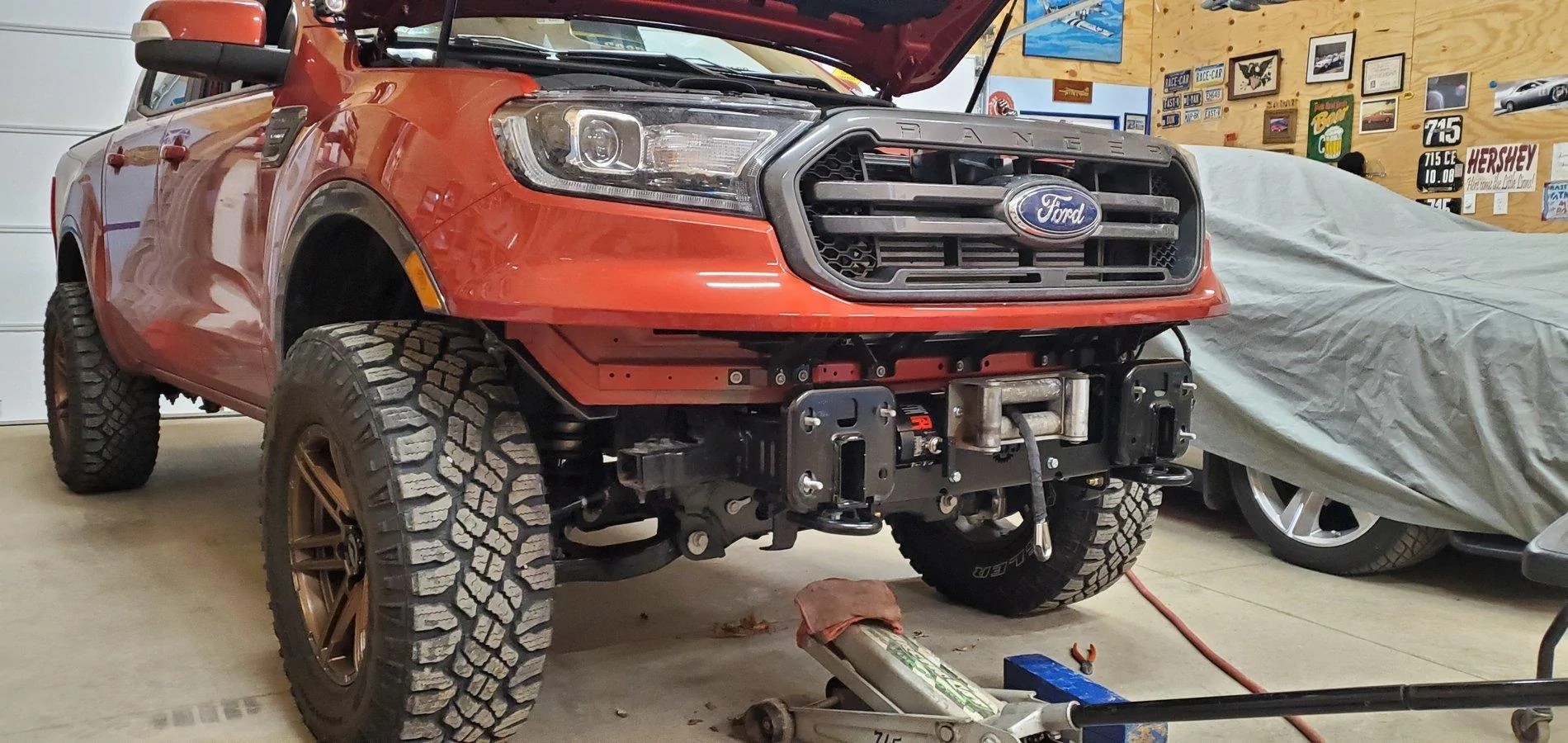

For the longest time I've always wanted a winch. As someone who enjoys going out exploring alone, it's almost a necessity to have. 589 Fab makes a mount that goes behind the factory bumper.
The install was pretty straight forward. I cut the control box bracket shorter for a cleaner look under the hood.
All that's needed now is a good muddy trail to test everything out.

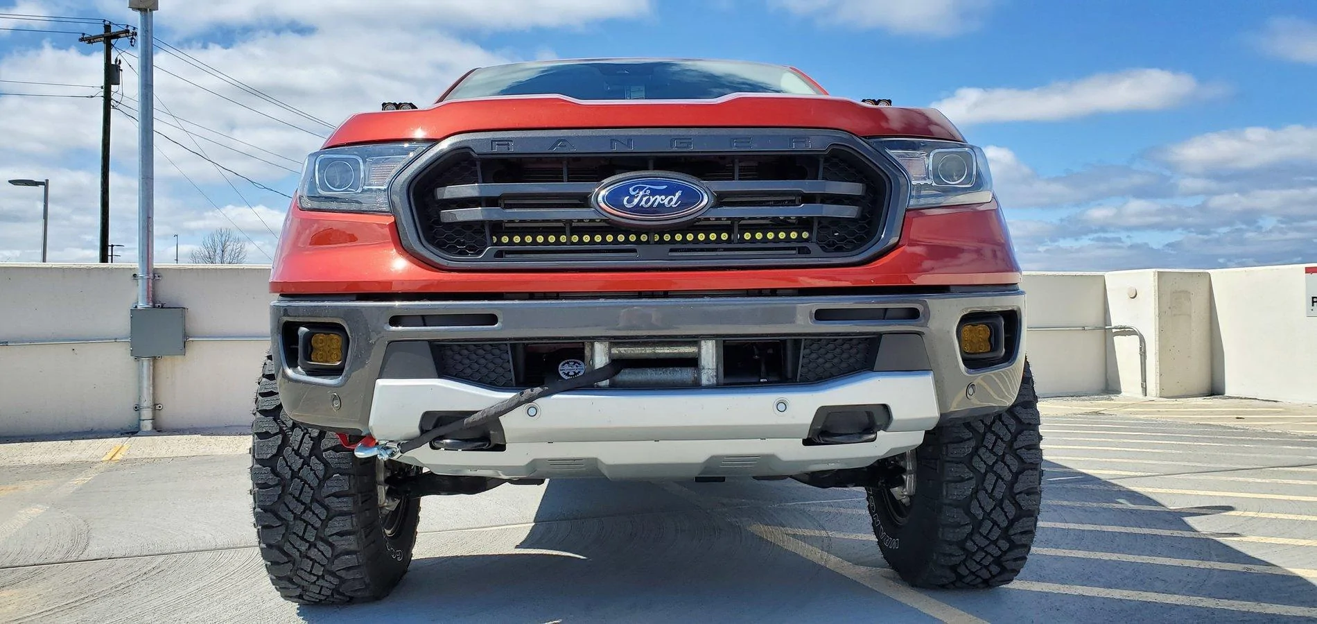

Doesn't that entirely block airflow to the intercooler?
