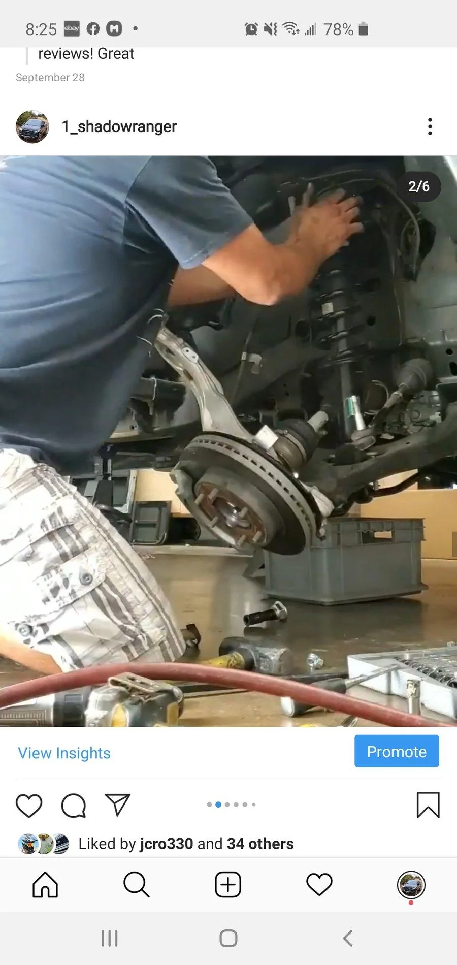

I ended up dropping the lower control arm and avoided messing with the CV. It has to be aligned anyway soooo I made the call and I haven't had a single alignment/driveline issue. That was abut 2 years ago. You'll need an extra jack to help hold everything. extra stands were a plus as well.
