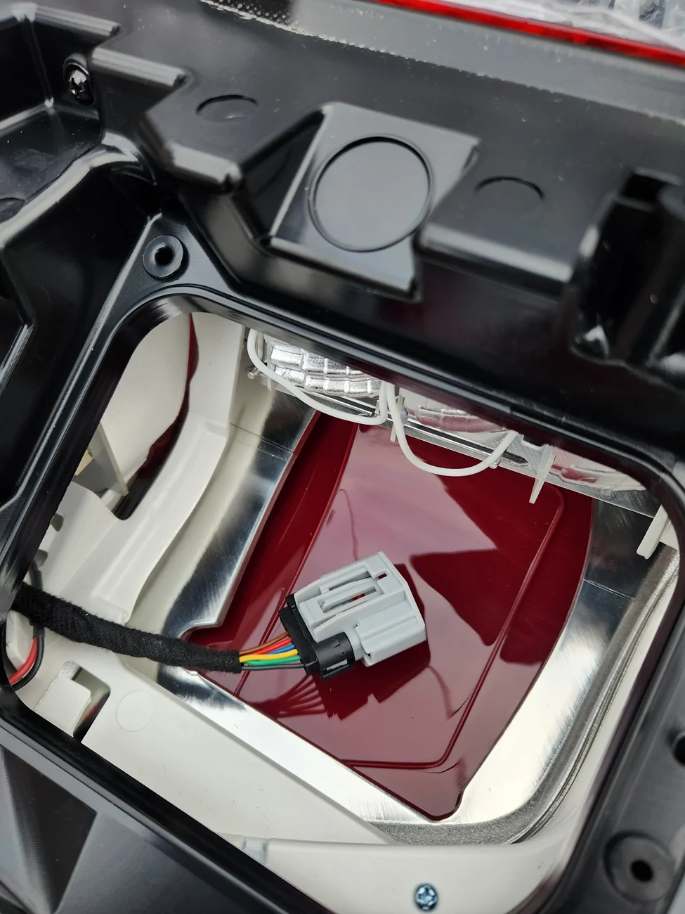

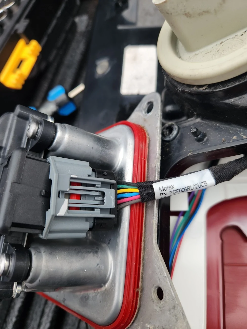

2019 Ranger limited. I broke the rear passenger slide break assembly lens.I wanted to replacement lens comma but I need to put the old blis unit. How do I remove the wire harness from the old bliss unit?So I can move it into new unit?

I have to be able to unhook the wire harness from the Bliss unit in order to install it in the new unit. I posted two pictures the top one is of the old unit and the bottom one is of the new unit.

Unscrew the 2 screws from the black module and remove from its mounting plate. Then you can gain access to the connector.
