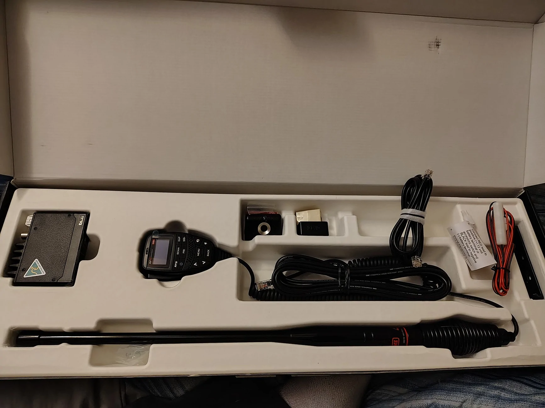

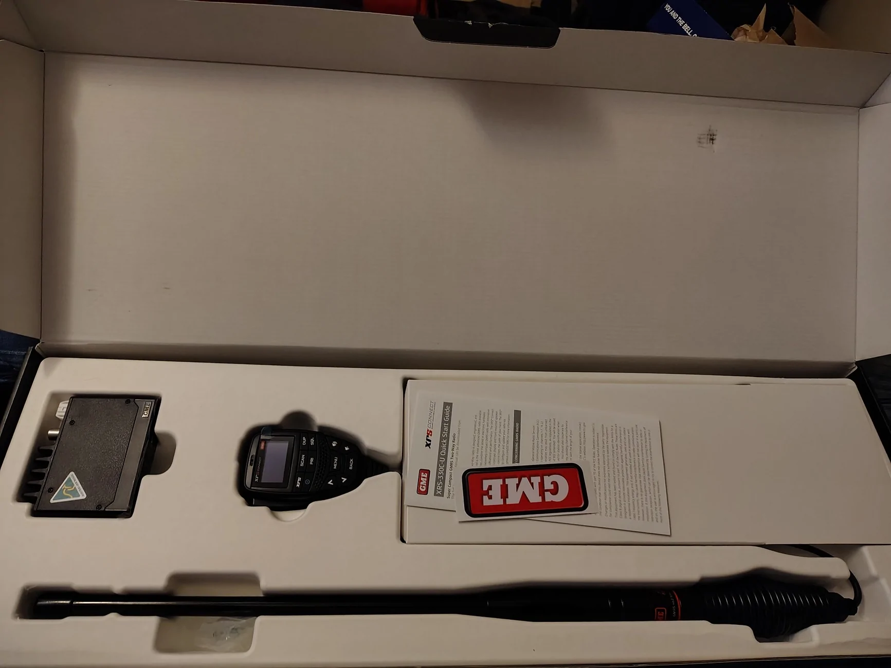

When opening the box you have a nicely packaged product. It even includes a sticker!😁
After removing the small internal cover, you get to see all the small bits.

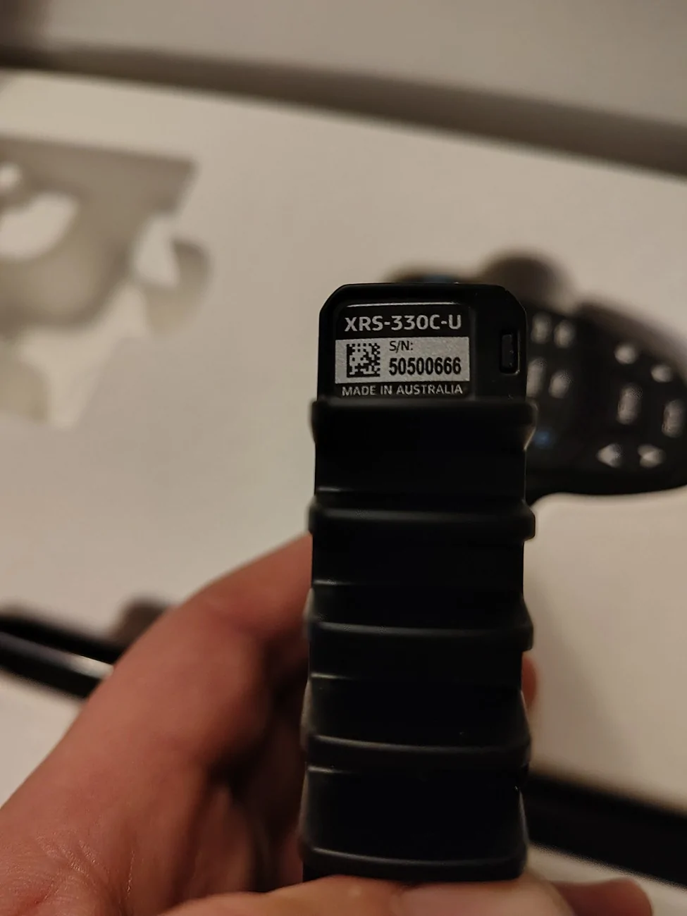

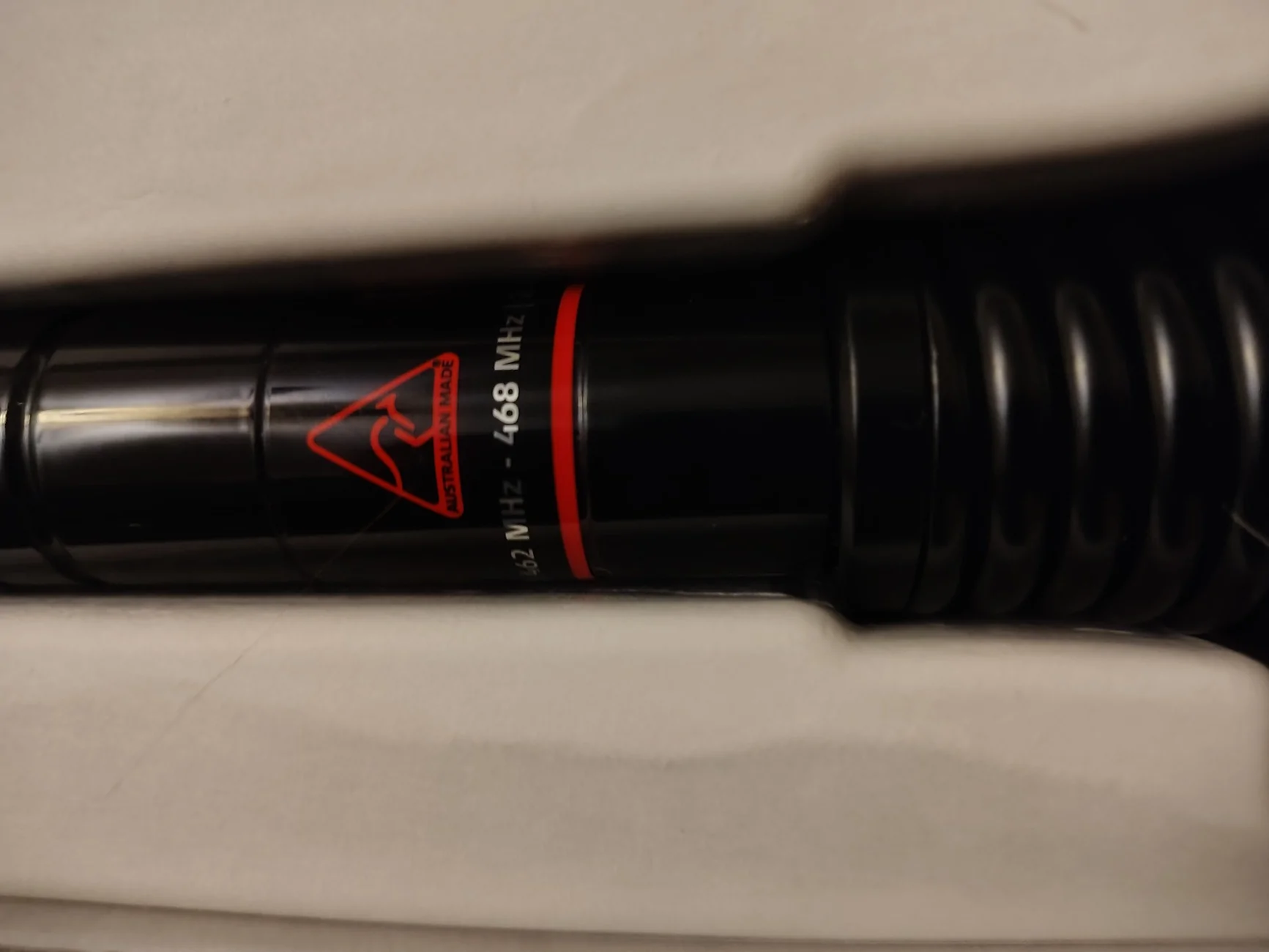

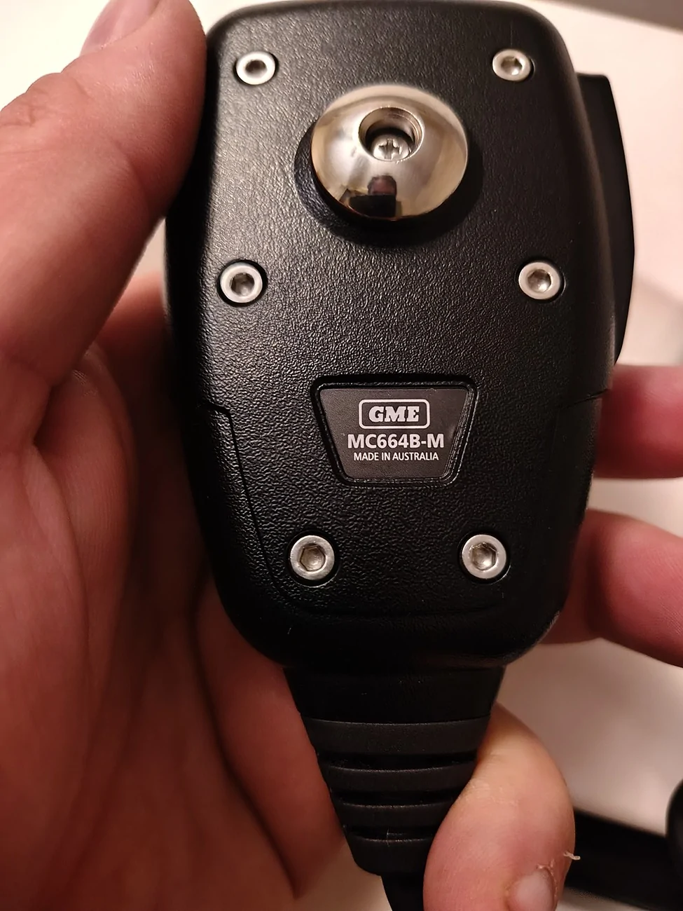

Taking a closer look you will see the "Made in Australia" labels on the Unit, Mic and Antenna. If anything it is very reassuring!

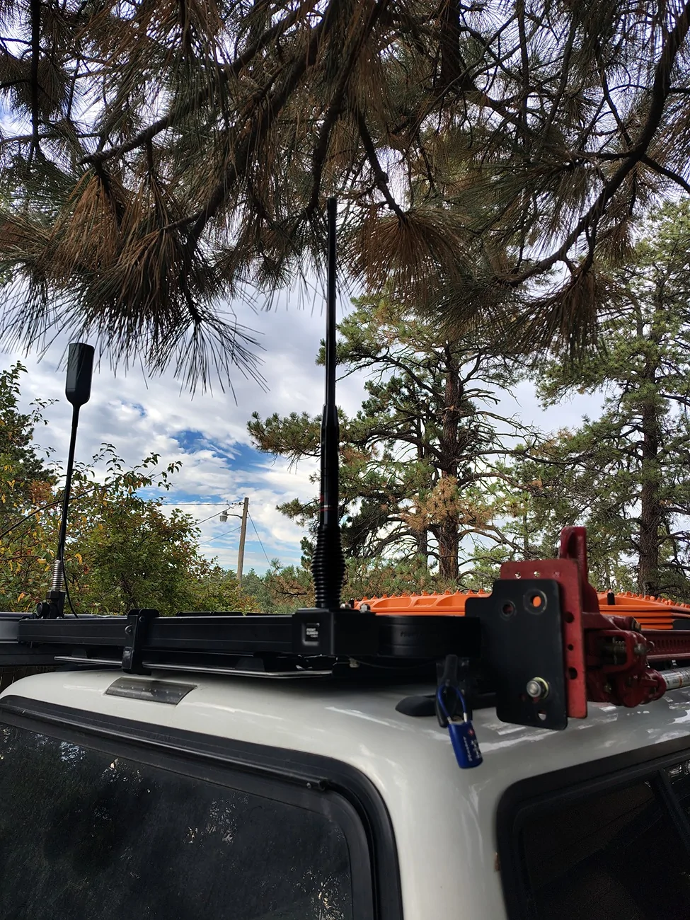

Well the install is complete. It took a little bit since I had to remove my Midland MXT575 with Highland Antenna. I would say it took a out 2.5-3 hours to complete.

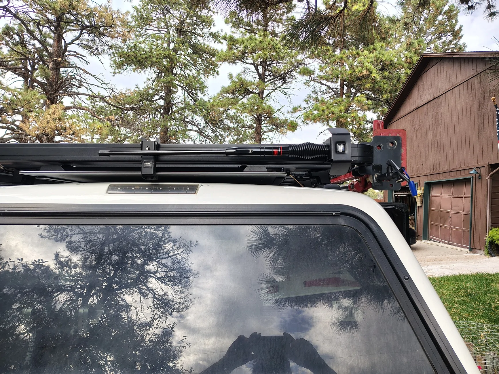

Once the Midland was out, I started on the Antenna. I mounted it to the rear of my Topper Roof Rack. With the Front Runner Antenna Mount I can fold the antenna over when. It in use which makes it nice for most situations. Whe. It is in the upright position, I have little to no interference with other objects(even the WeBoost is a t a different height).

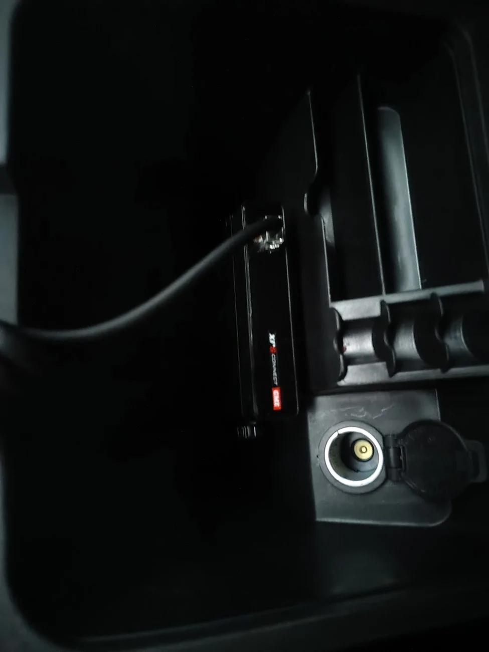

After the antenna was mounted, I took time to route the antenna underneath the cab and into the drivers compartment. With the 16.5 FT cable it was perfect to have the base unit in the Center Console like my previous Midland. If anything it just takes up way less space!

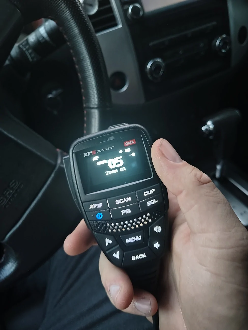

After hooking up switched power(the back of the 12 volt socket there) I connected the Mic and turned things on. I connected the phone with the App and updated the firmware. I was also going through the app and noticed you can change a lot of the channel settings and then set them to the radio. Makes it nice when you don't want to go through the Mic itself.
I will also state that the Mic is very easy to read. It's a simple black screen with white letters that don't mess with the eyes like the Midland did with different backgrounds.
