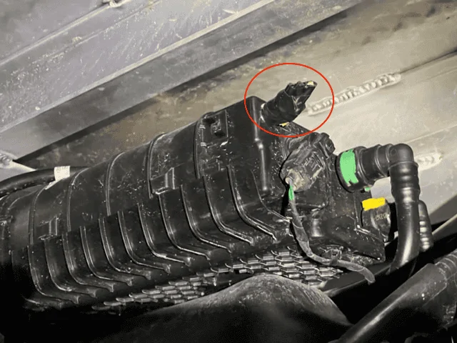

Hi Benny, I'm trying to locate a part
I'm trying to find a part number for a piece that's been removed from my truck and am having very little luck. I believe it to be a vent hose for the emissions canister, and unfortunately the post with the shop manuals for that the manuals are 0 length PDFs :(
The part I need attaches to a black box on top of the fuel tank shown here in the red-circle
and I believe it to be a vent hose that will end up attached on the outside of the fuel filler with some sort of cap/filter/one way valve on the top from what I can tell, but I could be wrong.
At the moment I can't fill the truck full speed, and it's thrown some Evaporative codes P0451 and P0496 and I believe it to be related to this being plugged and not in place now.
Does anyone have any info on where I can get this? My local Ford dealer has been pretty much useless, only commenting that we removed the truck bed so they'll no longer deal with it. This despite Ford publishing a body builders manual to do exactly what we did with the truck.
thank you
thank you

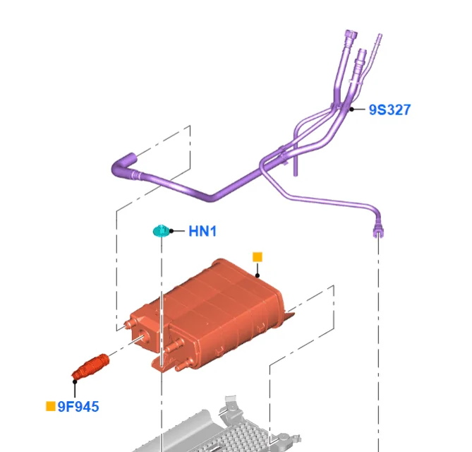

Hi,
That one hose is part of a harness as shown here
Here is a link to it https://parts.levittownfordparts.com/oem-parts/ford-vapor-hose-kb3z9g297a
