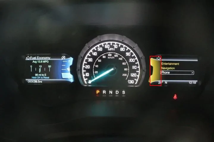

Sorry If this is confusing or if it's been answered and I just missed it in my search of the forum. Somehow I enabled a Gear indicator on the right side of my Lariat dashboard where the Entertainment, Navigation and Phone menu's are with the time, compass and temperature gauge.
How I did it I have no idea but after restarting the vehicle it's gone and I'd like to have it back. Does anyone know how to re-enable this?

When in Drive, you press the shift button on the shifter and it appears. From there you can limit the upper gears it can go into by pressing the button down. Only remains like that until you shut down the engine and then it resets. I think it also appears when you shift into Sport mode.

Puzzled me too - since I have my manual in the "reading" room I finally found the explanation page 154 in manual and is called Progressive Range Selection and allows you "to lockout gears from the automatic shifting range" put it in drive and push the - button on the shifter.....
