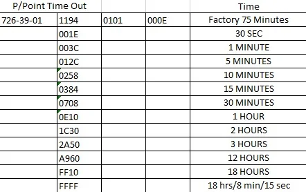

BCM (As-Built) - Change the first set to whatever you want, this is for the Front (lighter style) power points.
What new (TBC) is installed? (amperage draw?)
What is the Charge Line (Amperage) Spec (output in amps)
I actually would not rely on the Power Points for the following reason
The Power Points are direct battery feed, BUT are controlled and monitored by the BCM, this means that in addition to the (TBC) draw you will have the BCM still awake and associated Can Bus traffic adding more current draw, that is relying on the RV to keep it awake.
I think the best option is a direct to battery (fused) feed as long as the RV charge line can support the amperage draw from the TBC without lowering the Rangers battery voltage in any way.
You need the understand the (Importance) of maintaining the battery voltage as even a voltage drop minimum of 11.5 volts can cause the truck to come out of neutral tow on its own and you would never know it happened until you try to drive it.
Disclaimer: I have never (Neutral Towed) my truck, I just know that:
The Ranger is VERY SENSITIVE to battery voltage during Neutral Tow because the transfer case neutral position is electronically commanded and retained by the TCCM, so even a brief low-voltage brownout can reset the module and risk unintended transfer case re-engagement while being flat towed.
I would like owners who have flat towed to chime in and note if they have had any issues with using any powered devices while being towed to confirm, yes, I can see it being ok as long as you are direct to the battery and the charge line can support it - but the modules must be allowed to sleep
