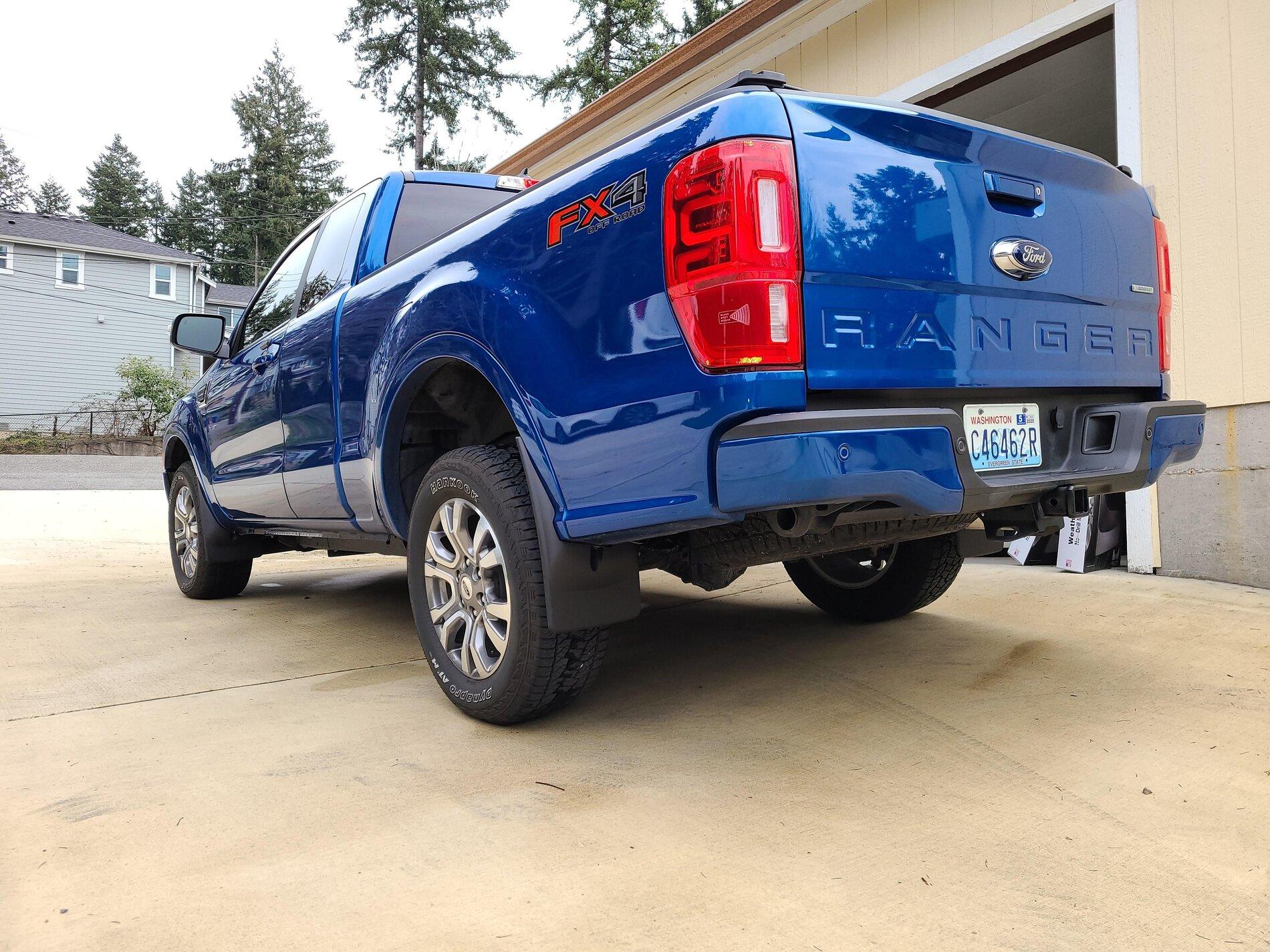

Weathertech makes the "no drill" mud flaps which we installed. Took the two of us about 2 hours in total to install, and they really do give you everything you need! Plus no drilling.
