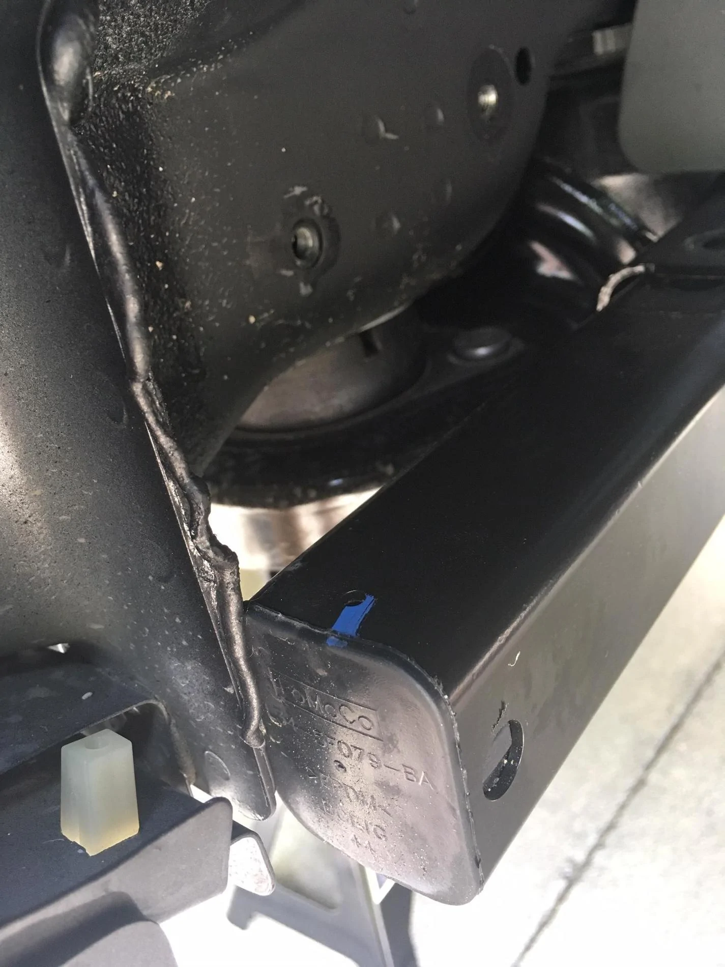

You can slide out the front and rear crash bars with a little creativity...:)
have you "slide" your crash bars out? if so how difficult was the task, did you remove the wheel to get to the bolts? thanks
9,199
28,383
NWO Robot Polisher

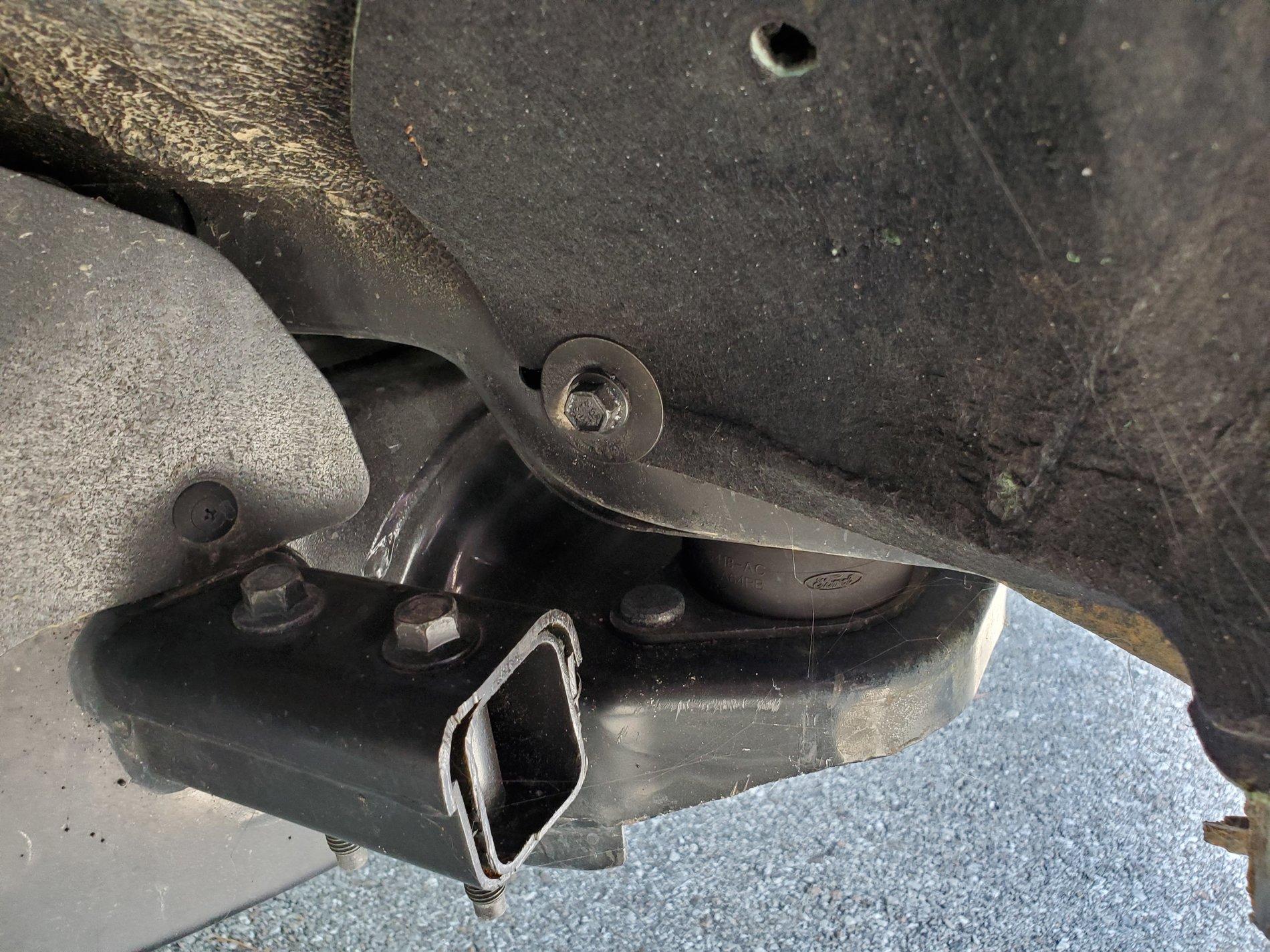

Yes you will need to remove the wheel/tire first. Start here:
https://www.ranger5g.com/forum/threads/project-msfitoy-v3-0.2804/#post-37443
In my reference, I did not remove the bumper. I only loosened the bolts at front (after removing the plastic fascia trim hiding the bumper bolts). Pull one side at a time and you can get it moved out just far enough to slide the front bars out. Repeat same procedure on other side.
I got back on the rear bar later after I got tired of not being able to maneuver in parking lots. As you can see, the rear was inhibited by a small amount of the fender.
Tires came off again and this time I unbolted the panel at bottom of rear opening, unclipped the lower portion of wheel trim. Then with a gentle tug of the lower fender, it was moved a fraction of an inch away to clear allowing the rear bar to slide out.
