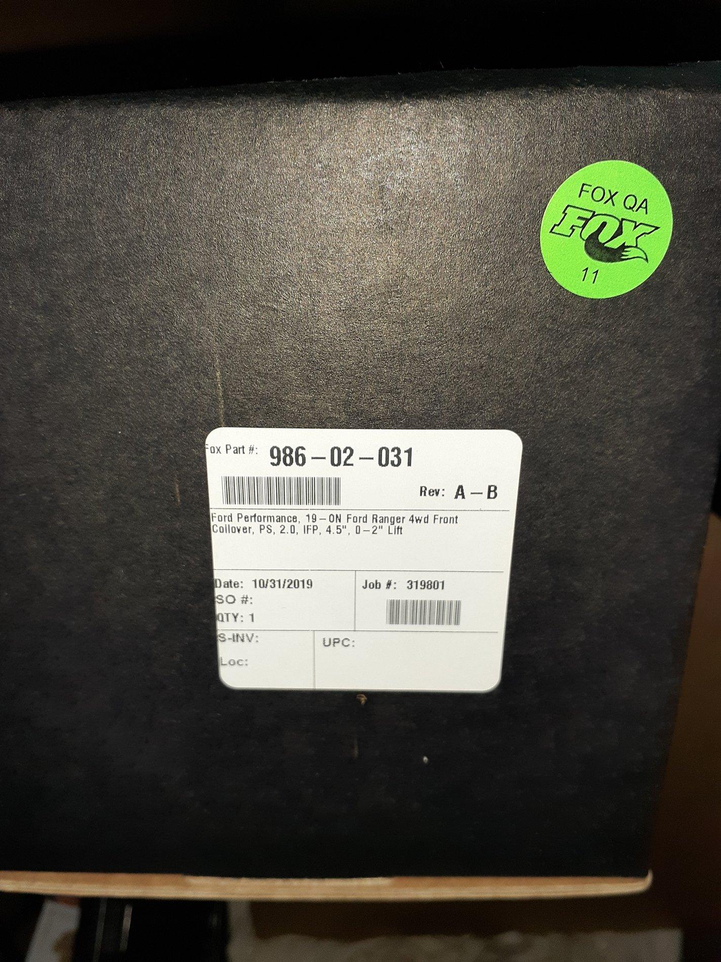

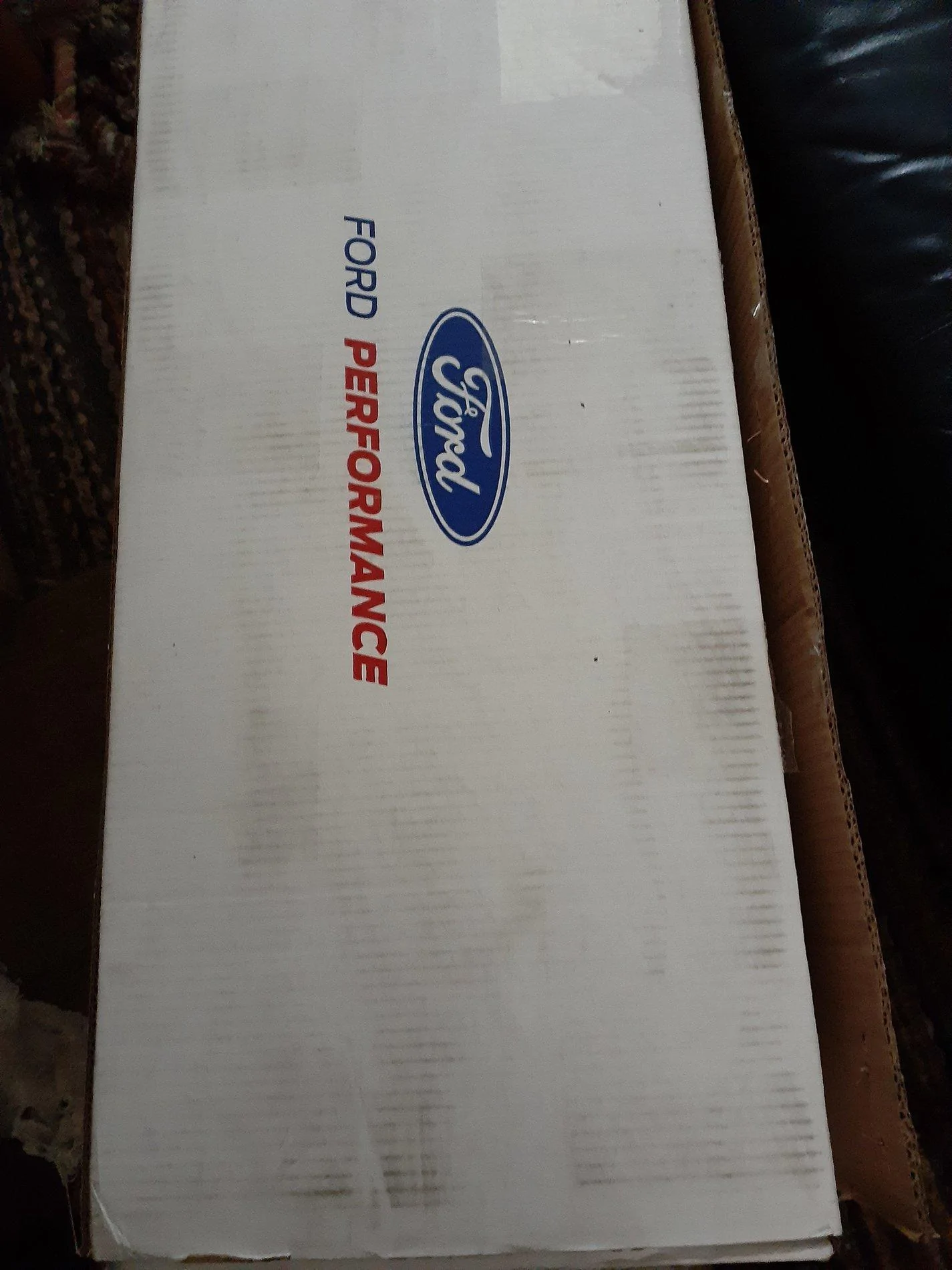

Now my Fox Ford Performance Parts kit comes tomorrow and hopefully can go on within the next few days and by the end of next week at the latest. Then comes the hunt for tires ATM Im thinking 265/65/17 BFG AT K02s and the wheels already on my truck with a 1in spacer.

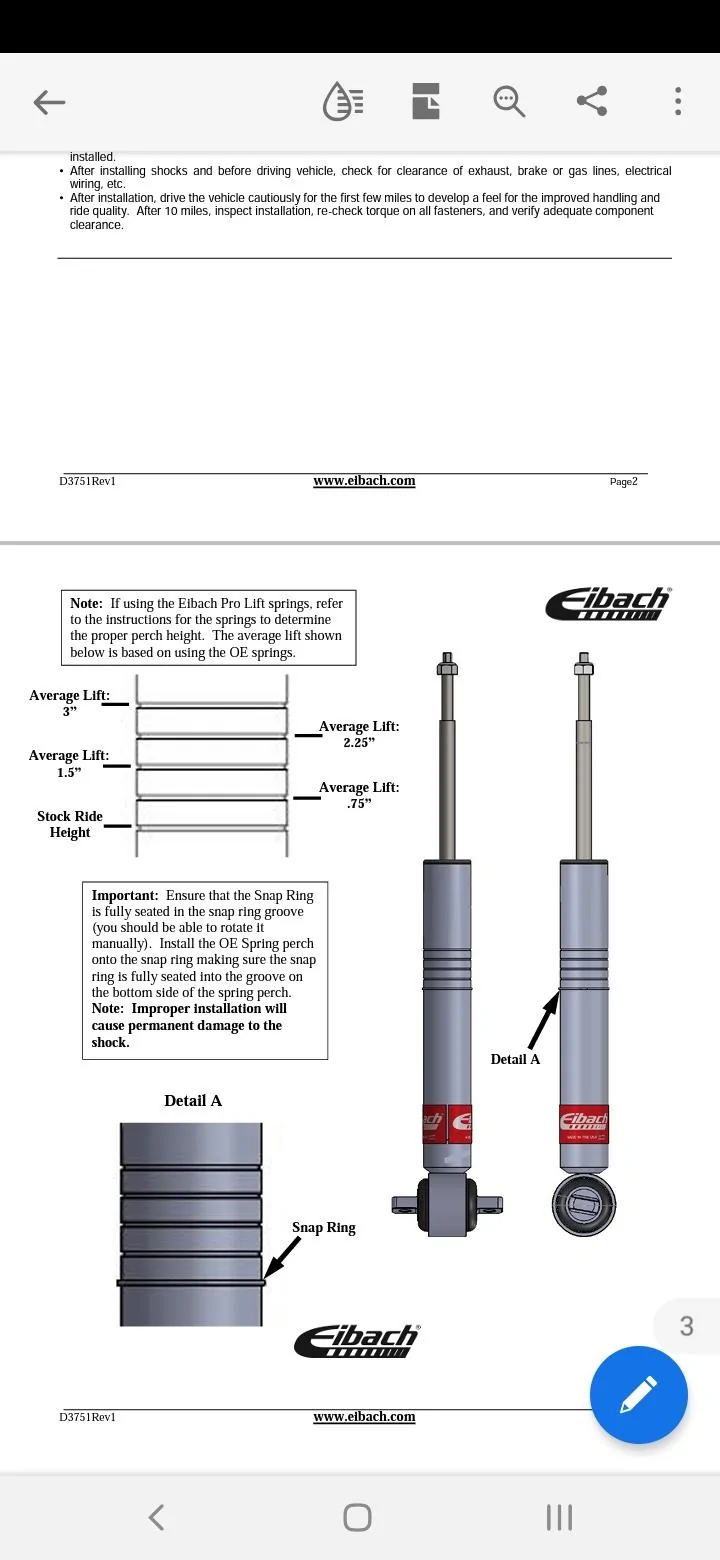

You know instead of being rude you could have just as easily shown proof. Eibach does not make it very clear on their website, nor does/did any outside sales companies that I spoke with or websites I read make it clear that the shock itself functions this way.
But according to Eibach's install instructions:
Apparently yes the Eibach shocks allow you to dismantle your factory strut system and allow the option when reassembling to alter the factory by using a snap ring to relocate the spring perch to a new position. So if you are have all the tools, a spring compressor, snap ring pliers and etc and do no mind that may interfere with your factory warranty using just the Eibach shocks linked by Roadboss does provide a nice value for $$$ spent and I would think makes for a nicer ride and handling then just installing a strut tower spacer.
So I was partially incorrect in my understanding and reading comprehension of how Eibach, Stage 3, and other vendors have said the SHOCK BY ITSELF functions. My apologizes.
Sorry if you think I was being rude, but I had already explained how they function, with a link to the product and installation instructions, and you directly contradicted me.
but anyway, as I already said, the fox/ford performance kit you bought should overall be a better setup so you should be quite happy with it.

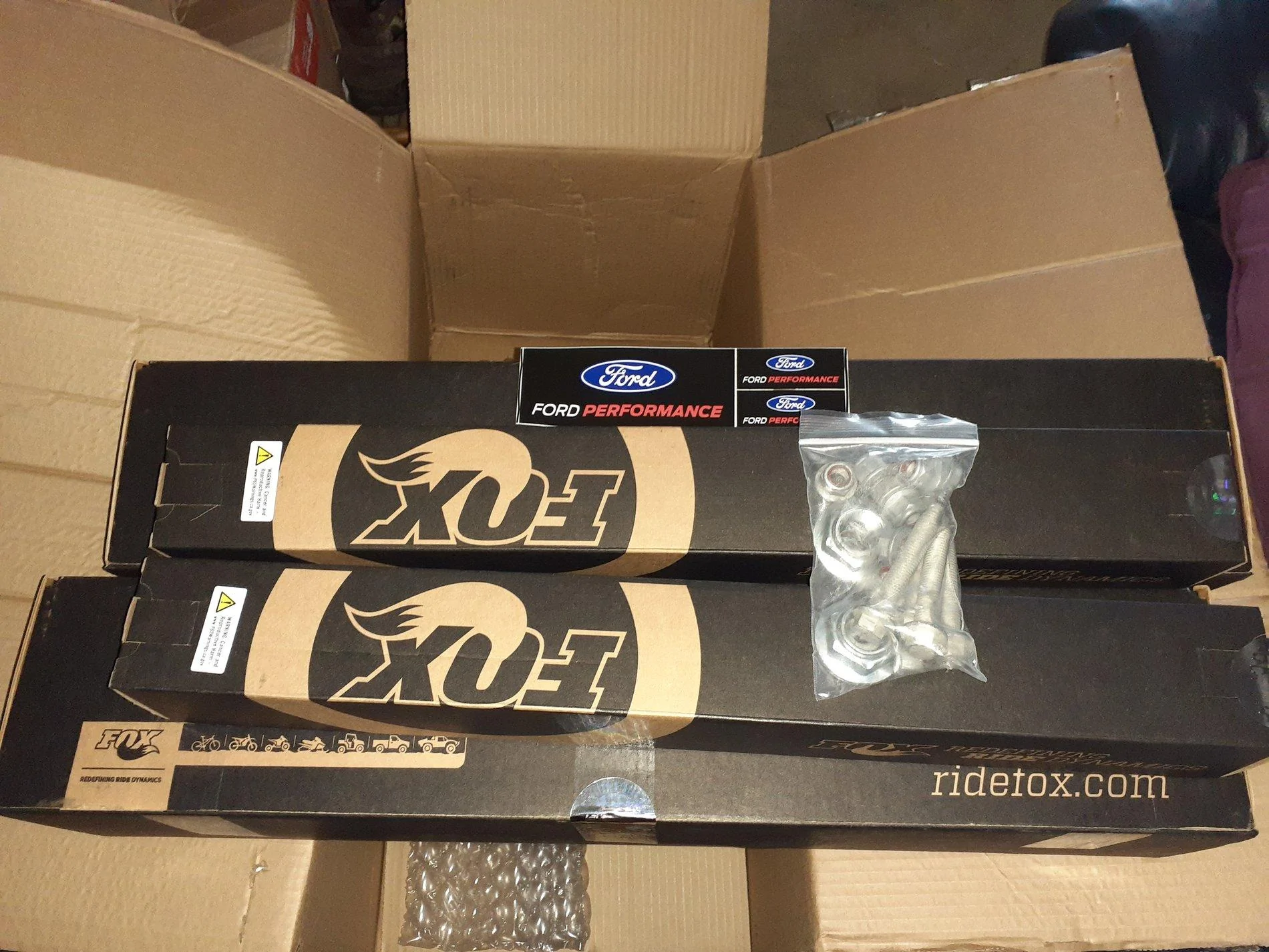

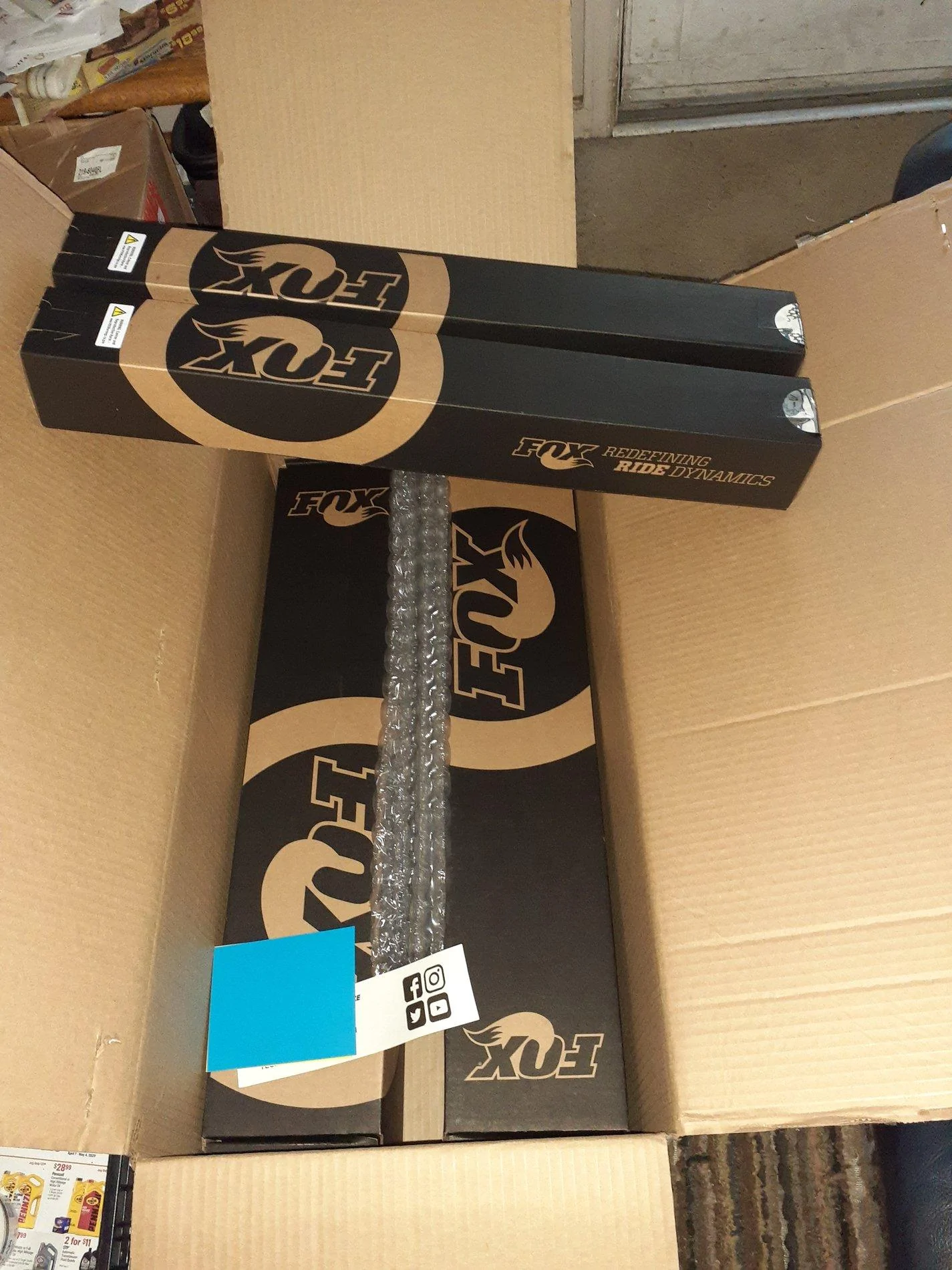

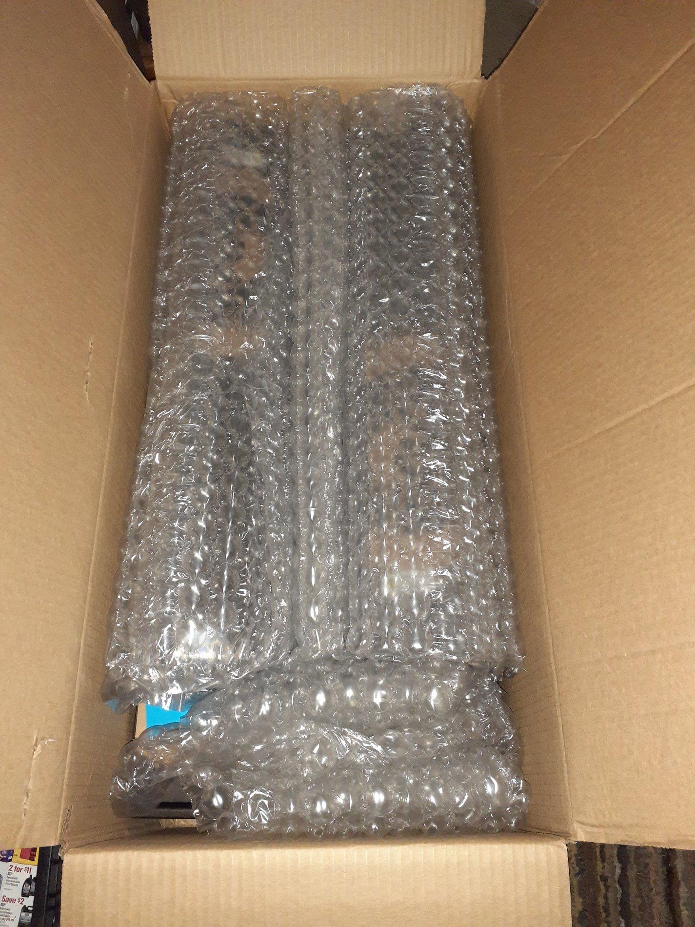

The lift kit is here the lift kit is here!!!!
Stay tuned for install pics!!!
WARNING EVERYTHING IS KNOWN TO POSSIBLY CAUSE CANCER IN THE STATE OF CALIFORNIA!!!
is it on yet? is it on yet? Lets see it!
LOL
He's not from work yet, but don't I didnt leave it just out in the middle of the living room floor for him as a hint that my impatience is growing. Hopefully it will be on soon. ( Maybe is gonna be "sick" tomorrow )
No worries if happens, in the information I read that was posted without reading the install instructions they did not make it very clear that the shock alone allowed for so much flexibility. And why would they, it costs then sales of their more complete kits.
Also being blonde and well a skim reader, i misunderstood the mounting locations reusing the factory bottom spring base as being adjustable and my brain just defaulted to spanner adjustable coilovers.
So to sum it all up:
Either kit/system will get you the desired 0-3in. of lift, the Fox/FPP kit comes set at 2in from the factory.
If you don't think you will be doing anymore off road driving then occasional snow, and gravel farm roads and are ok with possible warranty issues the Eibach shocks using your existing factory components seem like a very cost effective way to go although will take more labor effort and time as you must disassemble the factory coilover/strut assembly and rebuild it around the Eibach shock. But will save over $700+ in parts alone. ( Since most of these trucks are still new and low mileage reusing those existing components really isn't a big deal )
Now as for ride quality I cannot speak as to how the 2 compare, but keep in kind you will have the factory spring and spring rate with an Eibach shock only kit which may not firm up the ride quality very much, although the shock quality and valving will be of better quality then factory.

$1250 + labor for the Fox/FPP kit.

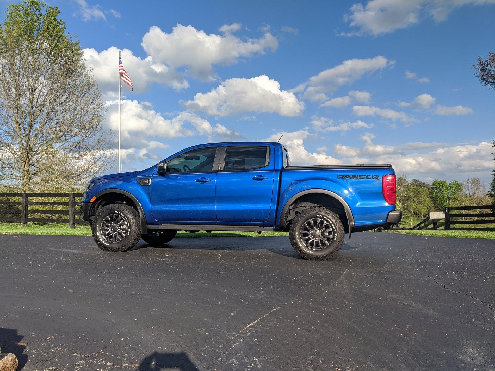

They left mine set at stock height setting, It is actually just a bit under 2", but I am very happy with it. These are 265/70R17 on stock rims.
It is good to have an ASE certified friend. Sounds like a nice steak dinner might be in order. :)

They left mine set at stock height setting, It is actually just a bit under 2", but I am very happy with it. These are 267/70R17 on stock rims.

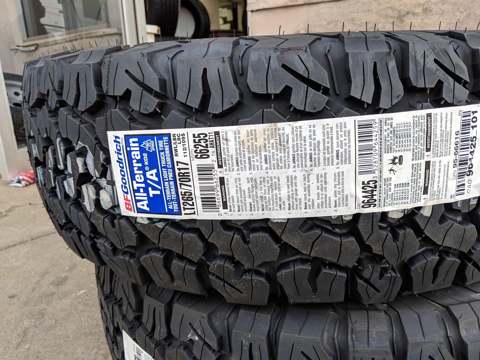

Awesome thats exactly the stance I am looking for, get rid of that front end sag and make it look mostly level. Are those the AT KO2s?

Those are the tires I want I think with a 1 or 1.5 inch spacer to push out the factory wheels they will GREAT, where did you get them and what did they run ya piece?
