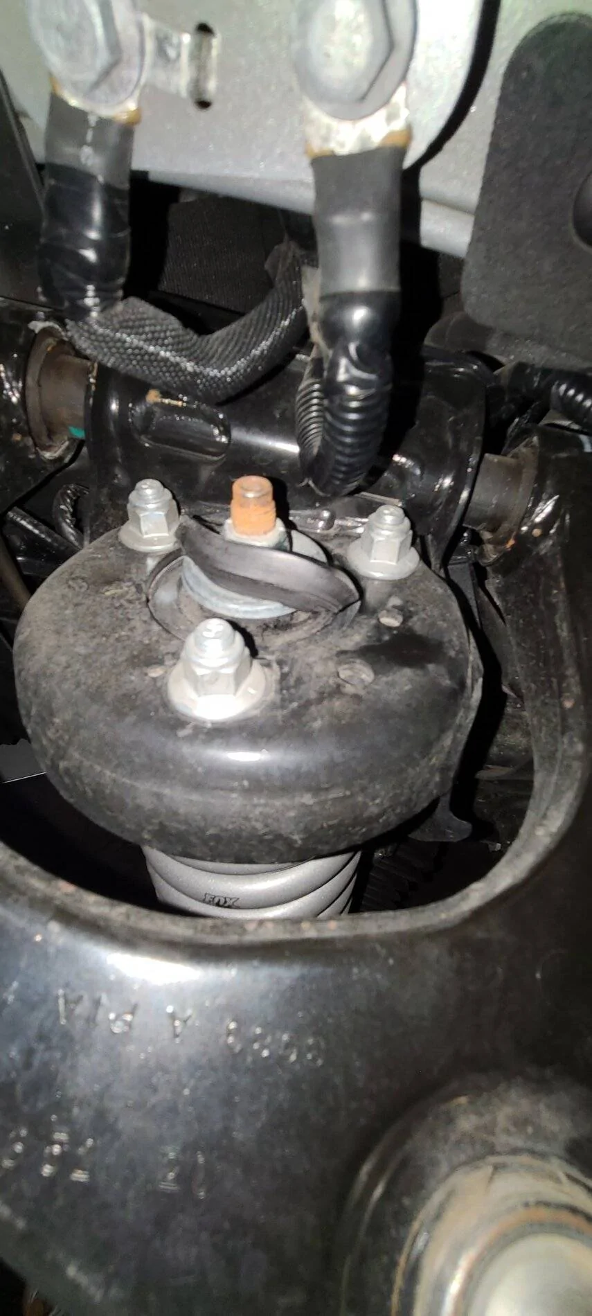

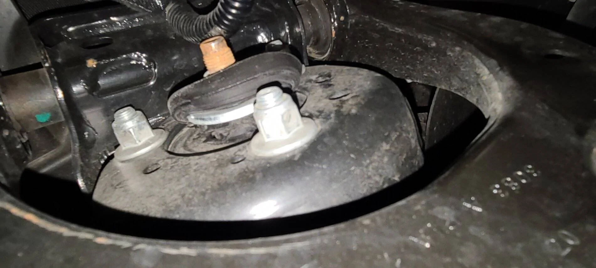

I need some pointers as I heard some squeaking from my front coilover, after installing them 4 months ago. Took a look and noticed the upper bushing had split and had started coming off the top.
I had a hell of a time installing the coilovers in the first place and would prefer to change out the bushing without removing the coilover. Is this possible? Can I change it out with the truck's weight compressing the spring? Excuse my ignorance and I appreciate any tips. Pics below of the bushing and what I believe is the correct replacement parts. Thanks again!

You're gonna have to pull the coilover, compress the spring, and replace the bushing.
A better idea would be to pull it and ship to Fox. You could pick up a cheap spacer level to install on your factory setup to tide you over.

Just a quick update... I received the replacement bushings washers and nuts from Fox. It was a lot easier than anticipated. I'm assuming since it's so new. I was able to remove the locknut that was securing what was left of the upper bushing by using an Allen ratchet to secure the shock piston while I loosened the locknut with a wrench.
No issue at all. The nut came right off along with the old bushing and washer. The new ones went right on and I tightened the nut, counting the threads to make sure it went on the same as before. Job done in about 15 minutes. The coil didn't fly out as the weight of the truck was securely holding things together. I was shocked at how easy it was.
