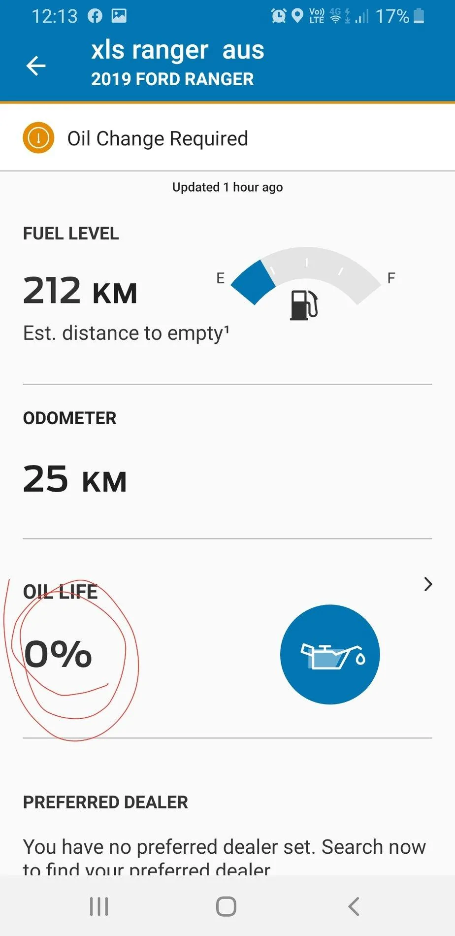

just picked up my ranger from Ford for it 30k service and to have the dash cluster replaced.
Can anyone tell me does the oil life reset by it's self like the klms and fule.
The all reset besides the oil life it hasent reset to 100%.
I can't tell if it hasent reset rite or ford skipped my oil change.
I looked at the sump doesent look like it's been changed.

More than likely the tech did not reset it on your instrument cluster. The app will reset automatically when the oil life is reset on the cluster. It may take a few hours for the app to reset after the cluster is reset.

I didn't have the oil life reset in my cluster setings I had to add it with forscan.
We don't get fordpass app in Australia.
I used a 3rd party app downloader to get fordpass it works ok but remote start won't work
