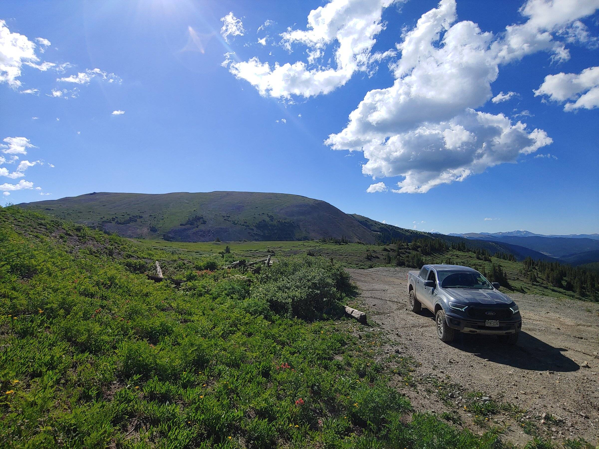

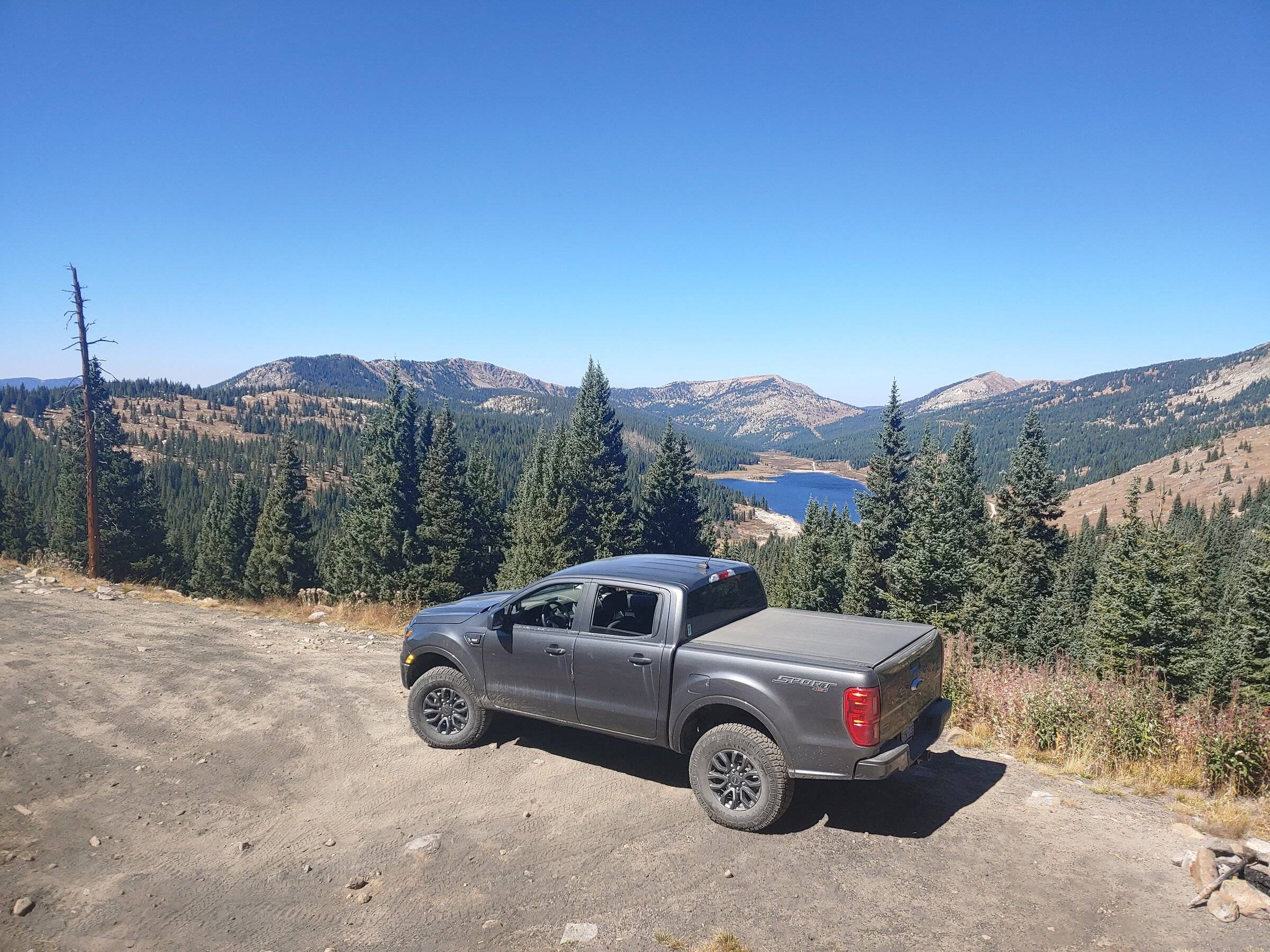

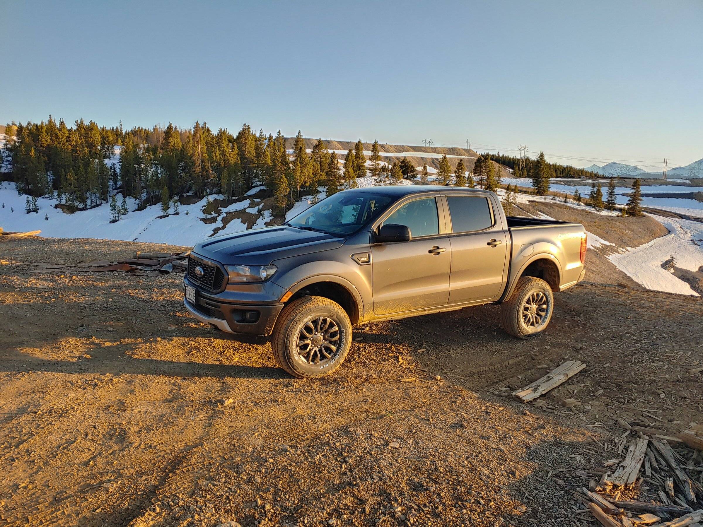

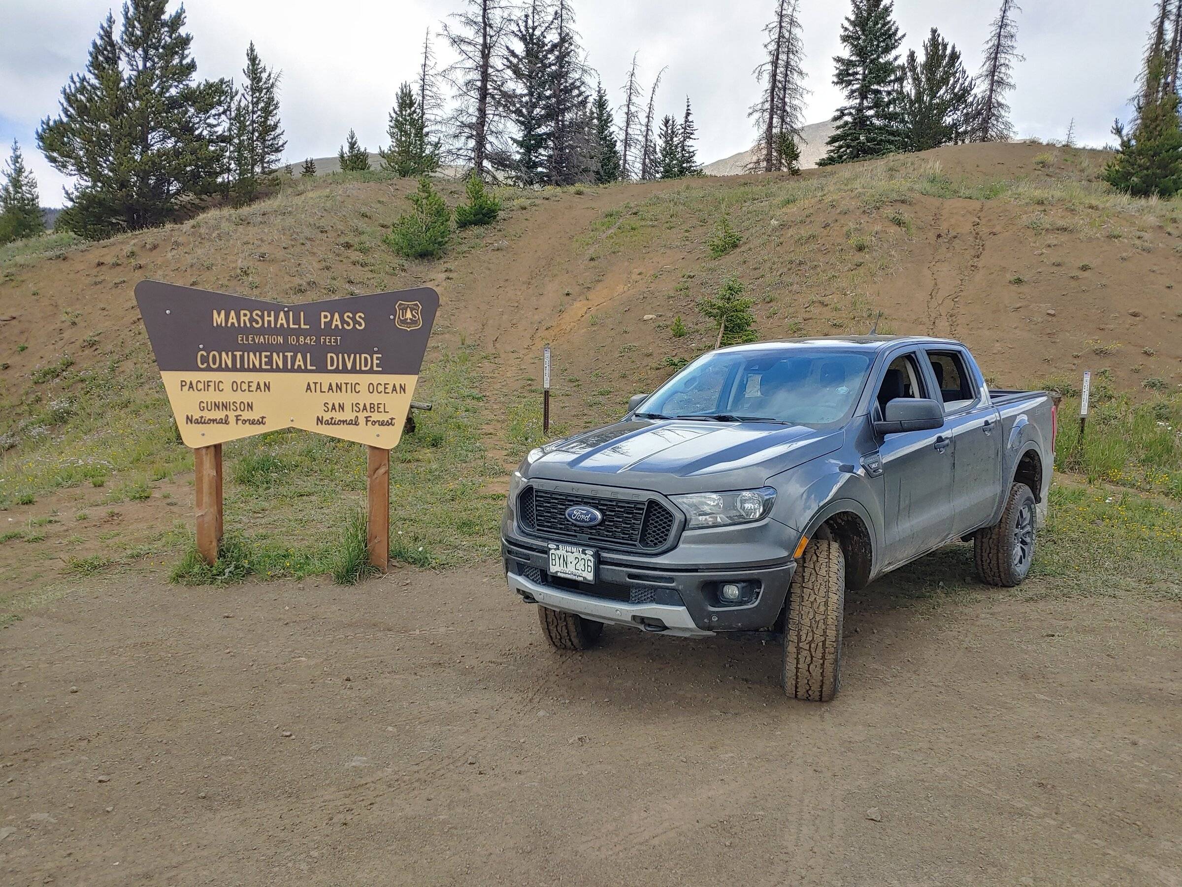

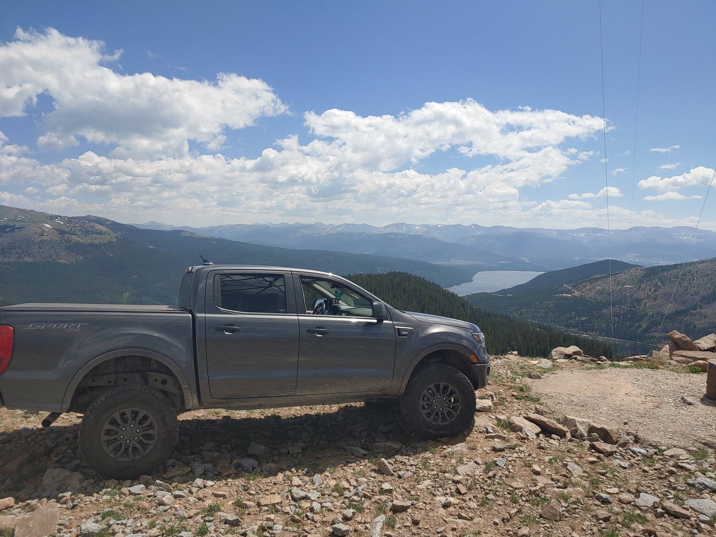

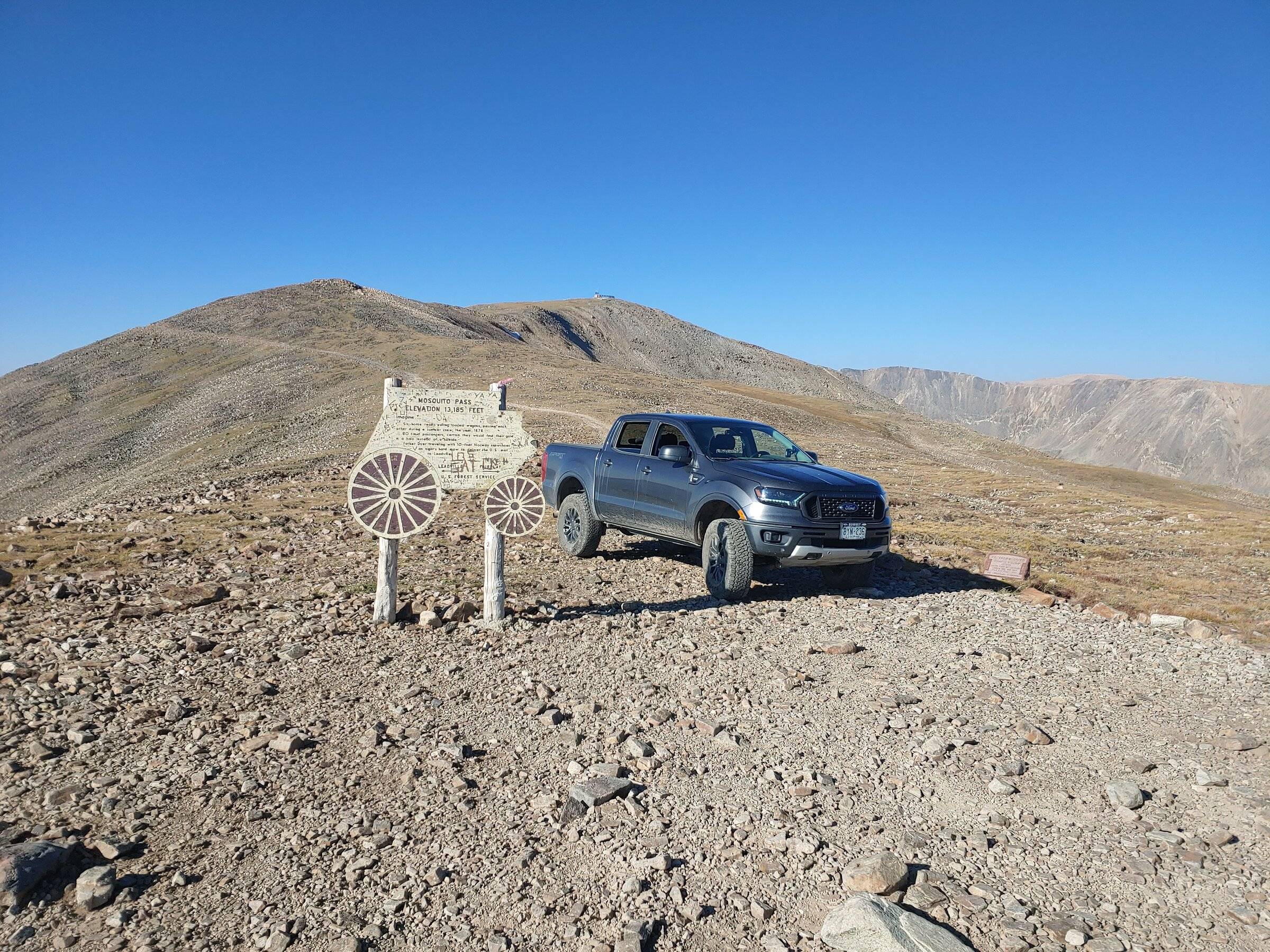

Below are some pictures of my truck with the Old Man EMU lift with 265/70-17 and 285/70-17 tires.
32 inch tires and towing roughly 5,500 lbs. I think the toung weight was closer to 75p at this time
Within the first couple of wheeks of getting the 32's and lift installed
Have 33's in this and I delt with a heavy rock garden befor this
33's here
Also 33's
Pretty sure this was the first day or two after getring the 32's installed
33's
33's a day or two after install
32's, a fun trail but should have aired down to say the least
The beautiful Firestone Destination XT's tread pattern. My 33's
33's again
32's here
32's here

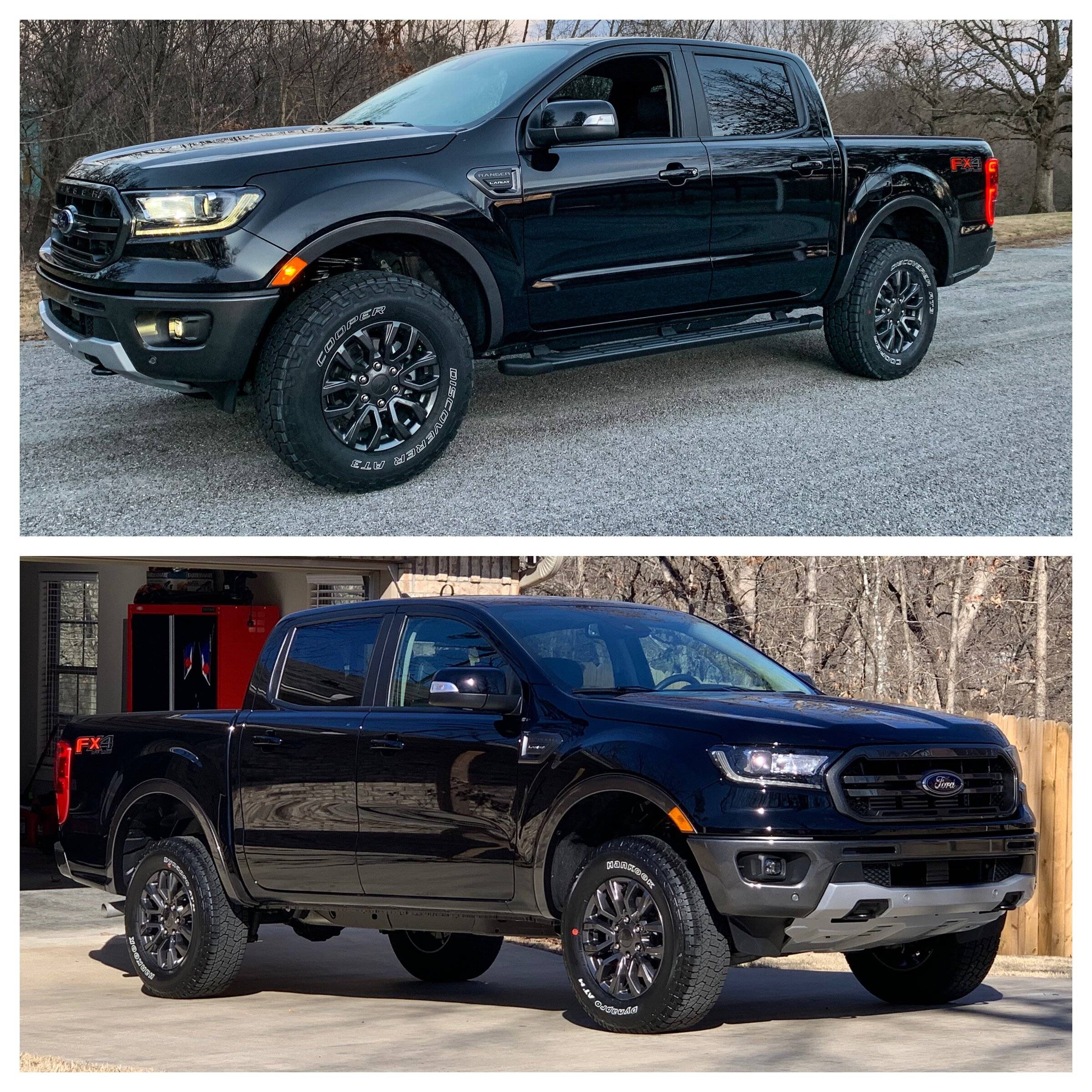

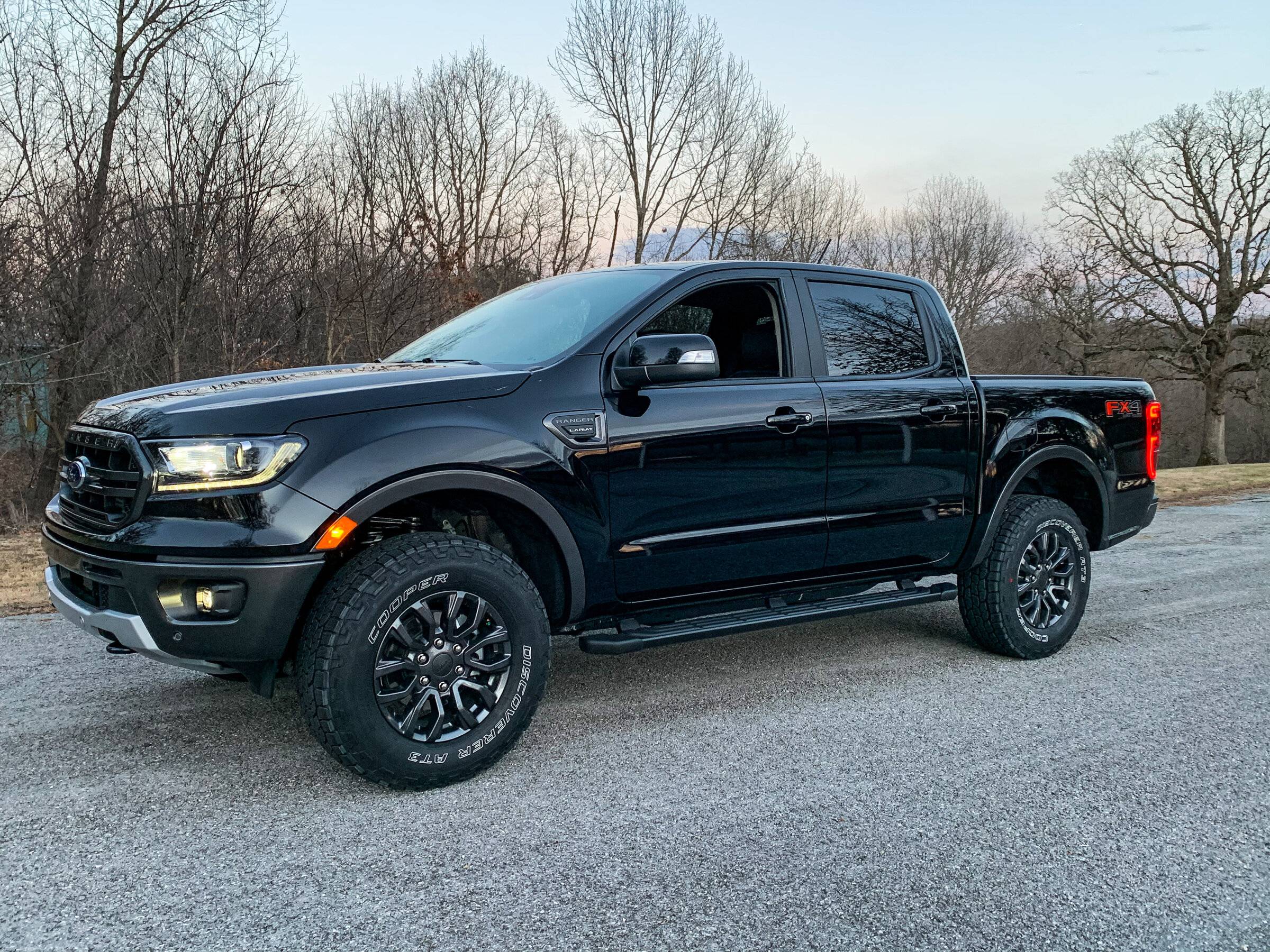

Apologies if this has already been answered, but I cant find it and didn't wanna take over someone else's thread. Basically, when my tires wear out, I am looking at going up a size to lt265/70/17, as there are not nearly as many tire options in the size lt265/65/17 and I think a slightly larger tire with more sidewall would look better. Along with that, I am looking at using the Ford tuned Fox shock leveling kit. Based on what I've read on here, that seems to be one of the most popular options. I dont mind the Fx4 Shocks at all, but I want to ensure there will be absolutely no rubbing/scraping with a size up tire. My question is that if I am towing something/hauling something in the bed moderately heavy, would the front of the truck begin to tilt up? Because of that I am wondering if the shocks can be adjusted to keep the same rake as the fx4 shocks provide, but just higher up.
I installed LT265/70R17 Cooper AT3’s on my second day of ownership and had zero rub or issues. Truck was bone stock otherwise. Actually rode 2x better on the larger coopers.
