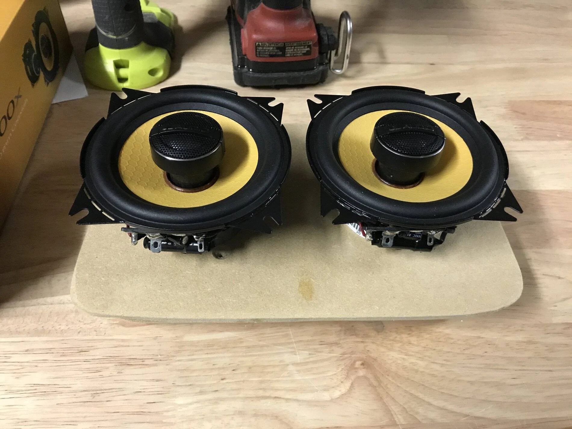

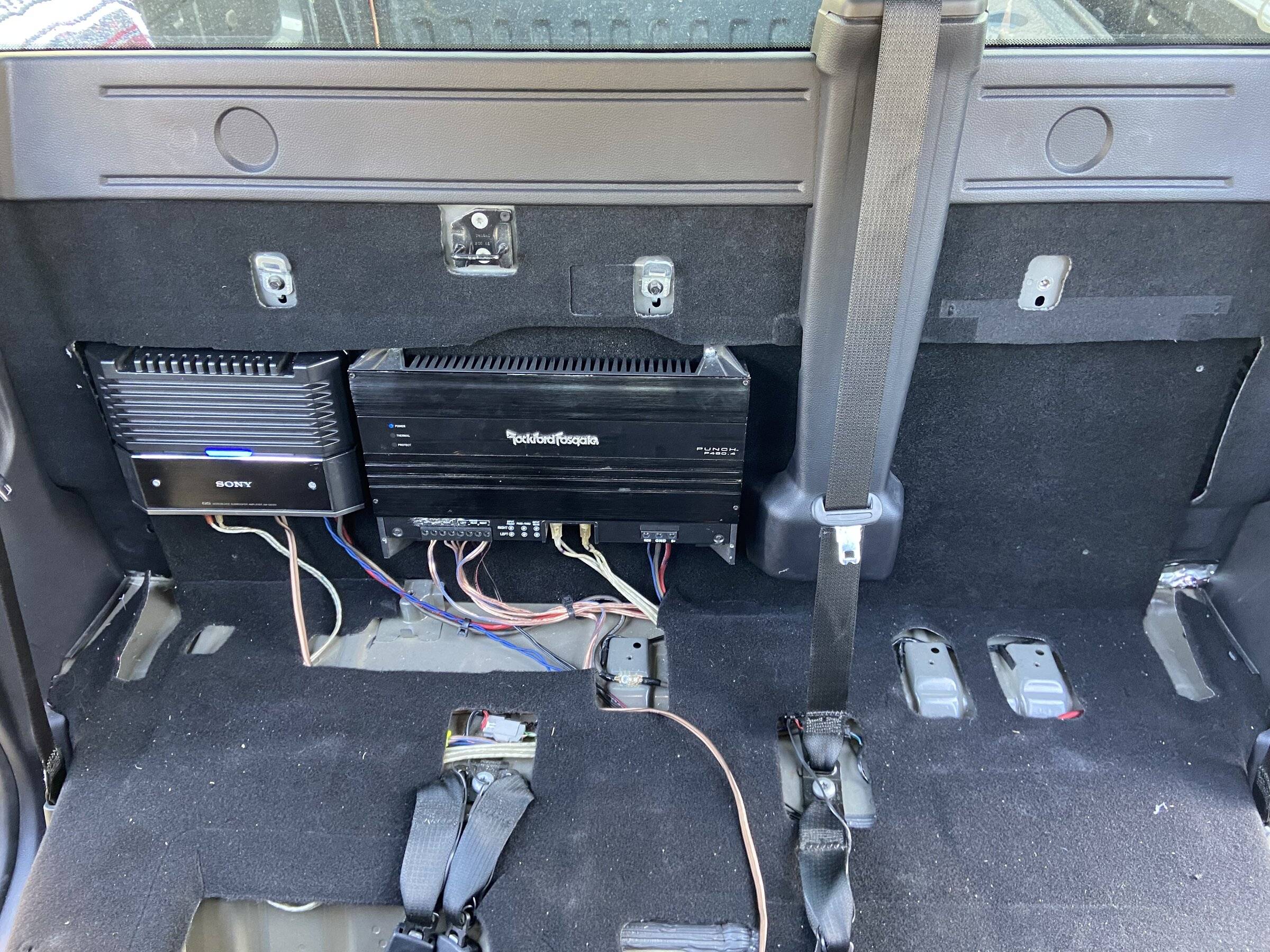

Changed out my rear coaxials with Skar 8 inch mids and some 30yo mbquart tweeters I had.

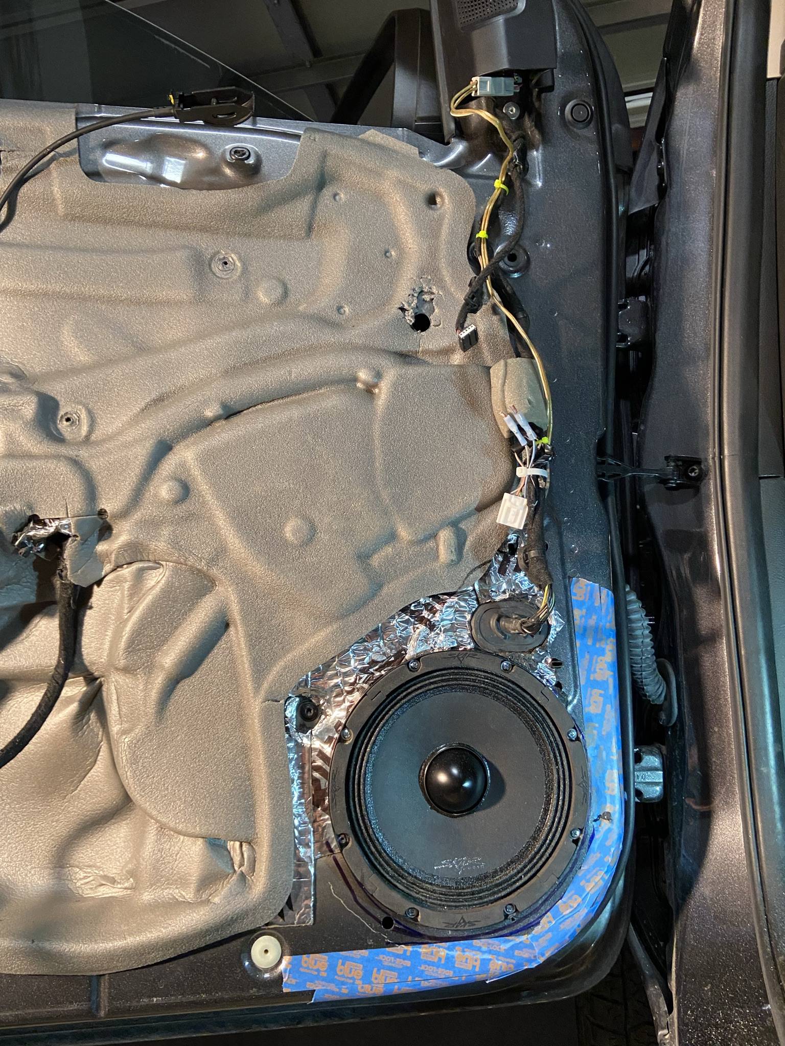

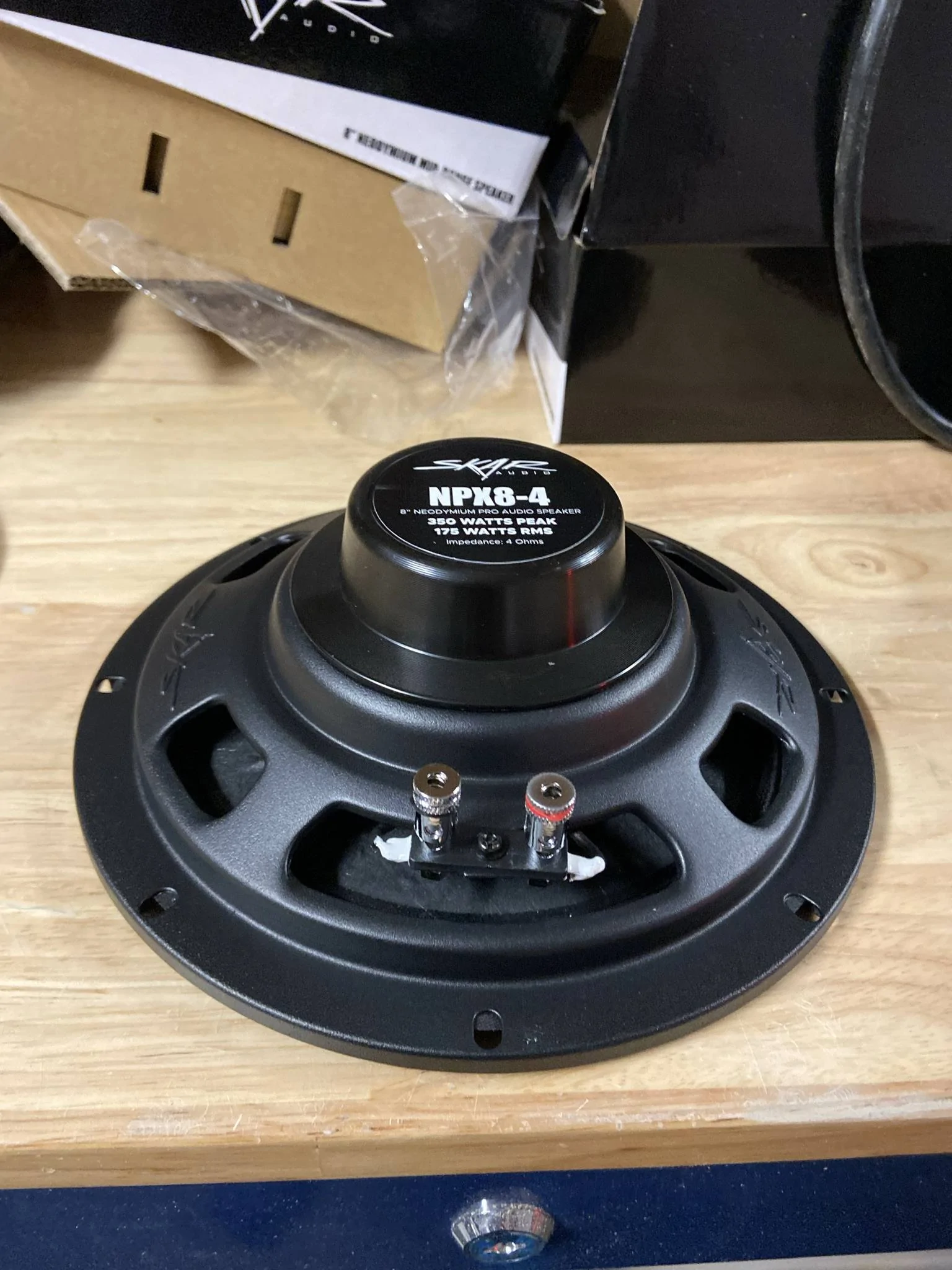

After several attempts I was able to squeeze some 8inch Skar Audio in my front doors. I didn’t know about their NPX series with neodymium magnets. That made it all possible. I had to cut the door perfectly or it would hit the edge of the door panel. A little sweating involved.

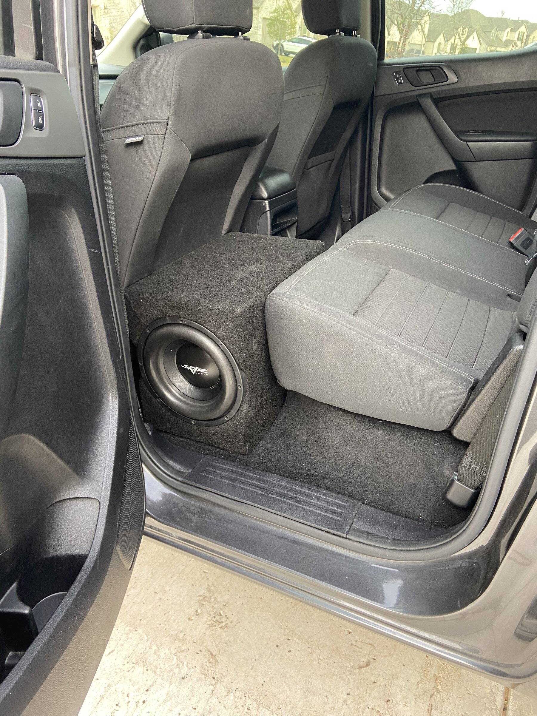

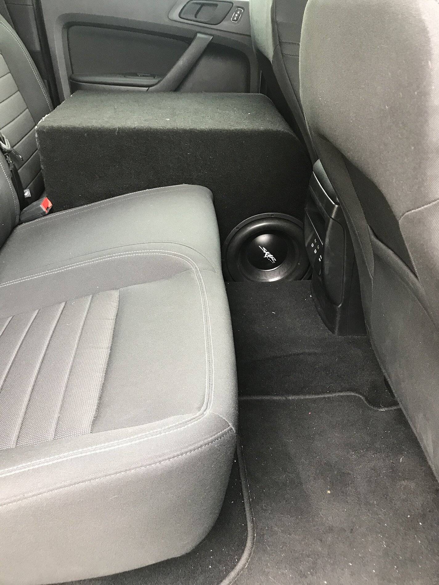

Built this box for road trips. Need that seat for the dogs.

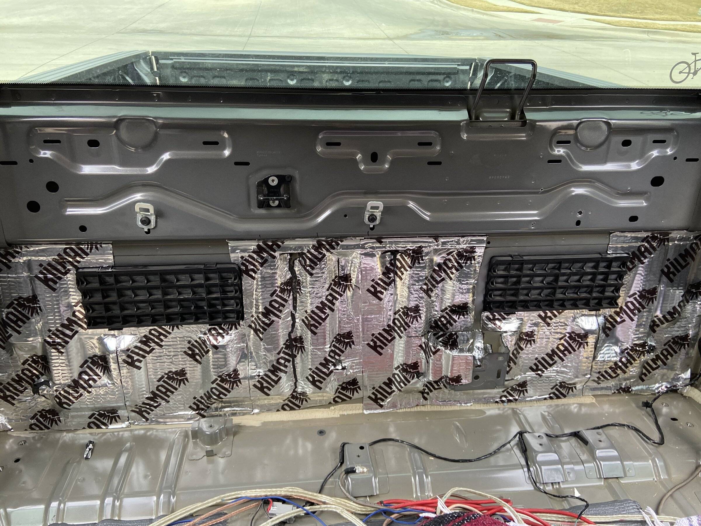

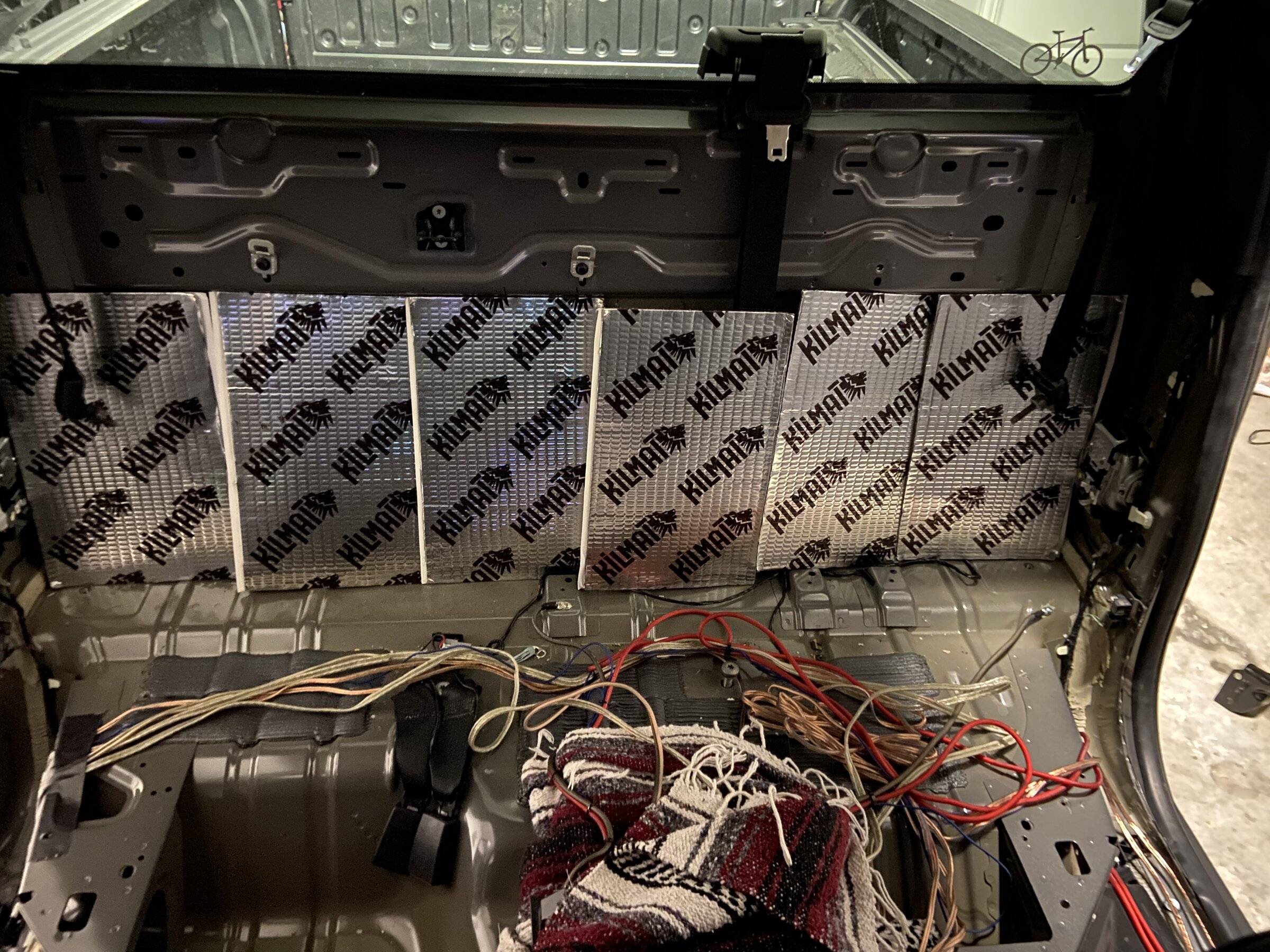

Next phase is sound deadening the rear and those exhaust flaps that make a lot of noise under loud bass.

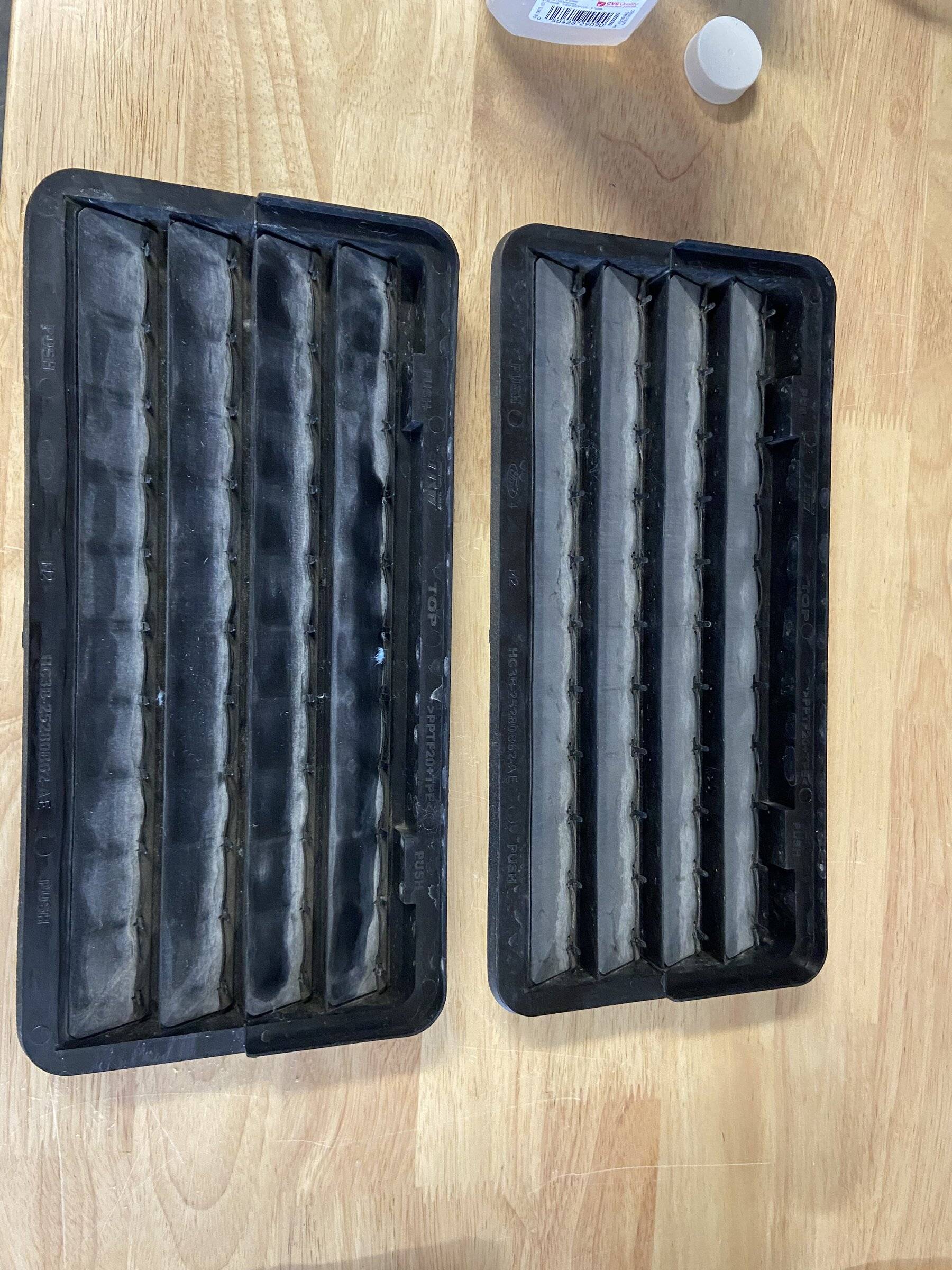

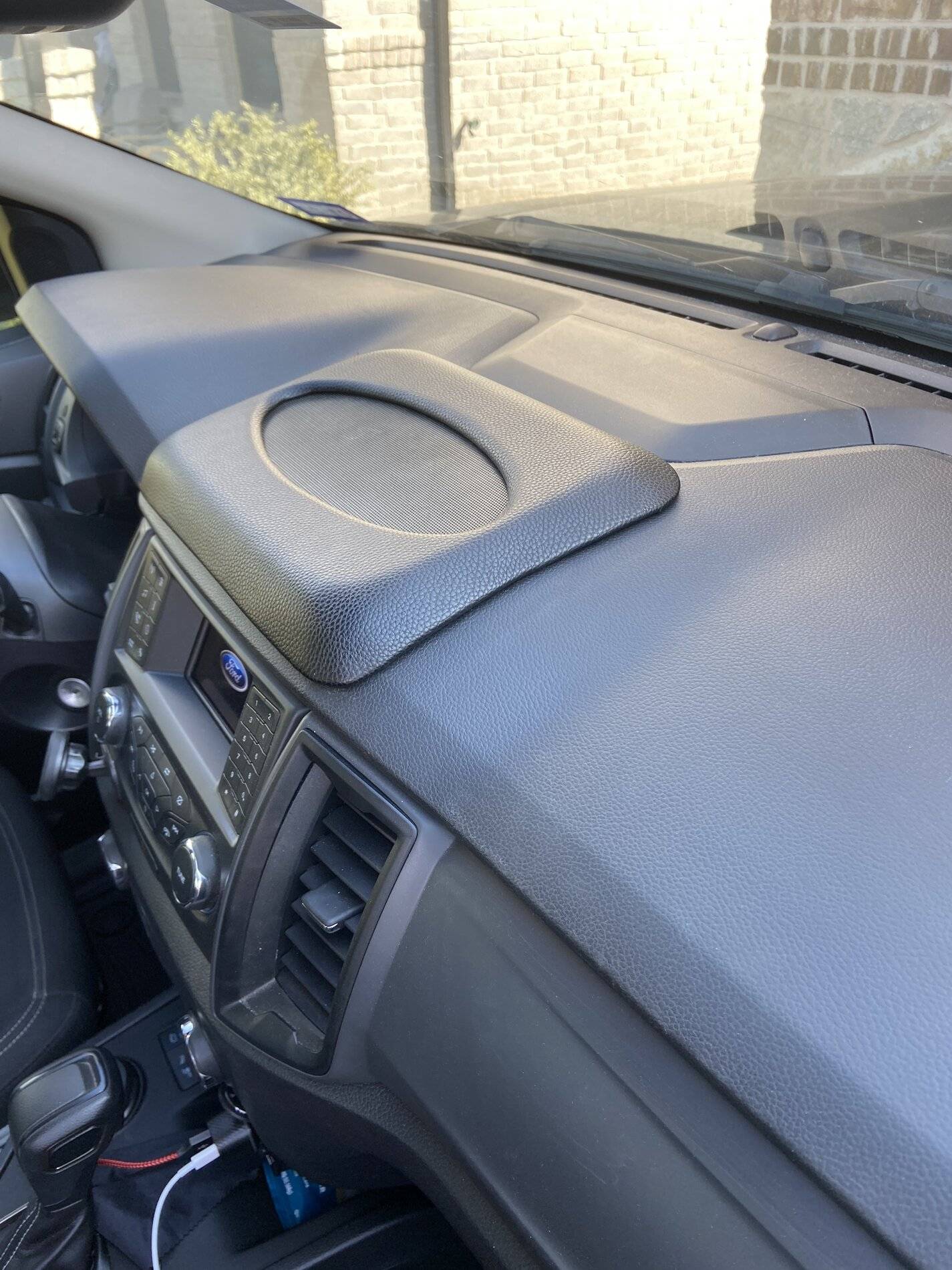

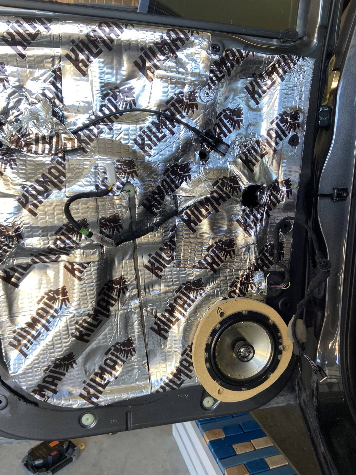

Attacking those noisy vents.

Factory Automation Engineer, Auto School Grad, Car Audio Tech

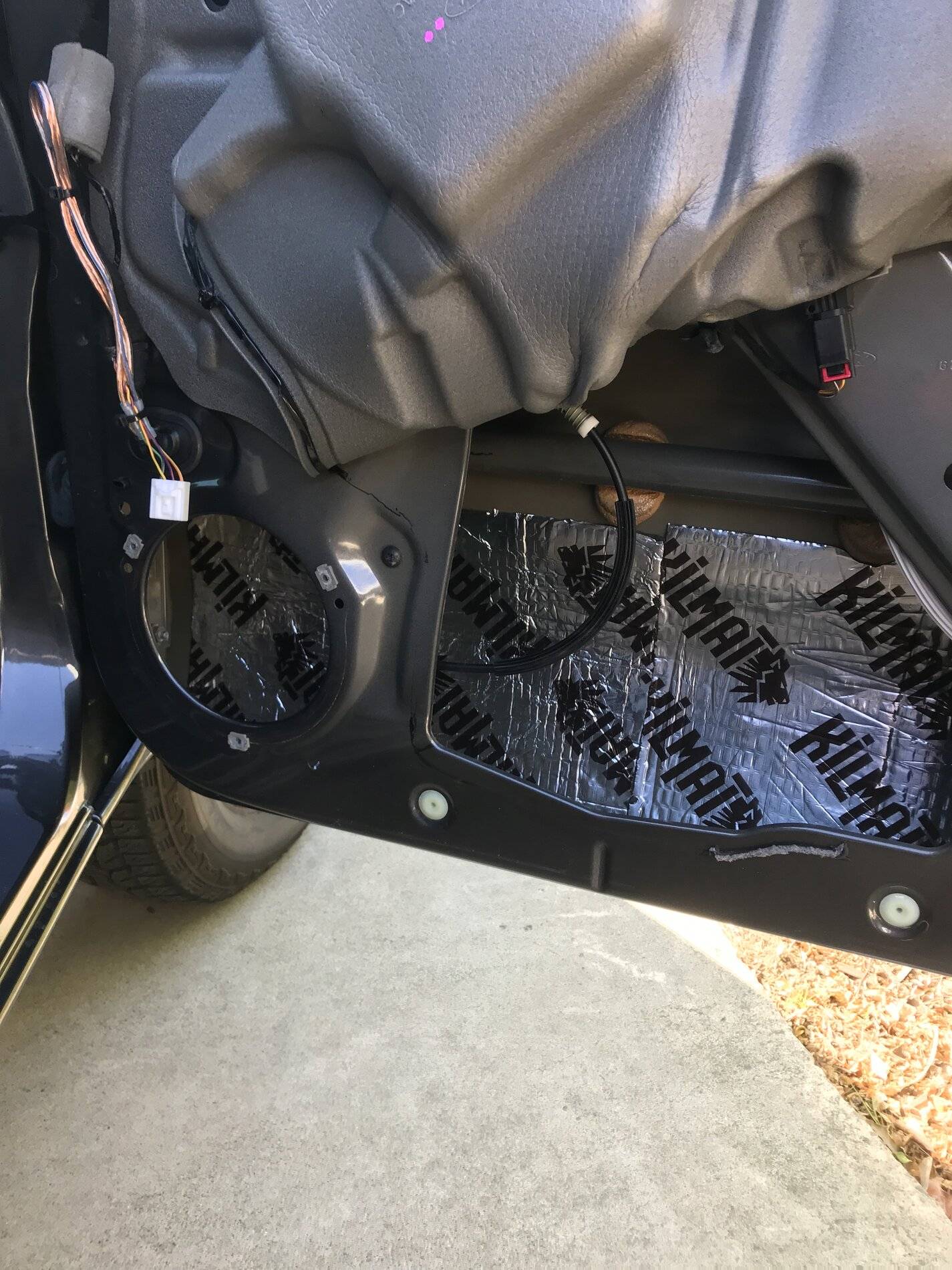

Finally did it right. Was in a rush first time around.
