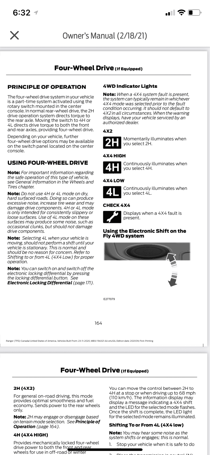

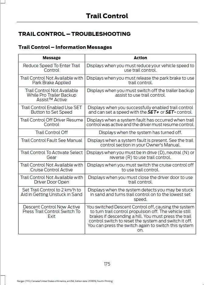

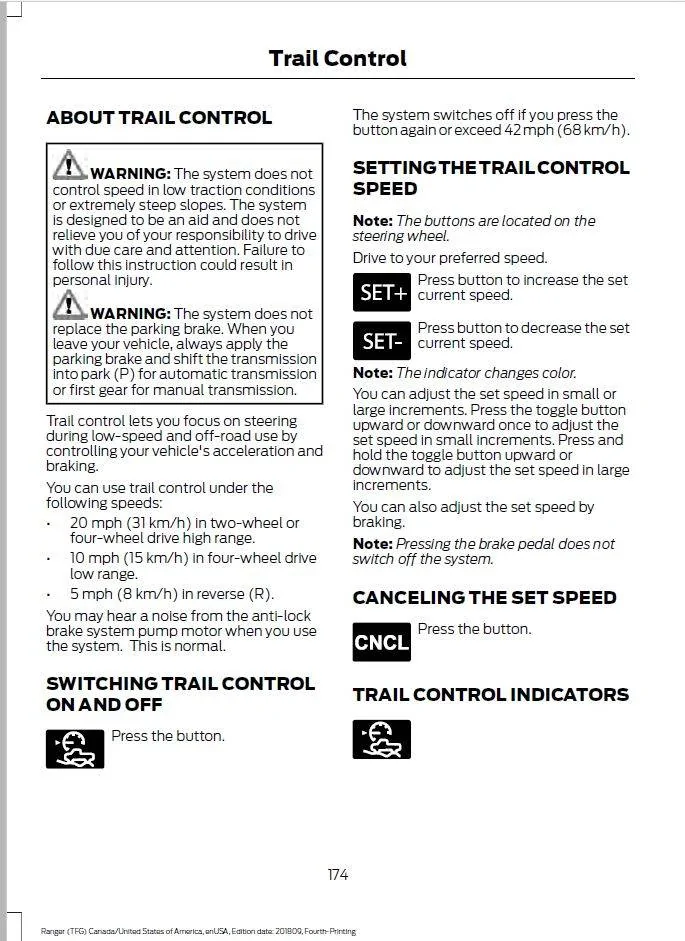

Hi Mike,
Not sure this will help from the owner's manual
