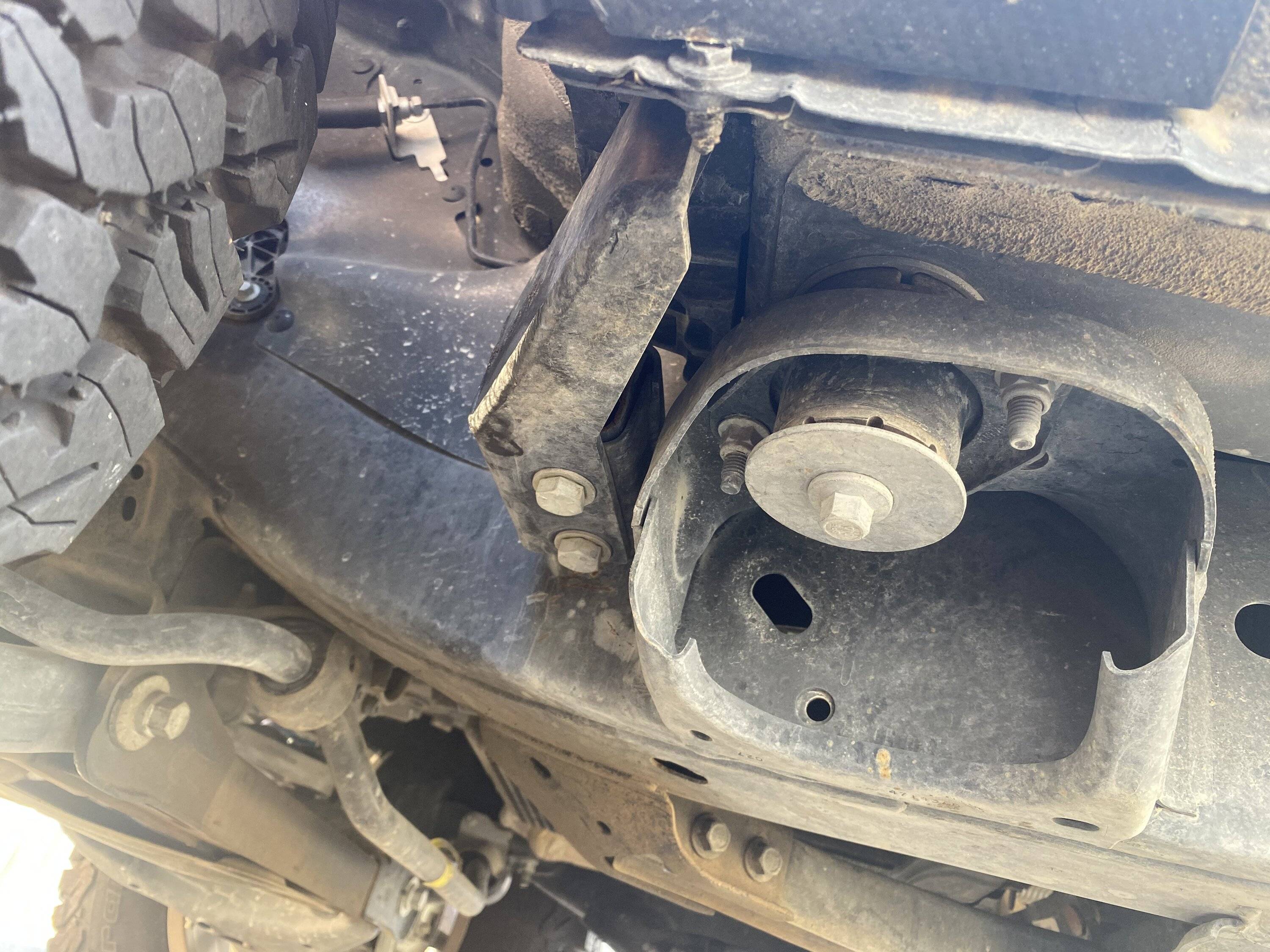

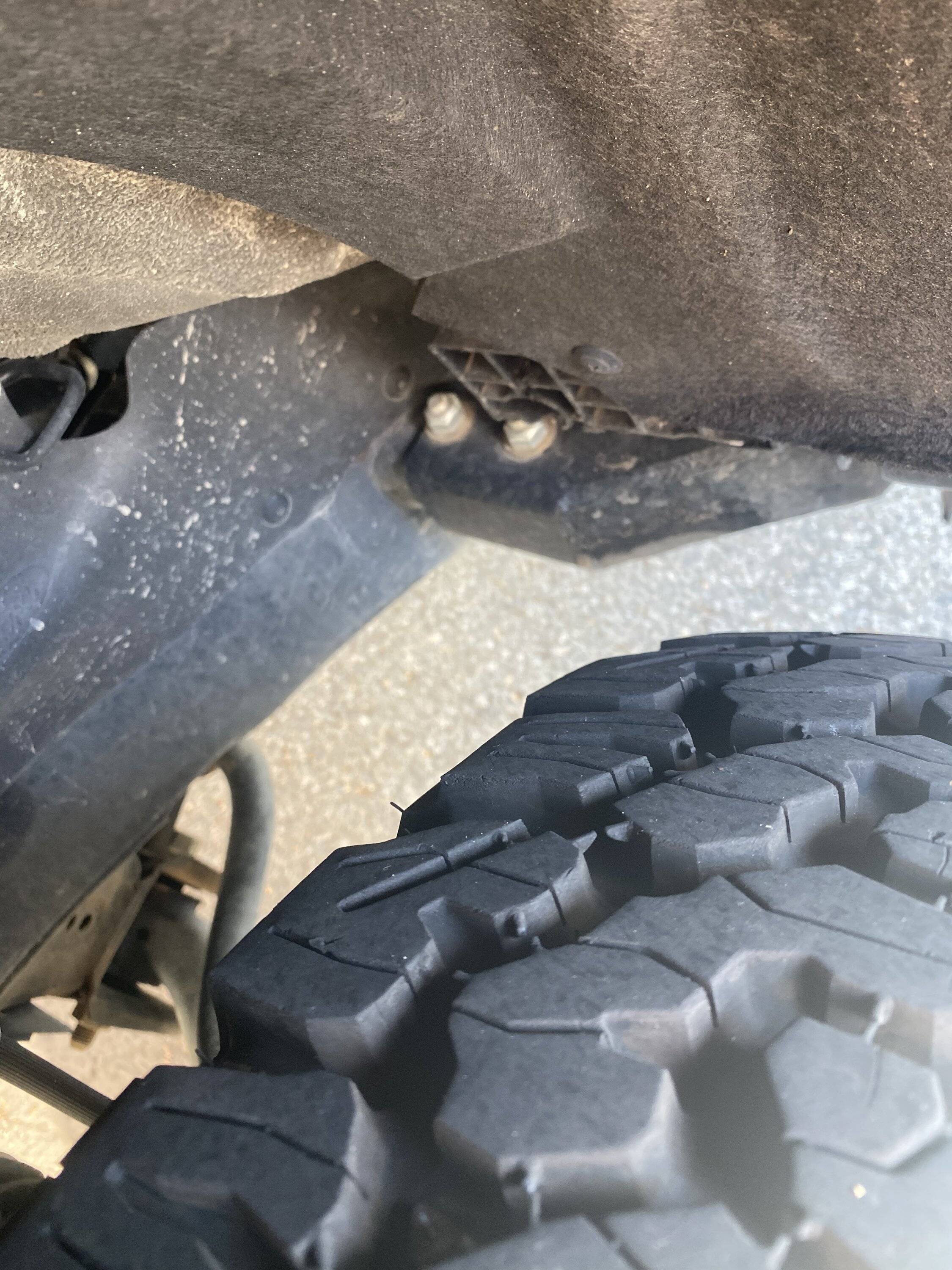

Here’s some photos of the rubbing i think if i removed the Fabtech kit which pushes the beam back i‘d still rub but it‘d be on a sharp corner

Ok, thanks for the help I'll get to cutting! I asked my local shop if rock sliders would serve the same purpose he said they would. If anyone has any objections, speak now or forever hold your peace.
Or you can unbolt and slide them out...

Ok now i‘m thinking ill remove the fabtech pieces as a test to see how the rubbing looks. I‘m considering downsizing for my next set but these tires have a lot of life left in them. I‘m wondering how people run 35s do they just push the tire out super far or cut everything or just live with the rub? I like the 0 offset and my stance but maybe i‘ll go to spacers. Sliders were going to happen regardless but I won‘t think of them as a replacement for the rear intrusion beam.

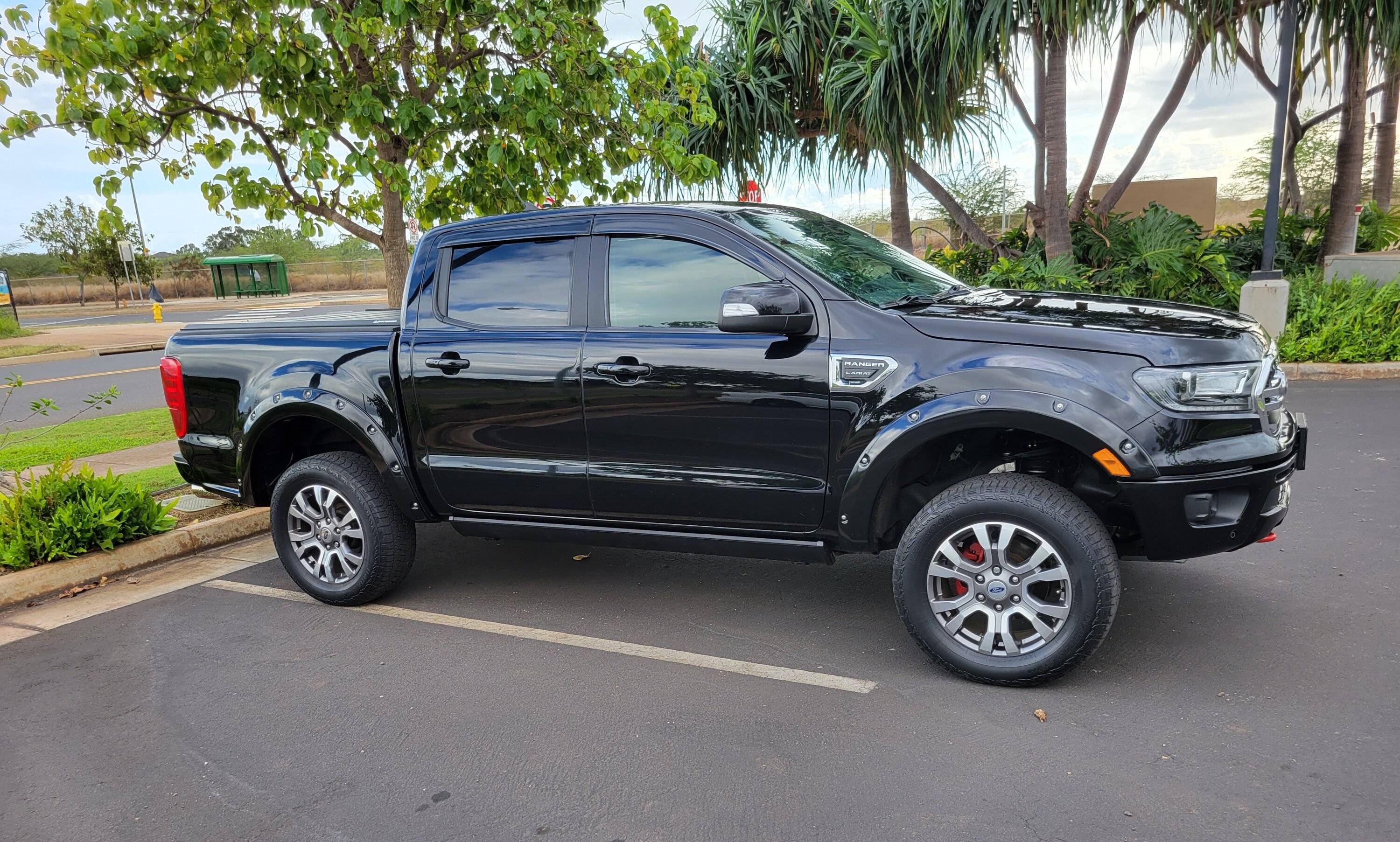

'19 Lariat, DIY BOV, 2.5 Leveler, MBRP 3" Exhaust
Just another incredibly super average dude
I would highly recommend visiting the Tire Calc website
It's an incredible tool where tou can compare sizes and fitment. Keep in mind, if a tire is 2" bigger, you divide that across the center of the rim so your only getting an 1" closer to hard parts. https://tiresize.com/calculator/
I'm running 1.5" spacers and a 2.5" keveler kit. The crash bar removal was easy, with a grinder (not a reciprocal saw), the use a crow bar to bend it down to clear the bumper, or fender..
