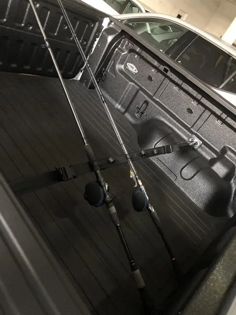

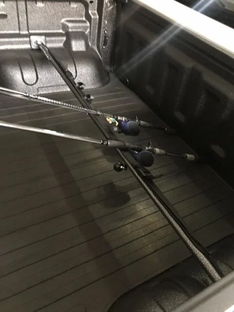

Not sure if I’m posting this in the right section so my apologies if it belongs somewhere else. Just got some parts in today to try and organize my fishing poles in the bed. Very simple install and it works well.
This is what you’ll need if you wanna go down this road...
1. Keeper 05056 telescoping cargo bar
https://www.amazon.com/gp/aw/d/B00002N9G3?psc=1&ref=ppx_pop_mob_b_asin_title
2. Vehicle fishing rod holder
https://www.amazon.com/gp/aw/d/B07W6J6P1P?psc=1&ref=ppx_pop_mob_b_asin_title

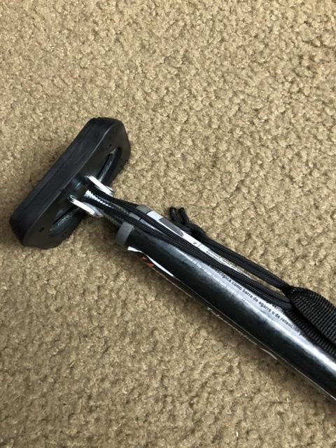

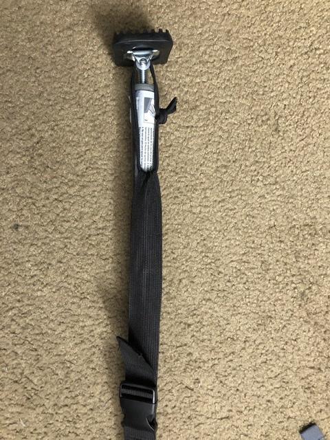

3. Paracord
Make 2 loops with the paracord on both ends of the cargo bar to act as an extension for the rod holder strap. Tighten the cargo bar in the bed wherever you want, then tighten down the rod holder straps. I haven’t had any issues with poles moving horizontally but the rod holder straps come in a set of two, worst case scenario I plan on using the second strap in the bed somewhere towards the middle of the rods.
