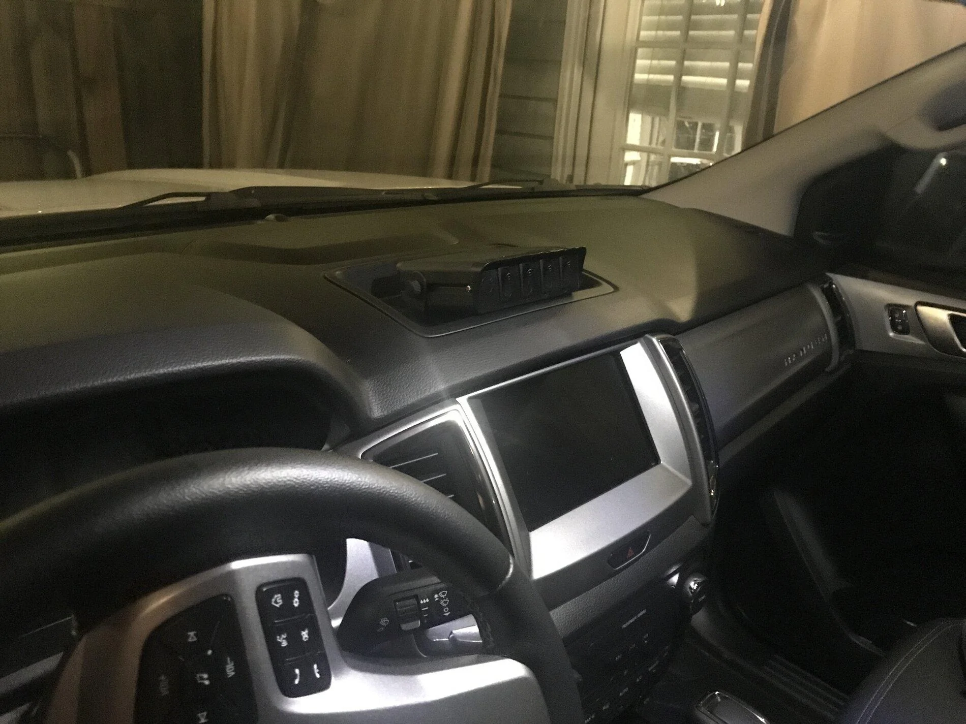

Fishing wire through dash tray.

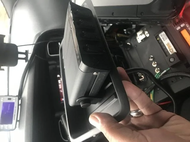

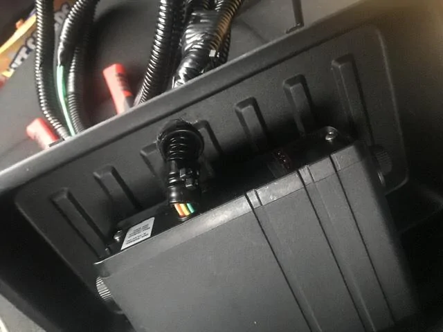

Holy shit do you want to talk about a pain in the ass because this was not a single wire for a cell phone charger but a loom of wire I basically had to trim out underneath the dash tray where the supports are so that it would sit flat. More or less had to drill/cut out a channel for the wire to rest in and had to completely strip away the wire loom at that small section for clearance. I then routed it down the driver side of the console to where my connection wires already existed that come up through the driver floorboard.
