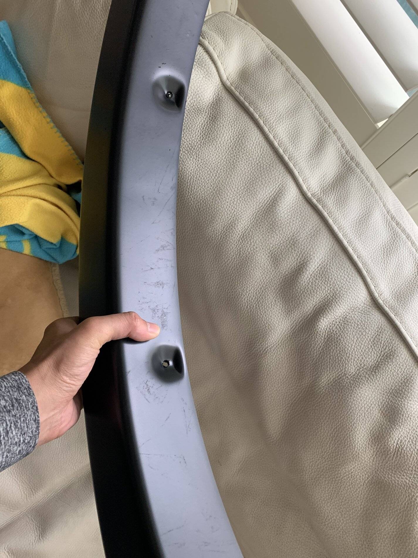

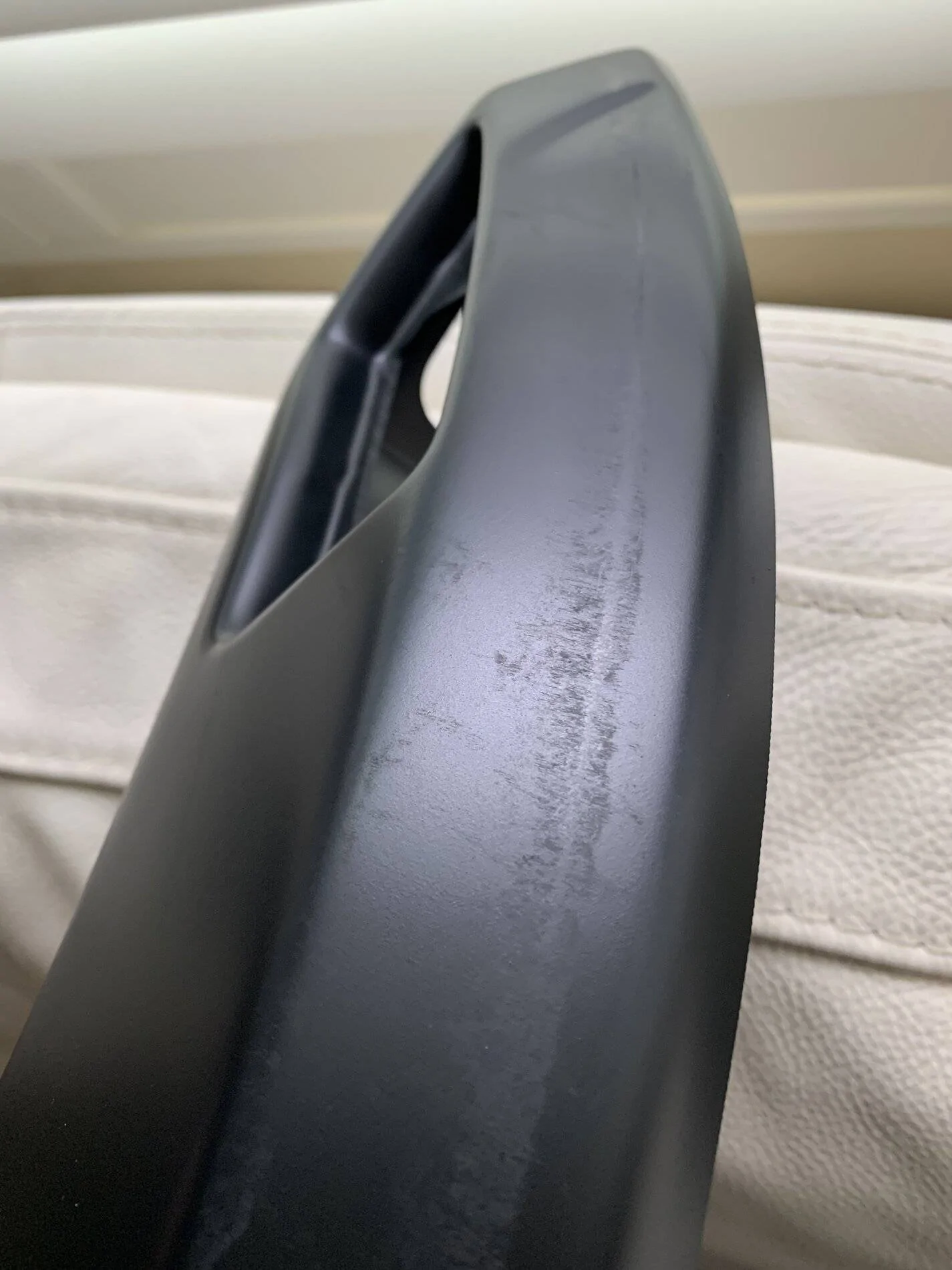

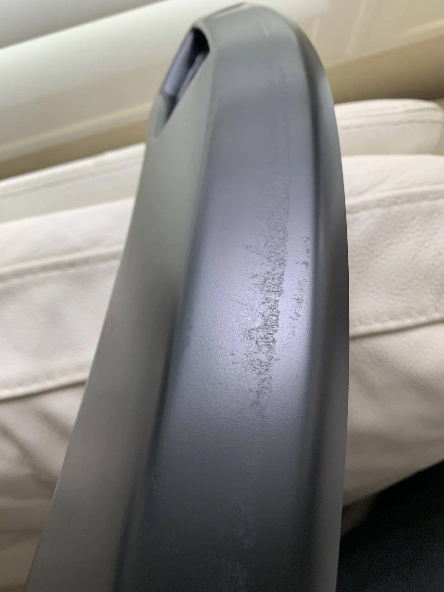

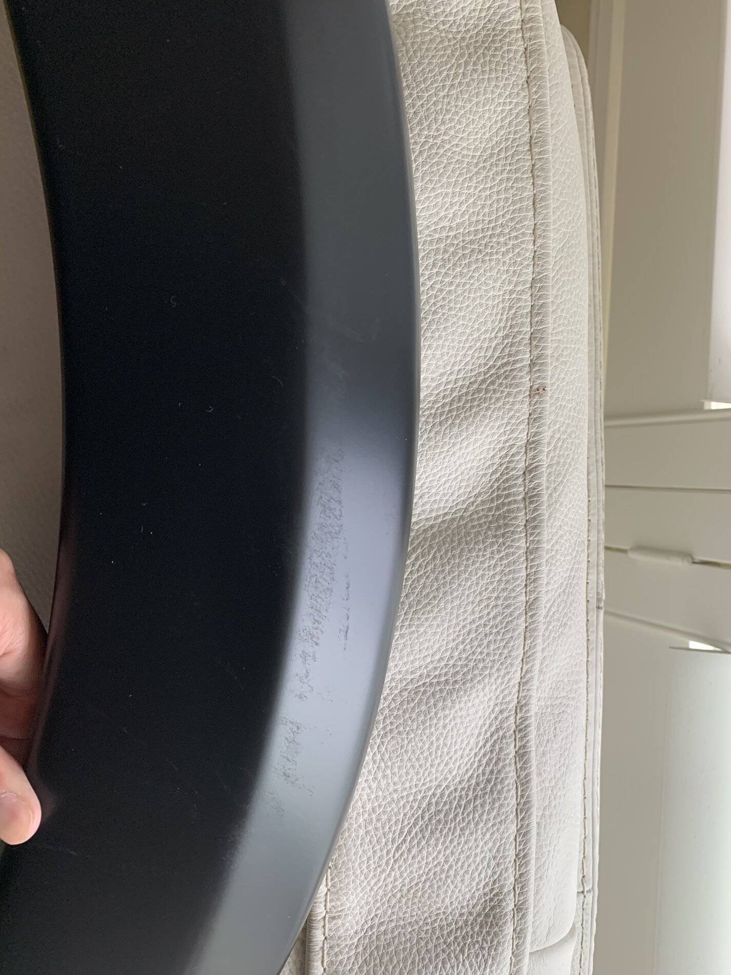

True about the backwoods hillbilly part hah. I threw plasti dip on them for $45 and called it a day. Let them get messed up on the trails.

Thanks Terry! If I was doing a more legit paint job like your rebuilds I definitely would. However, the plasti dip fills in the micro scratches perfectly, I do nice light coats so little specks fill out everything smoothly. I just rush it too much sometimes and then overspray on a certain section hahaha. I’m not the best with long processes, my impatience gets the best of me. :LOL:

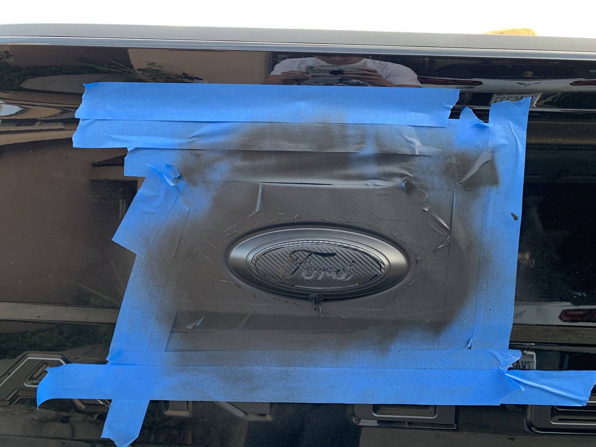

Yes however, it does take quite a bit to get a good coating to take off. About 3-4 heavier sprays, if the coating is too light it won’t all peel off because it won’t adhere to itself enough. I think it would be a bit too much work to use for an immediate purpose like you mentioned. Also the overspray can be annoying, I would recommend masking tape + drape plastic or newspaper to avoid getting it on anything you don’t want to. For instance like doing an emblem directly on the truck, tape off and cover all sides of it. Little spots of spray will rub off but it takes more effort than you need to be doing. Something like this is what I mean.
