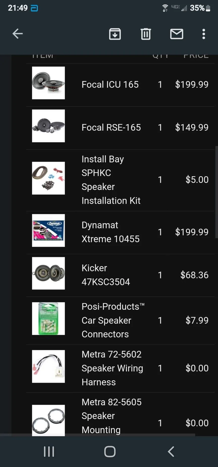

I am In the process today of sound deadening all my doors and back of the cab and swapping all speakers except for the sub, I have plenty of bass with oem sub.
I am attaching a screenshot of my order page off Crutchfield. The only drawback is the Kicker coax center channel speakers are only sold in pairs so I plan to sell the extra along with the oem B&O speakers.
I think we have an amp for the stereo under the console, still researching. If so and if it's under 25 watts per channel X4 then I will swap it for an Alpine ktp 445-u. I added one to my oem base f150 stereo when I upgraded those speakers and it helped a lot.

Good looking cart there. I am on the verge of doing something similar on my non-B&O 8” but with an Amp/DSP. I still need to figure out the sub but all in due time.

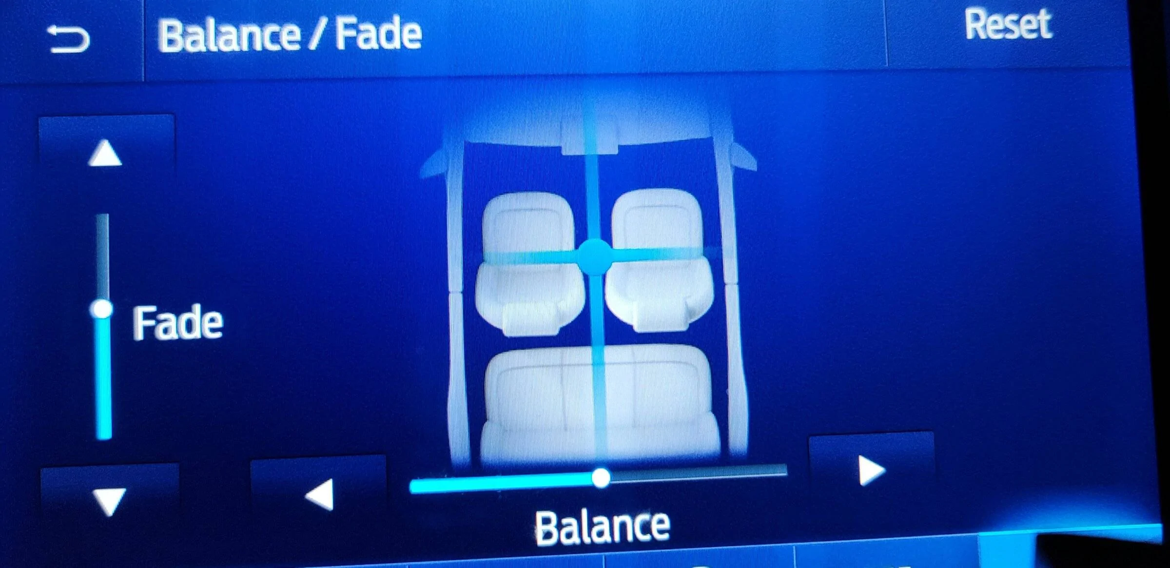

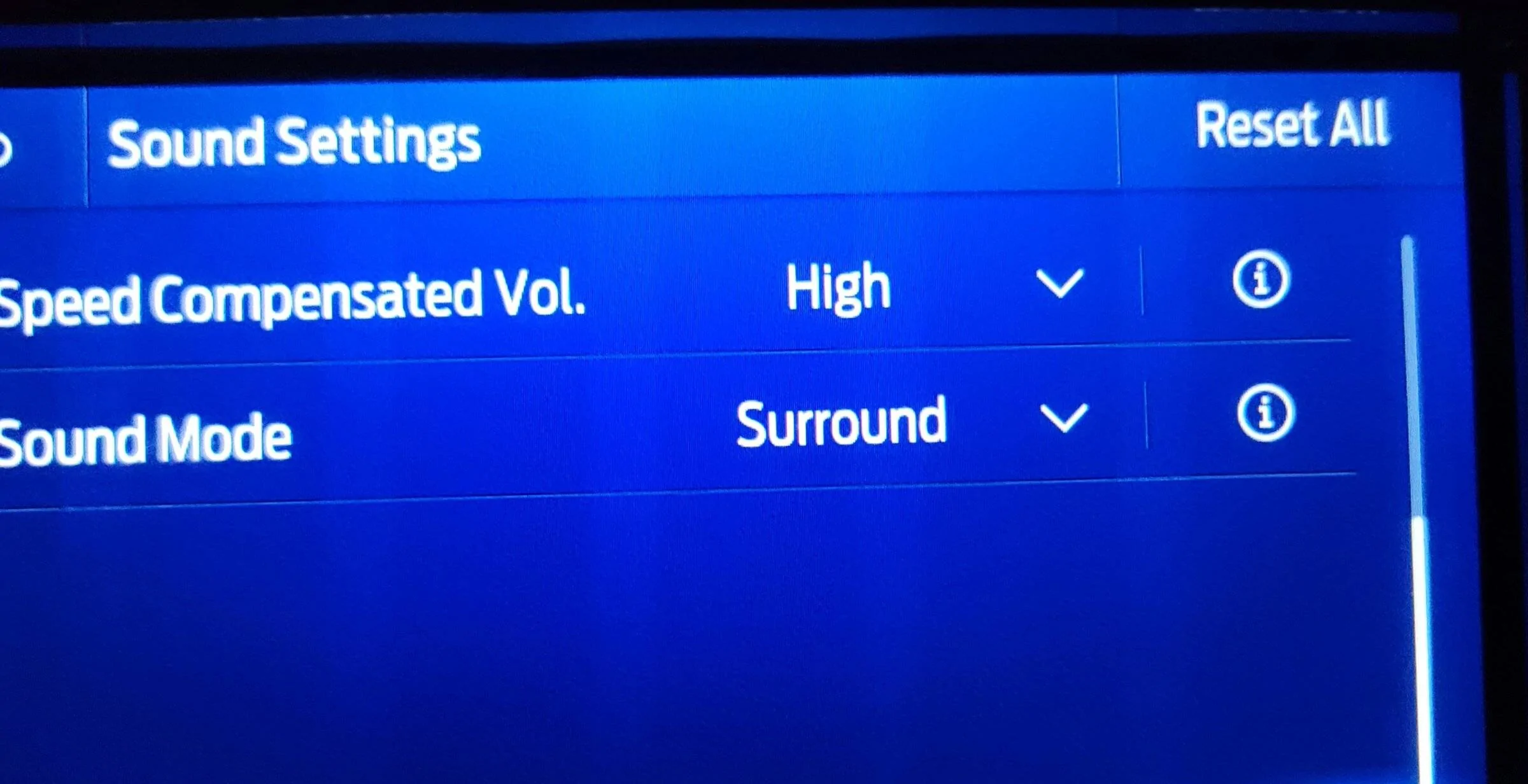

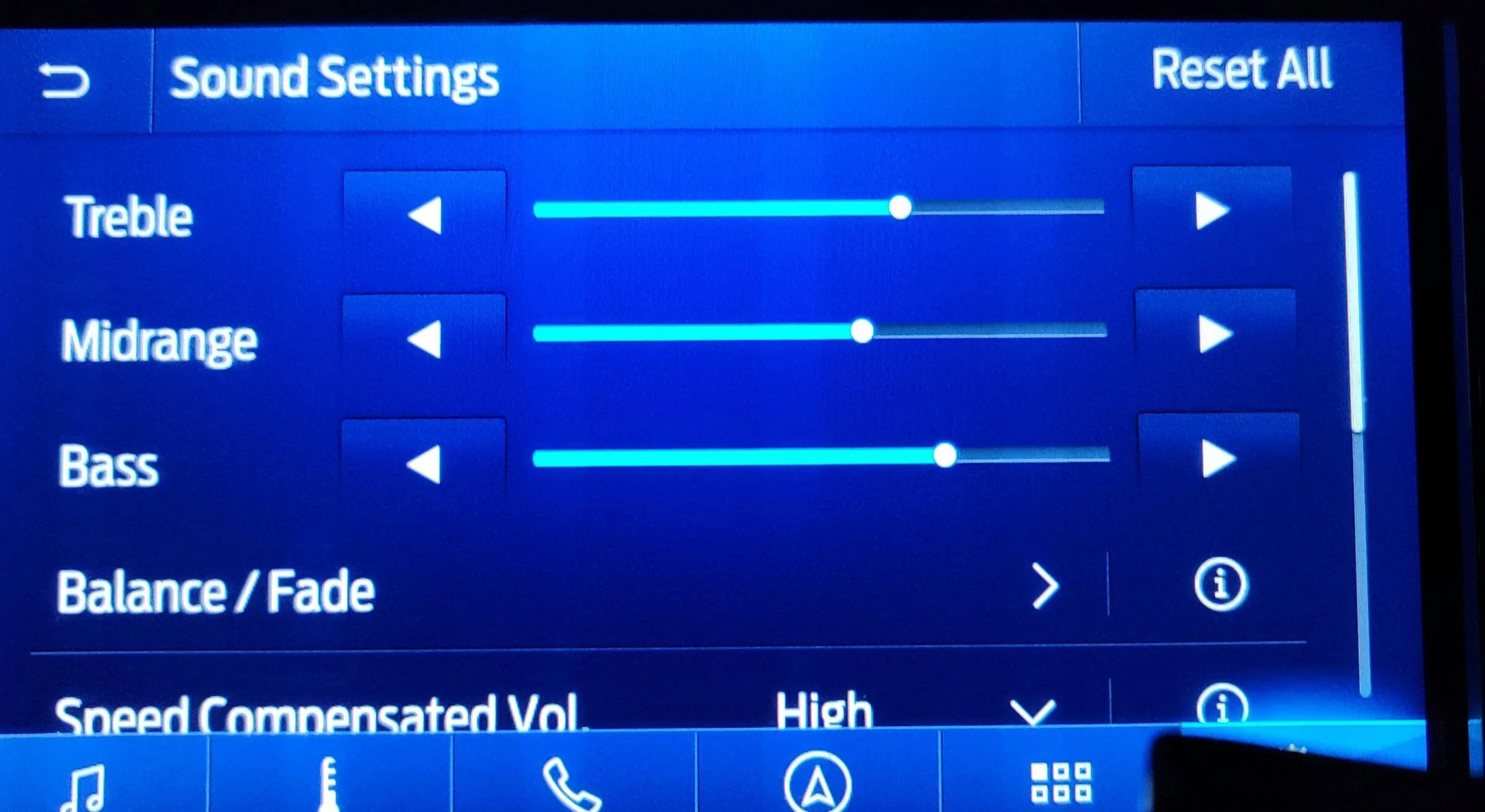

Well all we can say is we love the new sound! Took a road trip to Purdue for my stepson's graduation Saturday, a 90 minute or so ride both ways. The new speakers and sound deadening worked flawlessly. I put a double layer (inner and outer skins) on all 4 doors plus added an approximately 4x6x 2" semi rigid foam stuck right behind each door speaker. I would've used egg crate foam but wasn't about to buy a large quantity for my needs. I had this stuff on hand as leftover from a prior project (I stuck it to the garage door around a hinge that was going to hit my wife's liftgate on her new ride.) I set the fader to a spot near the seatbelt (front seats) and adjusted the bass, midrange and treble to the settings in the attached picture. We also DEFINITELY liked the sound quality better with the truck set on surround VS stereo, leaving all other settings the same and switched back and forth. Surround setting really made that dash coax Kicker speaker shine.
