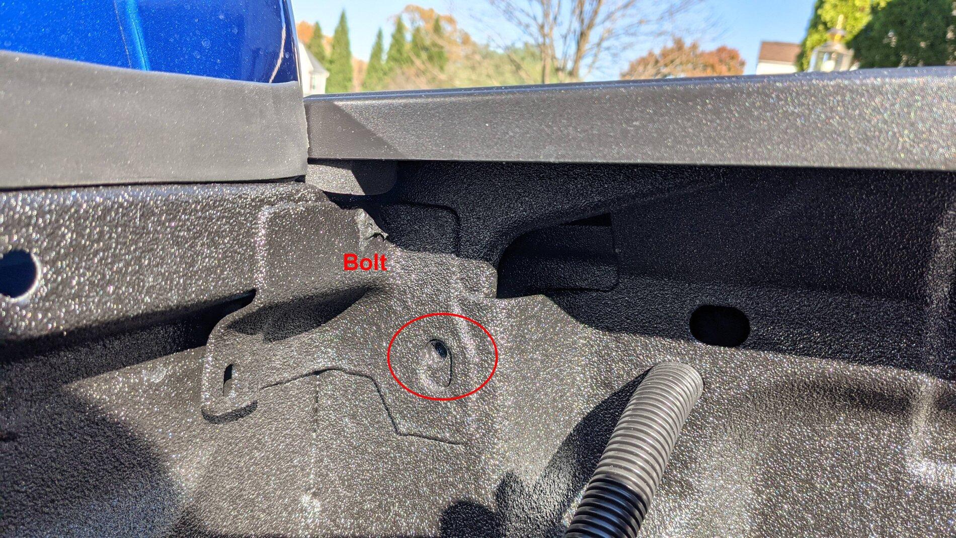

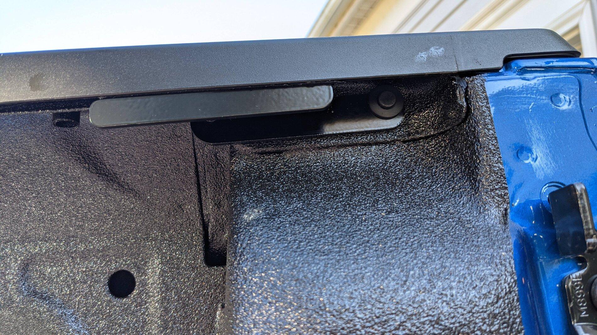

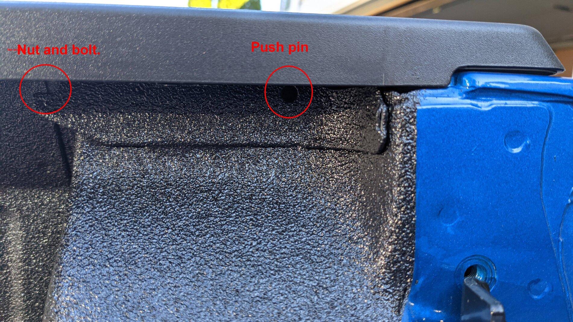

Al_S
Al
Oct 21, 2020
Virginia
2020 Ranger Lariat
This was my first tonneau cover installation. Hope these pointers help with the Extang Xceed.
  1. There is a thicker bulkhead seal in a Ranger bag. Use this, not the thinner one included with the general hardware.
  2. The Ford Ranger brackets need to be installed next. Since my installation sheet photos were unusable, I have some photos below.
  3. Now you can follow the installation guide.
I had to make some larger adjustments to get the driver's side latch to catch. Fits well and looks nice. Not having a cover before, the handle latch instead of a wire had some appeal. The second and third panels open with a wire. I don't think the wire is really any worse than the handle.
Next up is sealing the tailgate and finding how watertight everything is.

darquid
Jan 5, 2021
Springfield, VA
2020 Ford Ranger XLT
I just purchased this same cover and installed it today. I’m noticing there is NOT a lot of wiggle room for the latches at the tailgate to grab onto the rail. Is that what you meant by “larger adjustments”?
the instructions state how to move the latches out a bit and I tried that, but it really looks like I have to tap new holes in order to get enough room for the latches to grab onto.
also the push pins for the brackets by the tailgate weren’t included in my box, so I’ll be calling Extang on Monday for those.
