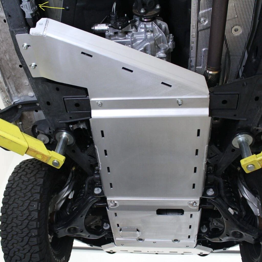

Doesn't the rc skidplate for the transmission happen to cover that area? If you have the money to burn, could be worth looking into.
It doesn’t. It’s back behind the transfer case skid plate. See picture, upper left area. The Ford transfer case skid plate is also in the same general area but also doesn’t cover it . What ever would have to be added could use the transfer case skid bolts to secure the front of it. And then go back about a foot.

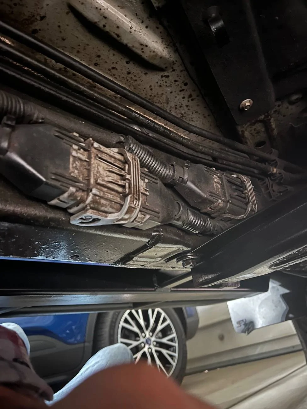

Thanks but we’re talking large sticks, logs and rocks mashing up in there. Actually breaking the connector. The two instances I know of were large sticks kicked up on trails.
https://www.ranger5g.com/forum/threads/cel-p2418.31525/
It that is the case. build a skid plate. bolt it to the frame rail and box the connector in. But follow Grumpaw's advice on the contact cleaner and dielectric grease. I prefer DeoxIT D5 followed by DeoxIT Gold G5 for contact cleaner.
Aye, To be frank the plates might not cover it directly but should definitely provide protection save for the off chance a stick or something suddenly learns how to aim.
I'm willing to bet a simple flat stock metal panel bent into an L shape would be all one needs.

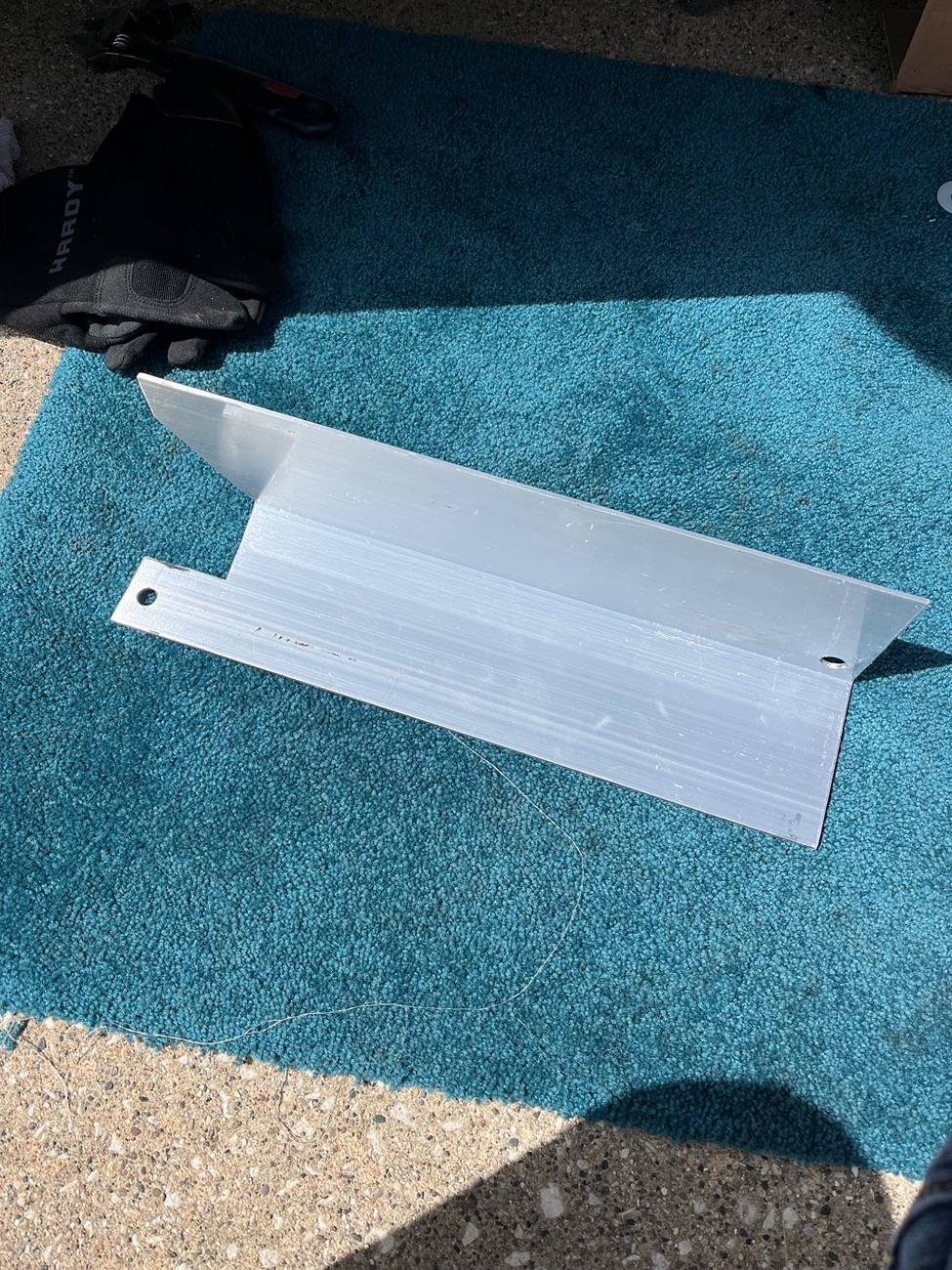

One of the known failures had the skid plates setup in the picture. And it got nailed by a stick. I’ve got a piece of 4x4 aluminum angle coming and will use the transfer case skid bolts and one of my rock slider mounting bolts to secure it. Should be enough ?

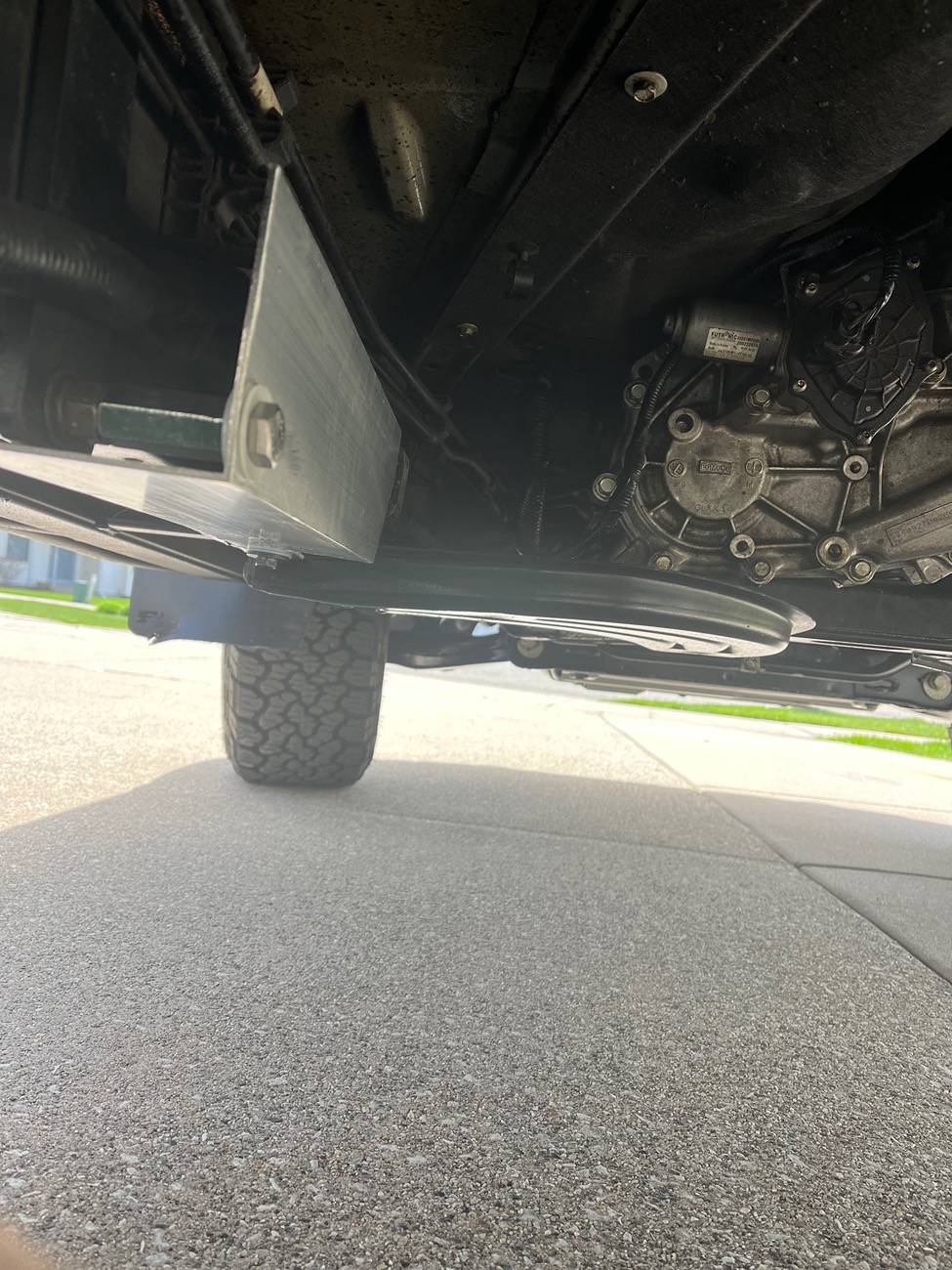

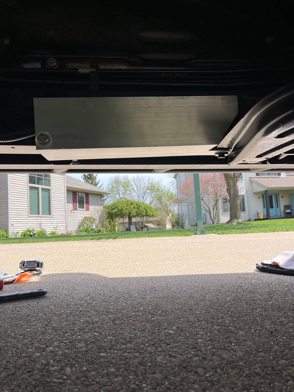

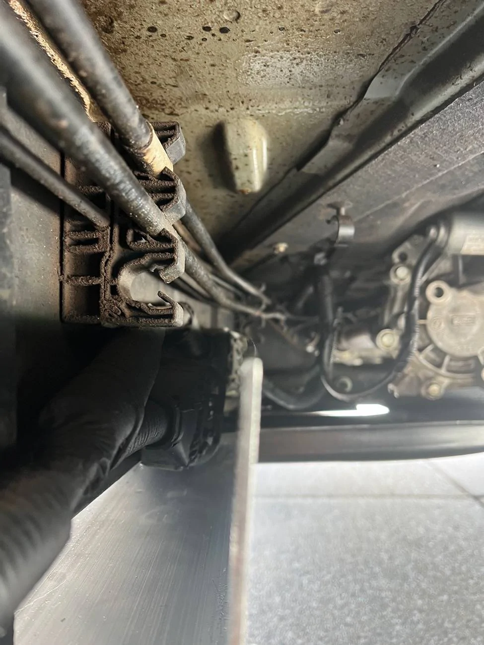

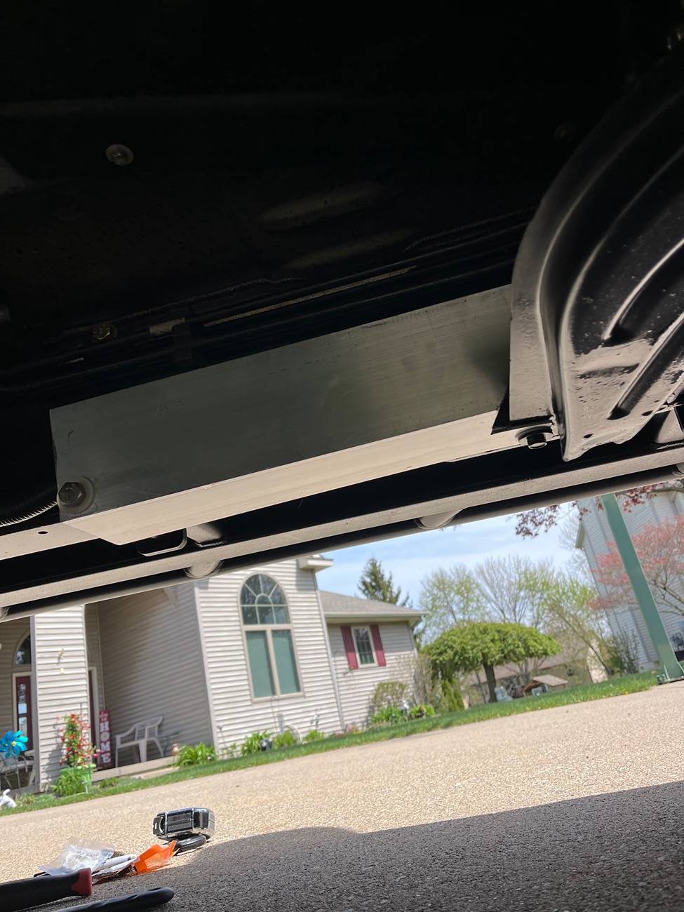

Resolved(hopefully)
I used a piece of 4x4x1/8 aluminum angle to make a shield to protect the connector area. I used one of the transfer case shield bolts and one of my rock slider mounting bolts to secure it. Should do the job ?
