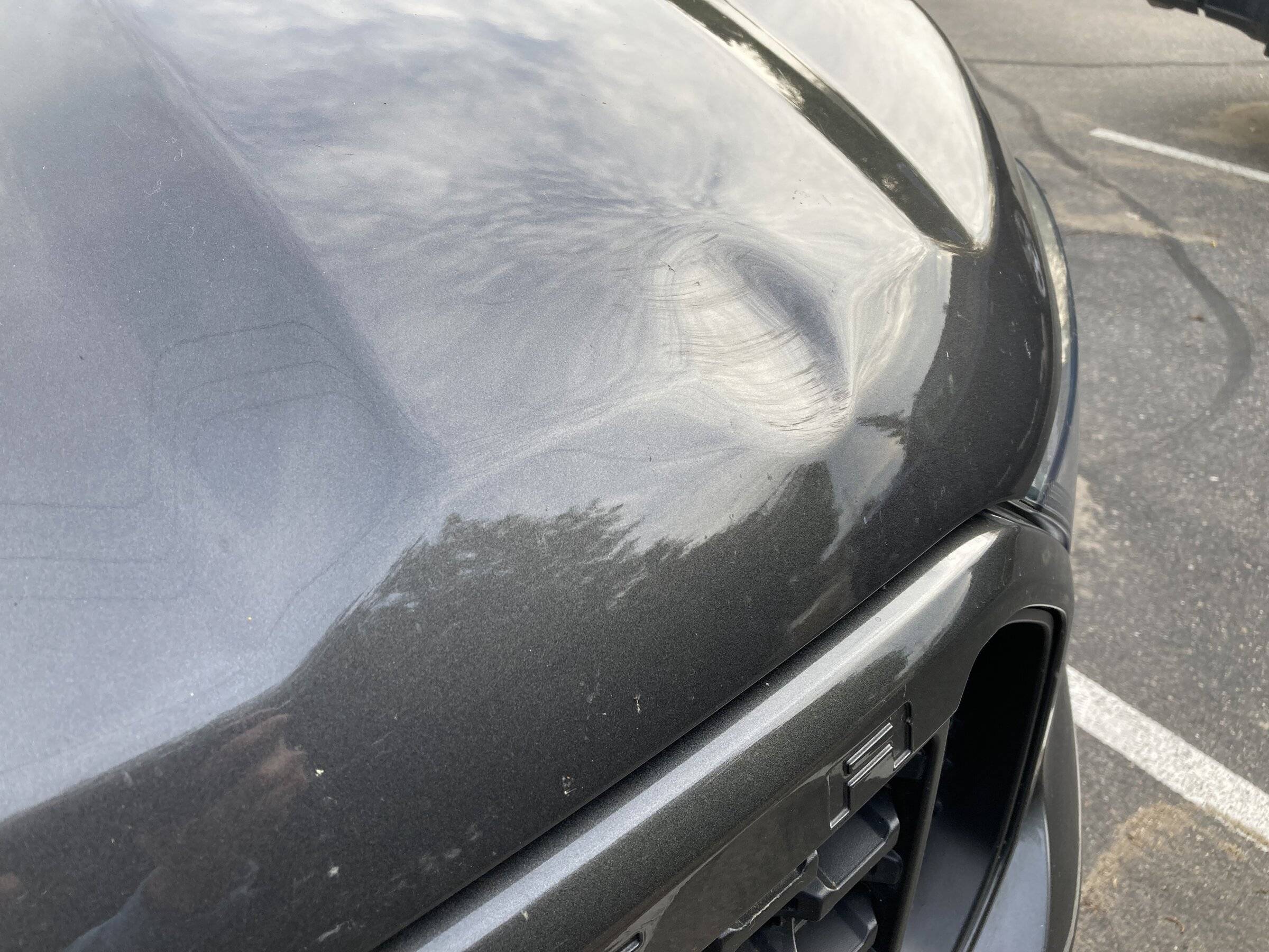

Dent from broken tree branch. Paintless Dent Removal quotes all over the board. $75 to $250. Most said since it is on the curve of the hood, may still be slightly noticeable. There are some do it yourself videos on YouTube. PDR Kits run about $60. Might just install a bug deflector to hide. FYI, all asked if the hood was aluminum, said pulling dents out of aluminum is tougher that steel.

As @AzScorpion mentioned, I did pay a slight premium being in a rat race city but if it's truly a small small ding on the door, it really should be around $100 or less as others stated with PDR. And yes, aluminum is tougher than steel to work with in terms of PDR, it also can't be over bent one way or another. Sometimes the pricing depends how easily they can access the backside to do the PDR work. Best of luck, hope this gives an idea roughly. I also have seen some PDR guys do the repairs without the straight line light beam(whatever this is called in the industry) it basically reflects light to make sure all dents are evenly knocked out. So I guess different prices could have it with or without.

Most places in this area start around $75 for most door dimples and give slight discounts if there are more than one that they can get in one sitting . That looks more like a $250 repair . As mentioned , aluminum doesn't have the memory that steel has so it has to be worked out and takes longer . Aluminum stretches more where steel wants to pop back out more easily .
