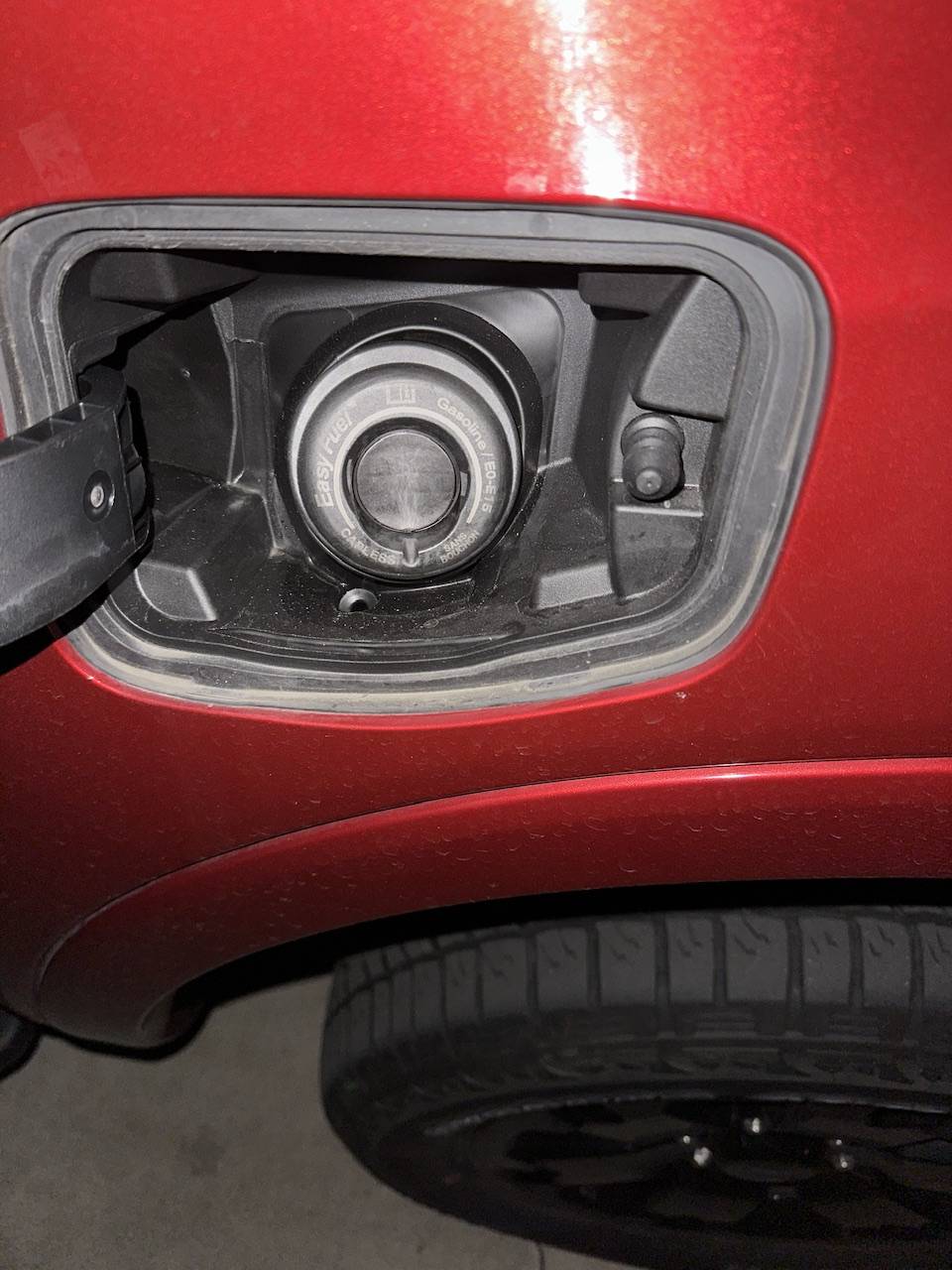

Does your gas tank pipe look like this?
TheAssuager
TheAssuager
Sep 23, 2022
106
415
2020 Supercrew XLT
Mine is as I recalled in my earlier post. No concerns on my end.
However, @RedDakooter05 has definitely set the bar when it comes to detailing the filler door, compartment and cap.
Interesting - the boot seems to still be connected on yours. Strange!

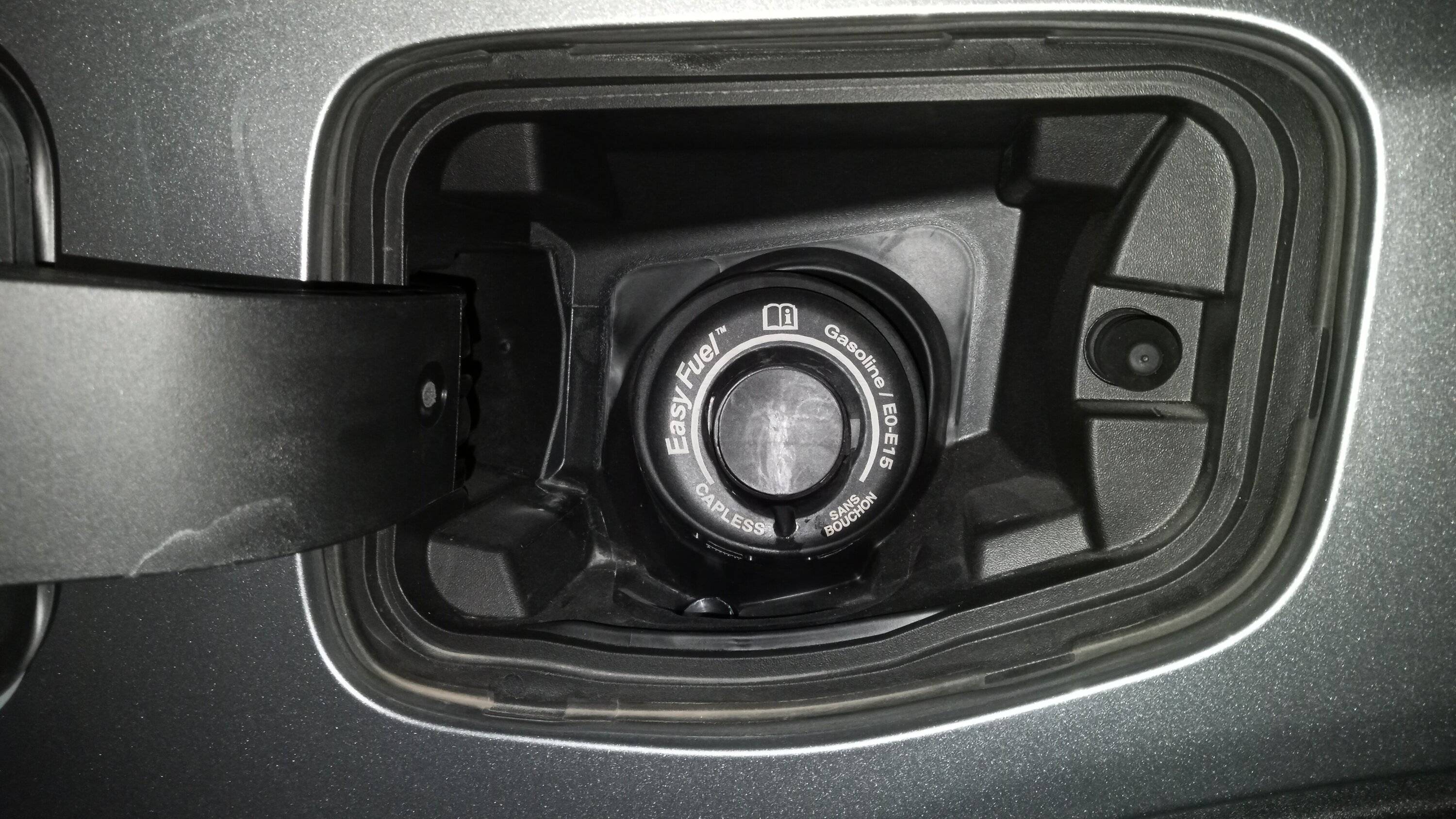

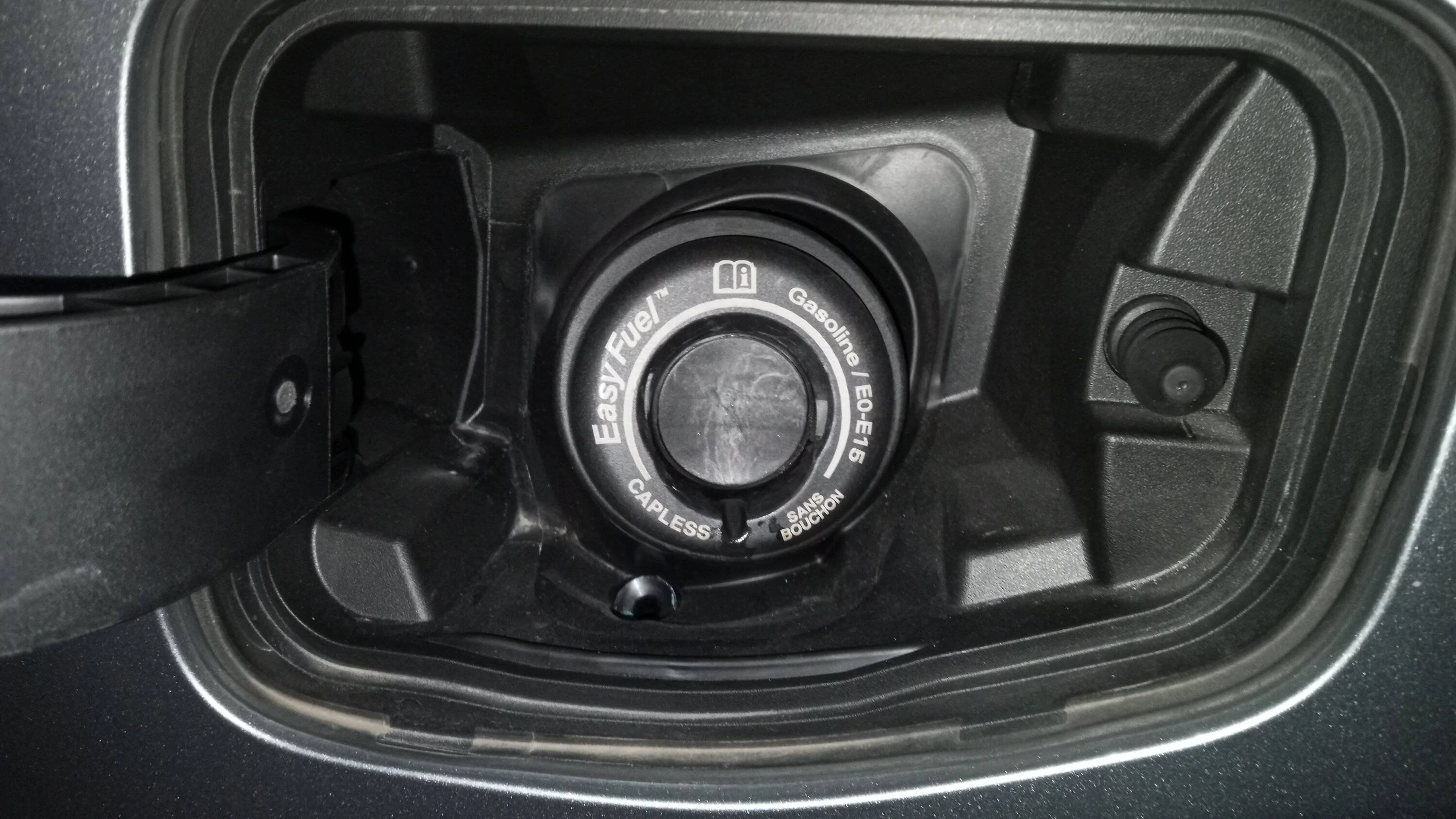

Another perspective
So who holds the pump handle and who lets it hang? Maybe if it hangs it comes loose.
I hold the pump handle.
