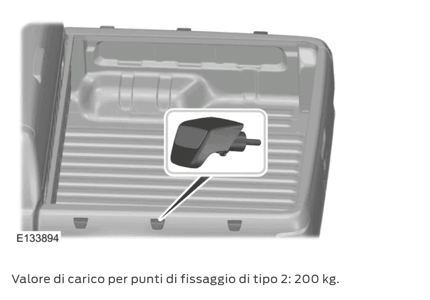

Hello,
I own a 19 XLT which comes with these external anchor points (ford rates them for 200kg cargo each):
Is it a good idea to remove them and use the screw holes to create an over the bed rack?
I didn't find anything similar done before but maybe here somebody has experience.
Thanks!

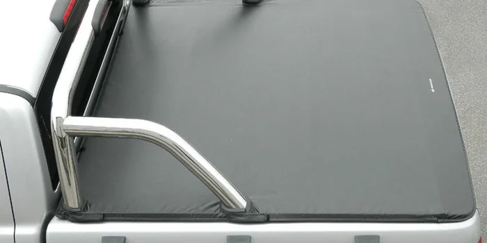

Thanks for your reply.
At the moment I have a soft cover which I want to keep (when rolled up it takes no space and I can load a full sized pallet).
I found multiple solutions on the market for bed racks that go over tonneau covers ( for example the ones made by Front Runner) but they're for rigid ones (mountaintop etc).
Instead creating a structure that's anchored outside will allow me to have both the rack and the soft lid together.
I don't need a lot of cargo on the rack, as I plan to install only the front runner roof top tent which currently is on load bars over my cabin (45/50 kg).
Do you think 200 kg of load for each anchor won't hold the weight of a tent plus 2 adults ? Dynamic load would be low, static would be around 250 kg including the rack more or less

Hi Schultzit,
The strength of the box side wall in where the tie down clips are is not the strongest place for a support structure as you desire. The strength of the pickup box is in the top rail and should be considered in my opinion. Your RTT will have a dynamic component to it for every bump in the road and I don't think you want the sidewall in shear...it is not designed for that kind of load. JMO
