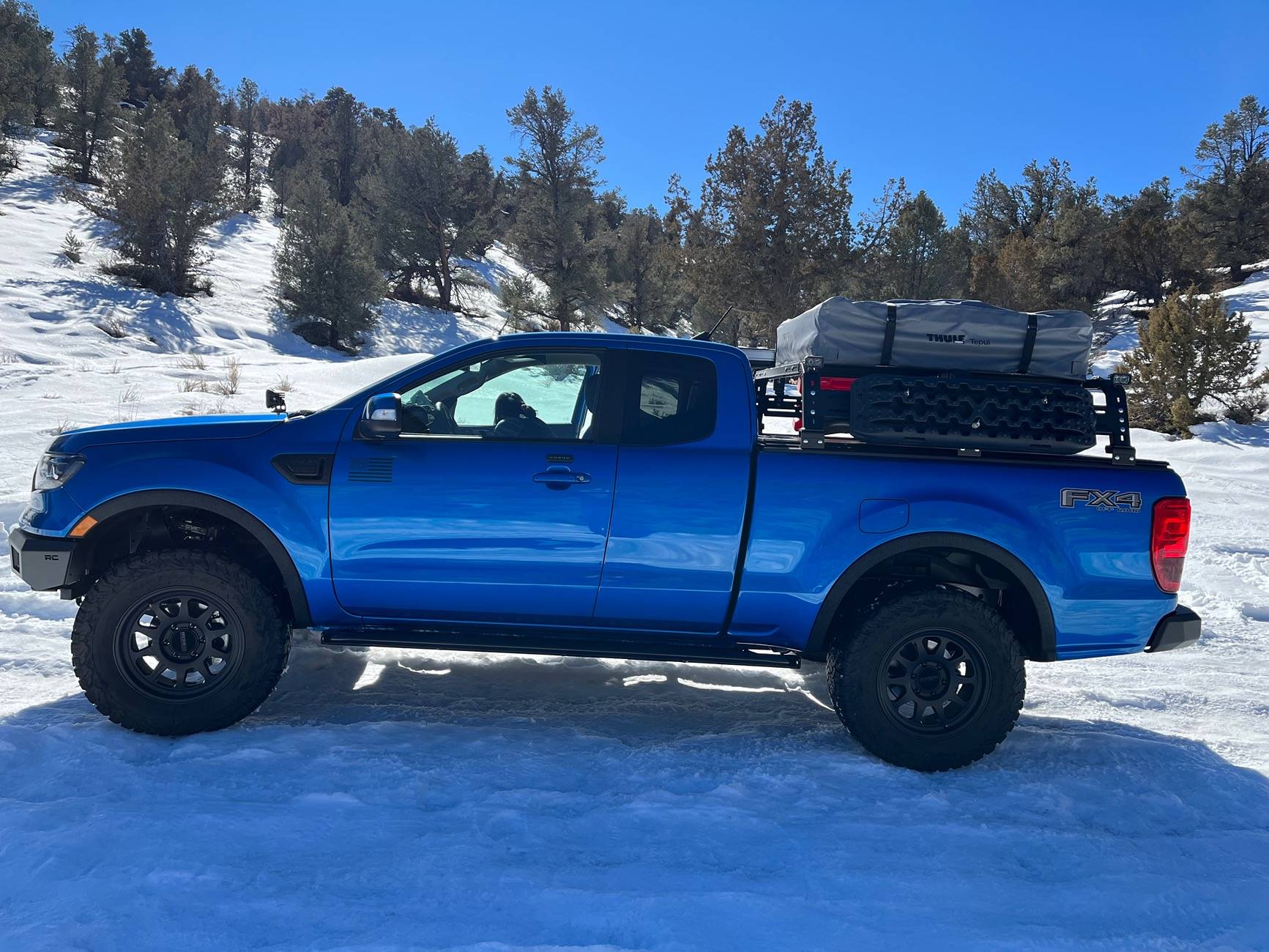

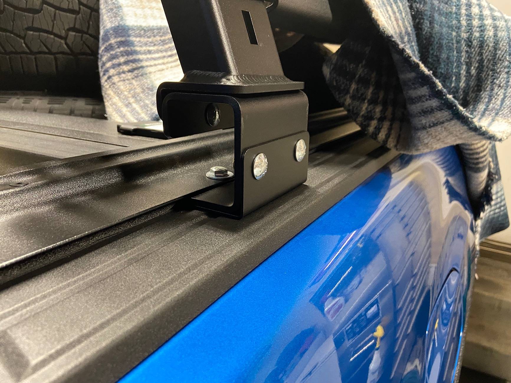

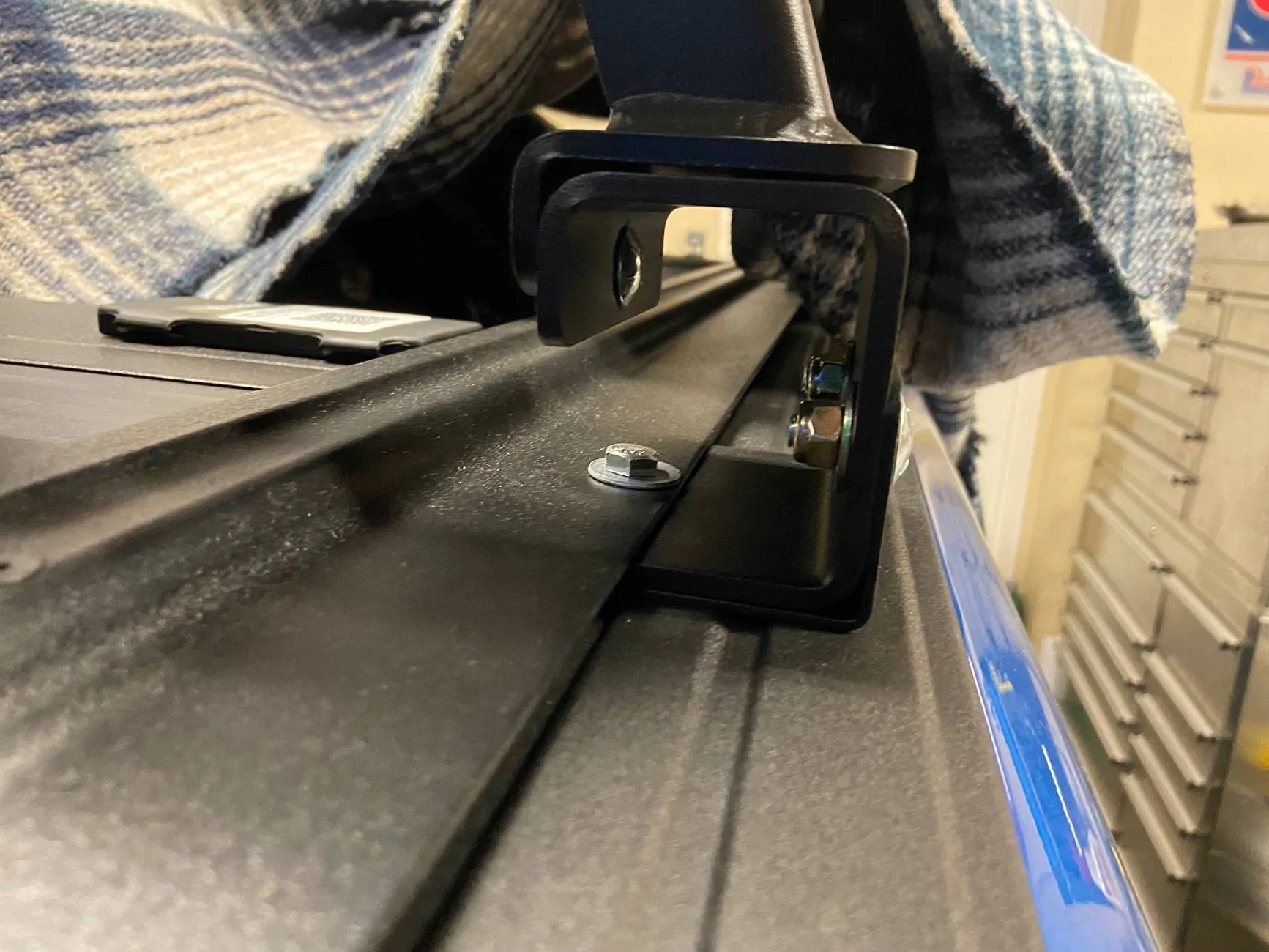

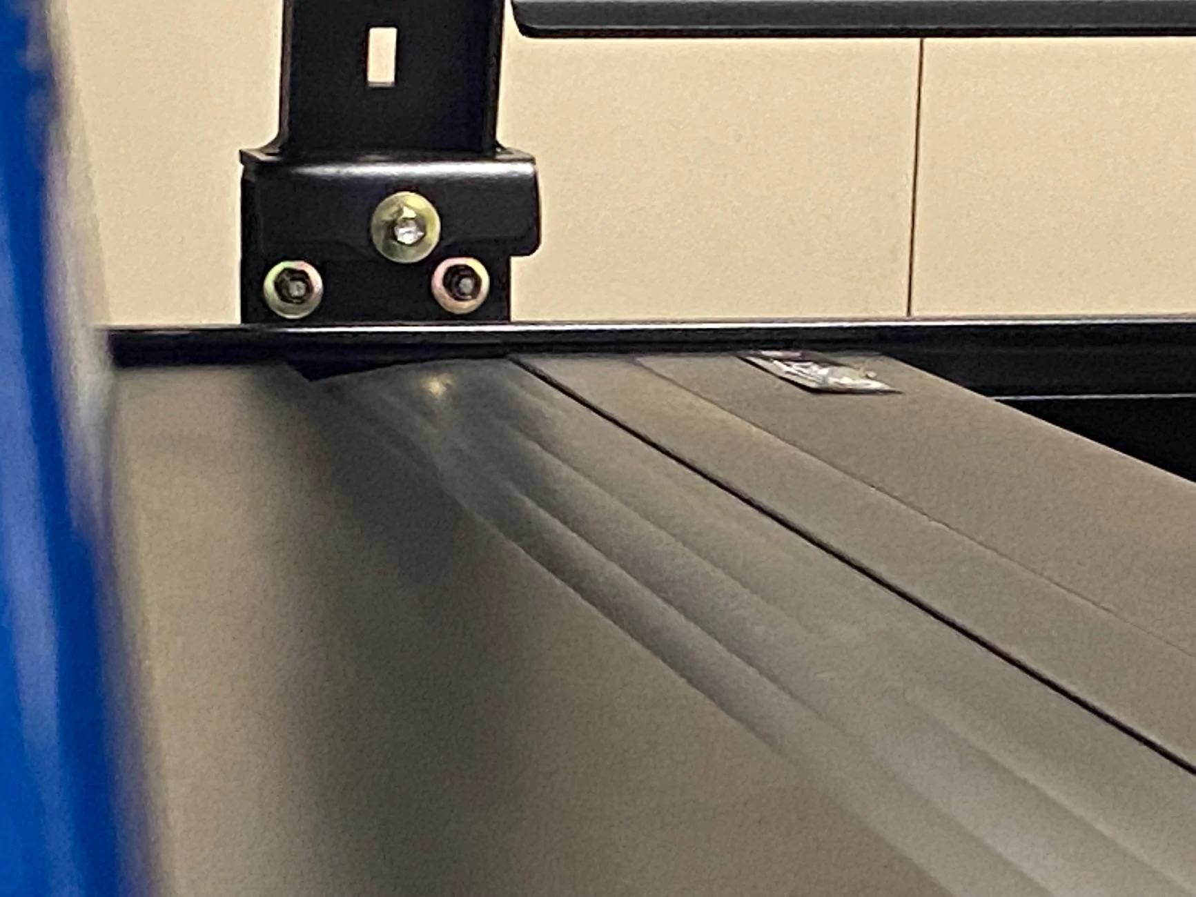

I have the 12” RCI aluminum bed rack with adapters for use with a tonneau cover. Really happy with the product. I like that it has 3 cross supports so 6 mounting points. I drilled and bolted mine did not feel secure enough with just clamps. Using it with a Retrax rollup cover.
Edit did not catch that you had a folding cover that will make it a lot harder to find a rack that will fit. RCI has a taller one, but might still be an issue. Check their site or contact them they are really good with customer support.
