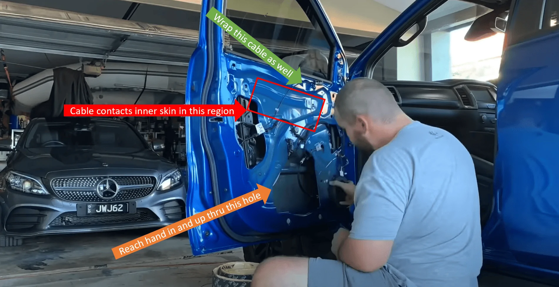

I had this same problem on my 2019 Lariat w/ B&O audio. My driver's side door had a buzz which sounded like it was originating somewhere behind the top 1/3rd of the door card. The noise was associated with a very narrow bass frequency range, and would go away if I pulled on the door grab handle. Initially, my truck sounded great, and the buzz showed up a few months into ownership, after I had already taken the door apart once to install sound deadening.
The problem was not the speaker at all. There are mechanical control cables for the door locks and latches and the window lift and lower system that are routed between the outer door skin and the inner door skin. On my truck, on the driver's side, these control cables were run very, very close to the inner door skin -- they would *just* kiss the inner skin when the bass was shaking the inner skin and the control cables, which would cause the buzzing noise.
I found and solved the problem as follows. The work is blind as you can't see the areas where the cables contact the inner skin, but feel around and it should be fairly clear what needs to happen.
  • Take off the interior door panel. Here is a good guide.
  • With the heel or butt of your hand, gently and rhythmically strike the inner door skin. You should be able to hear roughly where the cables are buzzing against the inner door skin
  • Reach into the space between the inner and outer door skins through the center/bottom cutout in the inner skin
  • Guide your hand upward and feel around for control cables. On my truck, there was a point where two cables crossed each other; this was the region where the cable(s) were close to the inner door skin. I've indicated this region in the image below with a red box.
  • Once you have found the region where the cables are closest to the door skin, apply some self-adhesive foam rubber cushioning strip to the door skin in this region, between the cables and the inner skin, and also wrap the two cables themselves. You just want to apply a soft treatment to the surfaces where the cables may buzz against the inner skin.
  • I also applied foam rubber tape to the control cable that runs between the door card and the inner skin as it appears to run very close to the skin as well. I've indicated the cable in the image below with a green arrow.
  • Reassemble the door and door interior panel, but before you button it all up, let the bass bump! You should be able to tell immediately whether or not the problem has been fixed or if you'll have to go back in and add more cushioning.
This was a super irritating issue and took me a while to find and fix, I had the door apart about 5 times before solving the problem. Hopefully this information is able to help someone out there!
