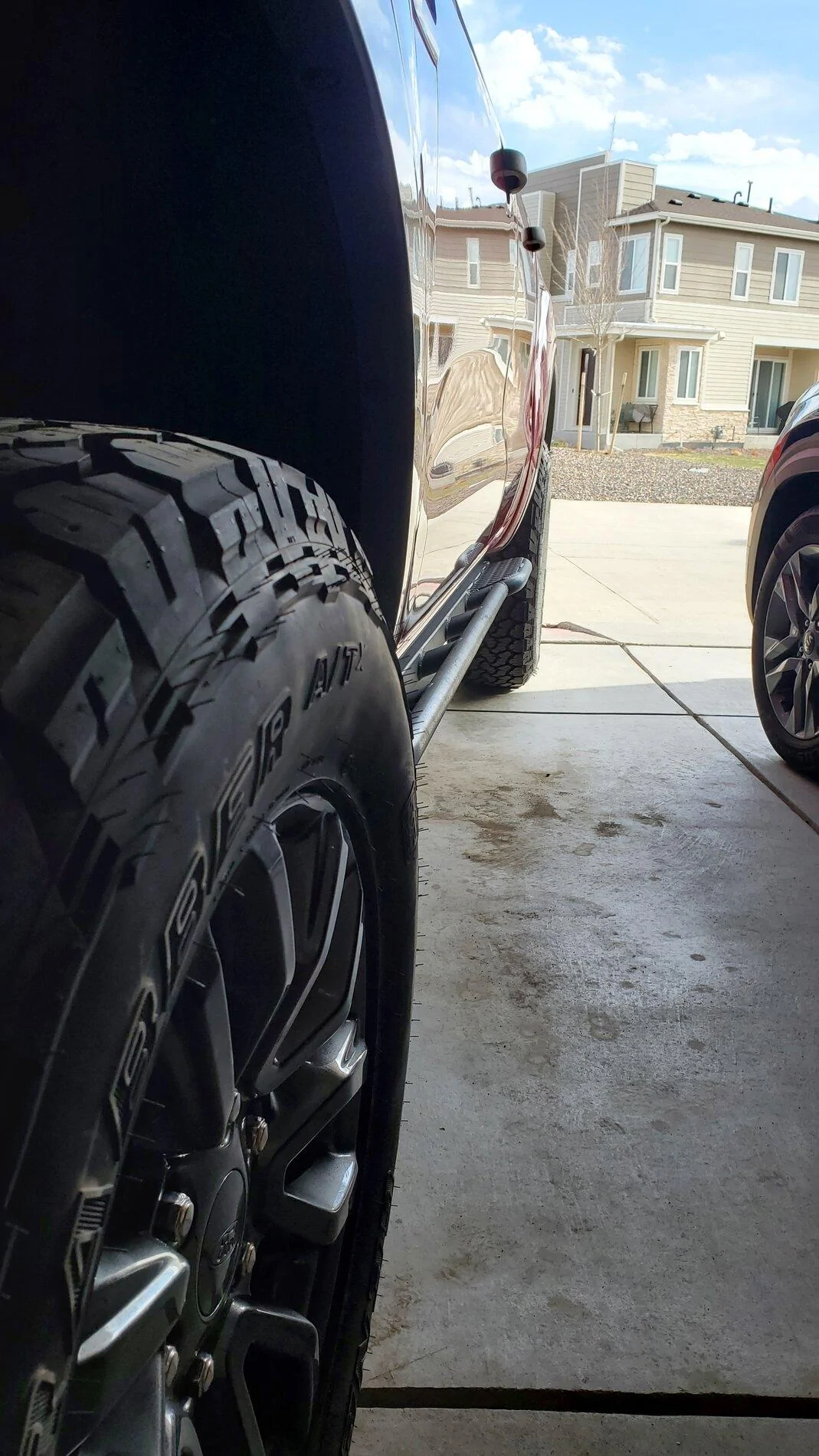

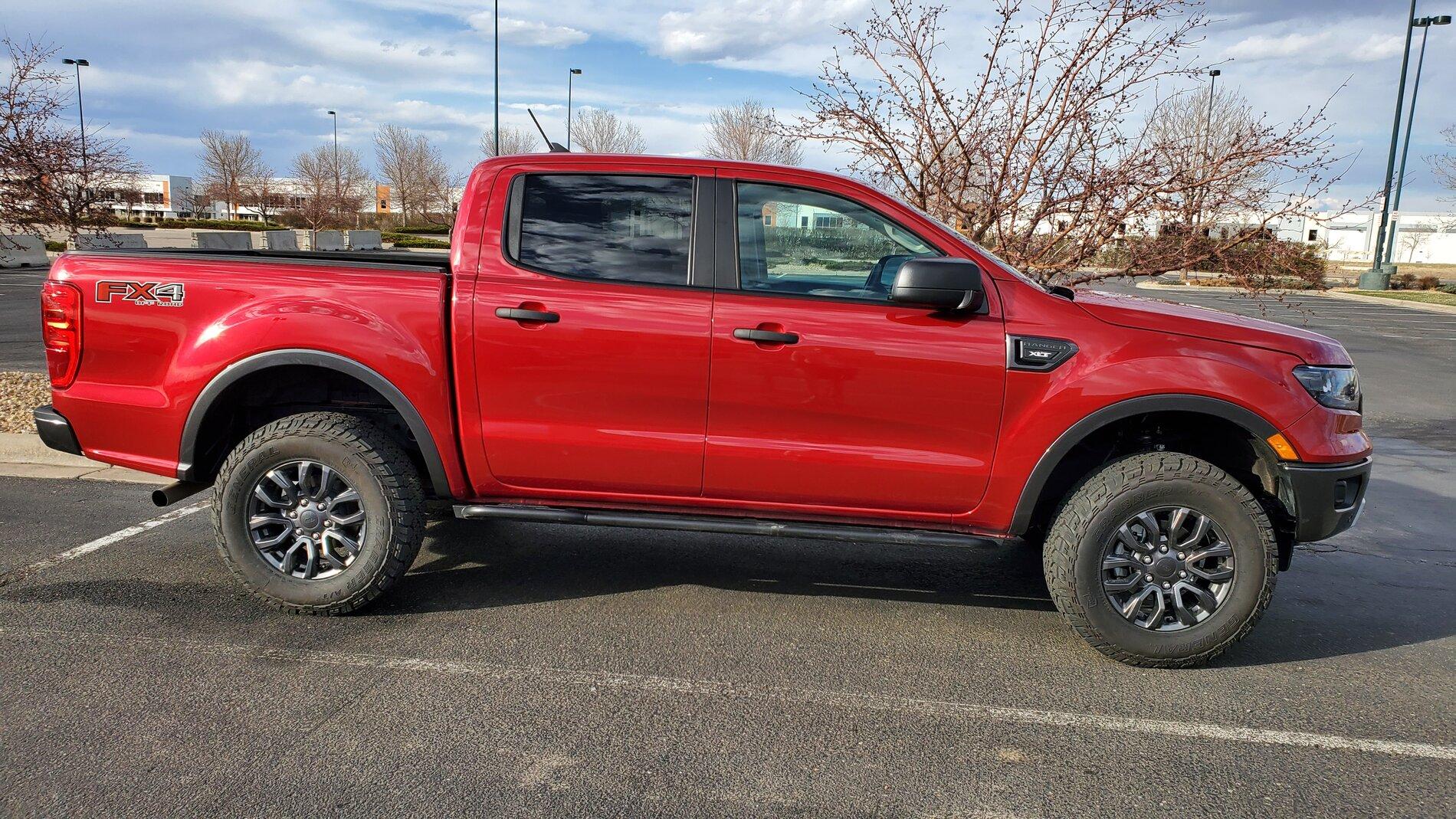

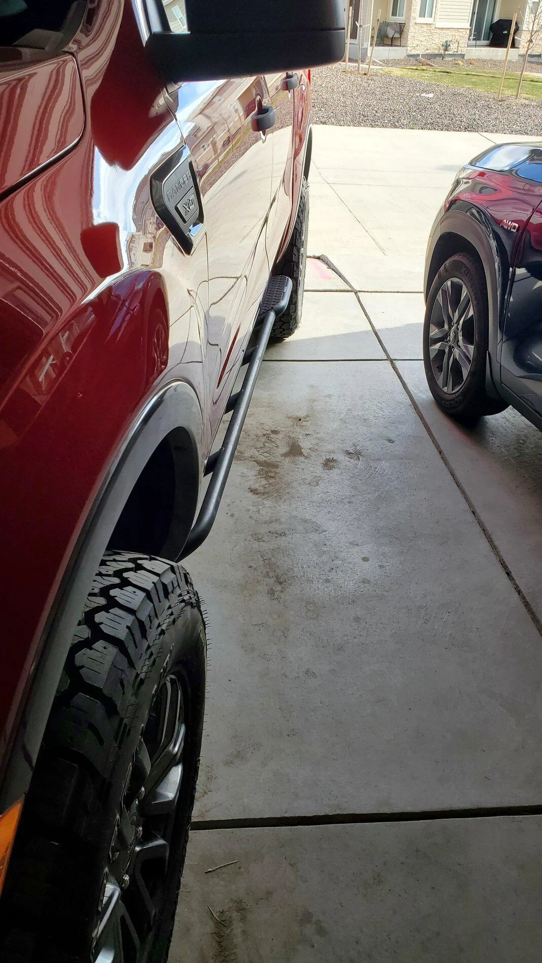

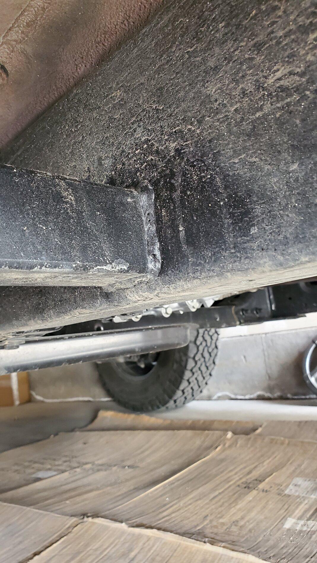

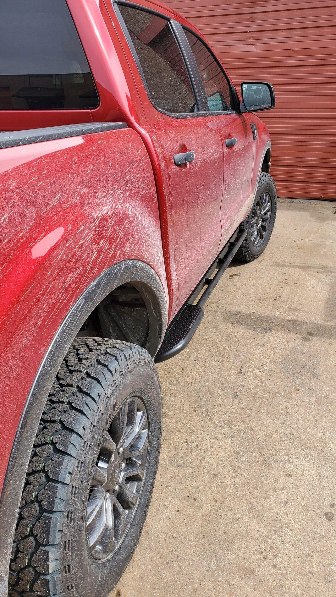

Hey everybody, got my sliders from first choice welded on last week. Saw someone on an overlanding Facebook group post about him so I figured I'd give him a shot. Haven't had a chance to test their durability yet, hopefully I will this summer once the snow melts..
Paid $650 for them. He also offers normal ones without kickout for 525 or with kickout but no diamond plate for 575. Diamond plate doesn't really serve a purpose since they're angled up 15 degrees but I like how it looks. Also inquired about getting some dimples the whole length but he said he takes them to a different guy who charges $10 each dimple and I figured that would be too much since I like the looks of smaller dimples more

I don't want to rain on your parade but the frames on our trucks are thin... like crazy thin.

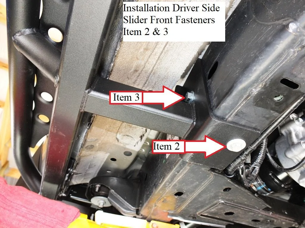

One advantage of the bolted on sliders is the brackets that attach them to the frame are heavy gauge steel and therefore distributes the load across the entire height of the frame, as well as capture the bottom of the frame, see photo below.
Welding the tubing to the center side of the frame puts all the stress into the weakest part of the frame.
Proceed with caution.

I'll keep it in mind. Not planning on doing anything super crazy, just wanted the peace of mind that I won't dent my door and/or rocker panel

Did some more research. I'll probably look into getting some additional gussets added on. Probably should've searched more beforehand so I could've asked for a 3"x3" or 4"x4" frame plate to be welded on for each mounting point as well. Appreciate the advice.
